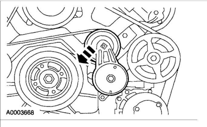

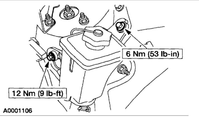

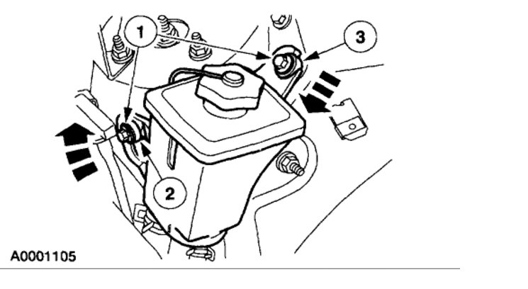

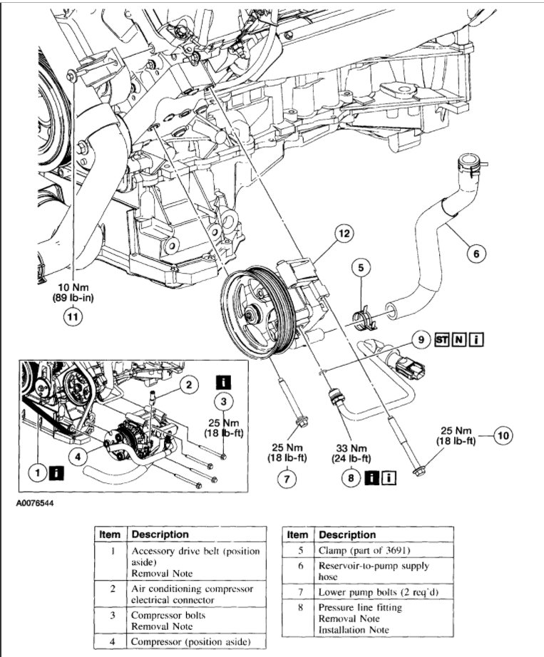

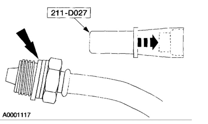

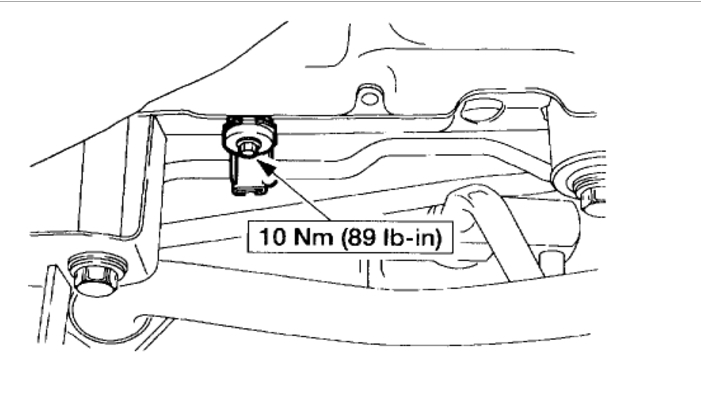

show me the power steering pump for this engine.
Aug 8, 2017 at 2:45 AM
Experienced Mechanic
55,628 POSTS
Here is a guide to help you see what you are in for when doing the job. You will need to jack the car up to do the job.
and
https://www.2carpros.com/articles/how-to-replace-a-power-steering-pump
I would do a flush before you being in you can so the new fluid goes into the new pump
https://www.2carpros.com/articles/power-steering-fluid-flush
Here are some diagrams of what it will be like on your car. (below)
