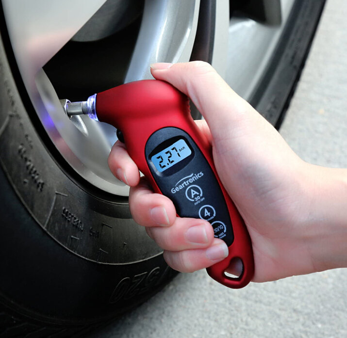

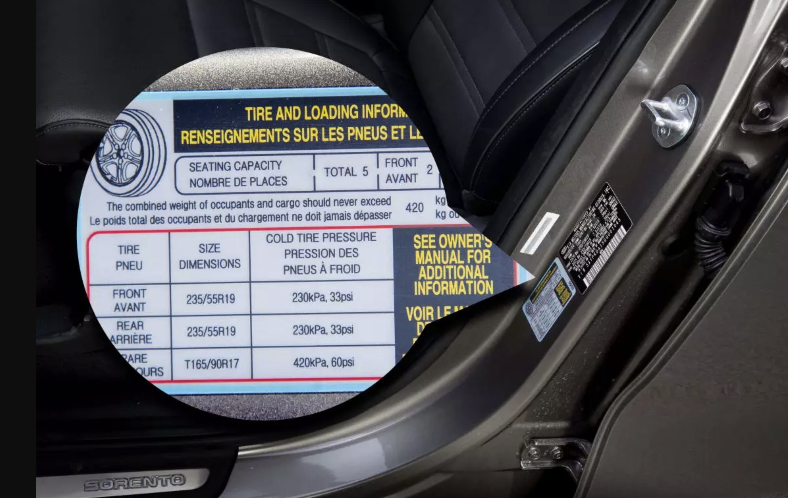

The first thing I would do is get a digital tire pressure gauge and check them before filling them and write down the readings, so we have that information.
Then fill your tires to what the label on the driver's side door says. I don't know if you have a compressor or anything. If not just go to a gas station but never trust the gauge connected to it because they are almost never accurate because people throw them around. So having your own digital pressure tester is best.
Here is one on Amazon for $13:
https://www.amazon.com/Geartronics-Pressure-Settings-Backlight-Motorcycle/dp/B077VBRH82/ref=asc_df_B077VBRH82?tag=bingshoppinga-20&linkCode=df0&hvadid=80195684681607&hvnetw=o&hvqmt=e&hvbmt=be&hvdev=c&hvlocint=&hvlocphy=&hvtargid=pla-4583795260945768&psc=1
Your local auto parts store should have one as well.
I recommended the digital gauge because it is way easier to read.

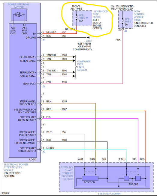

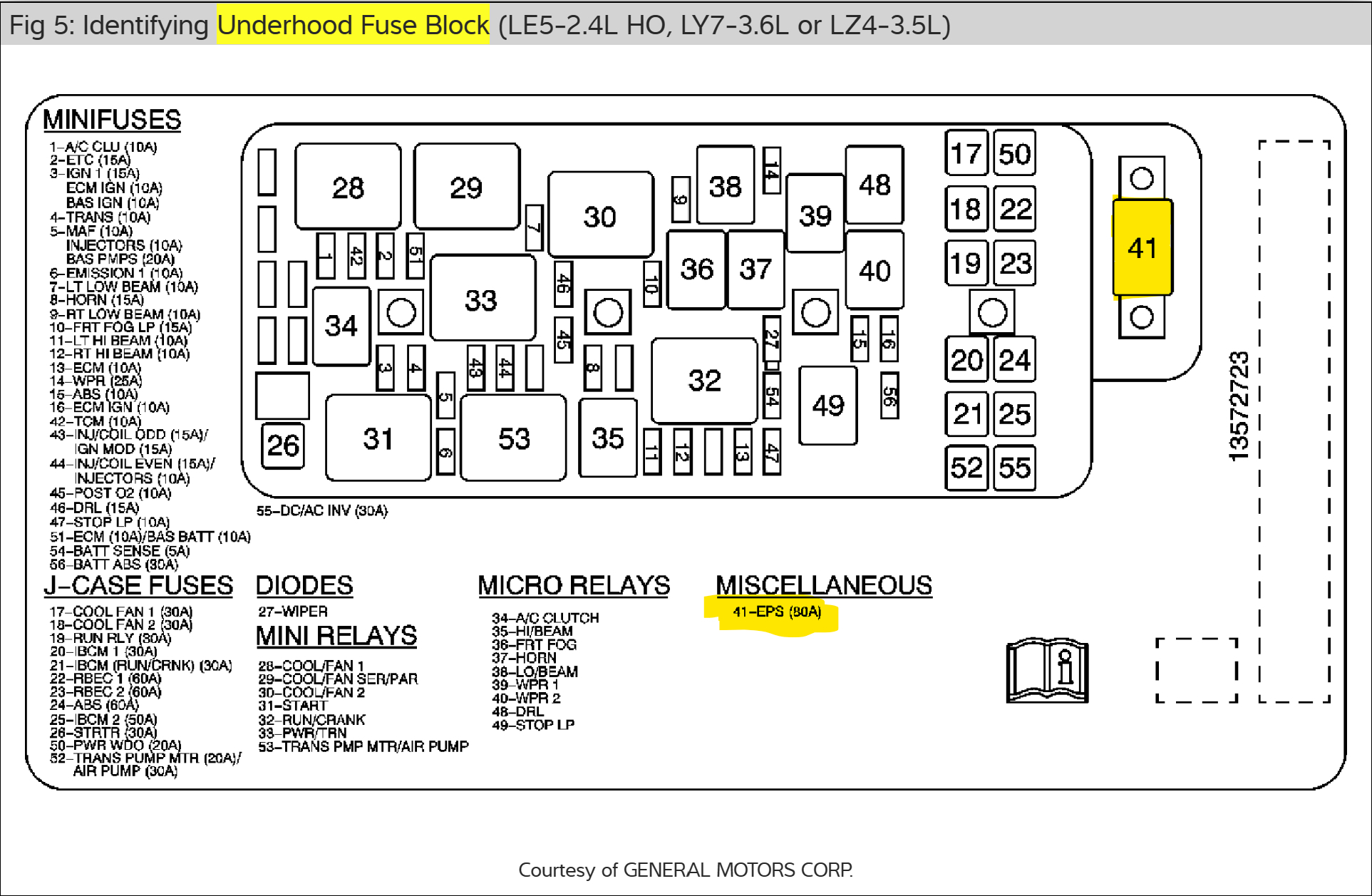

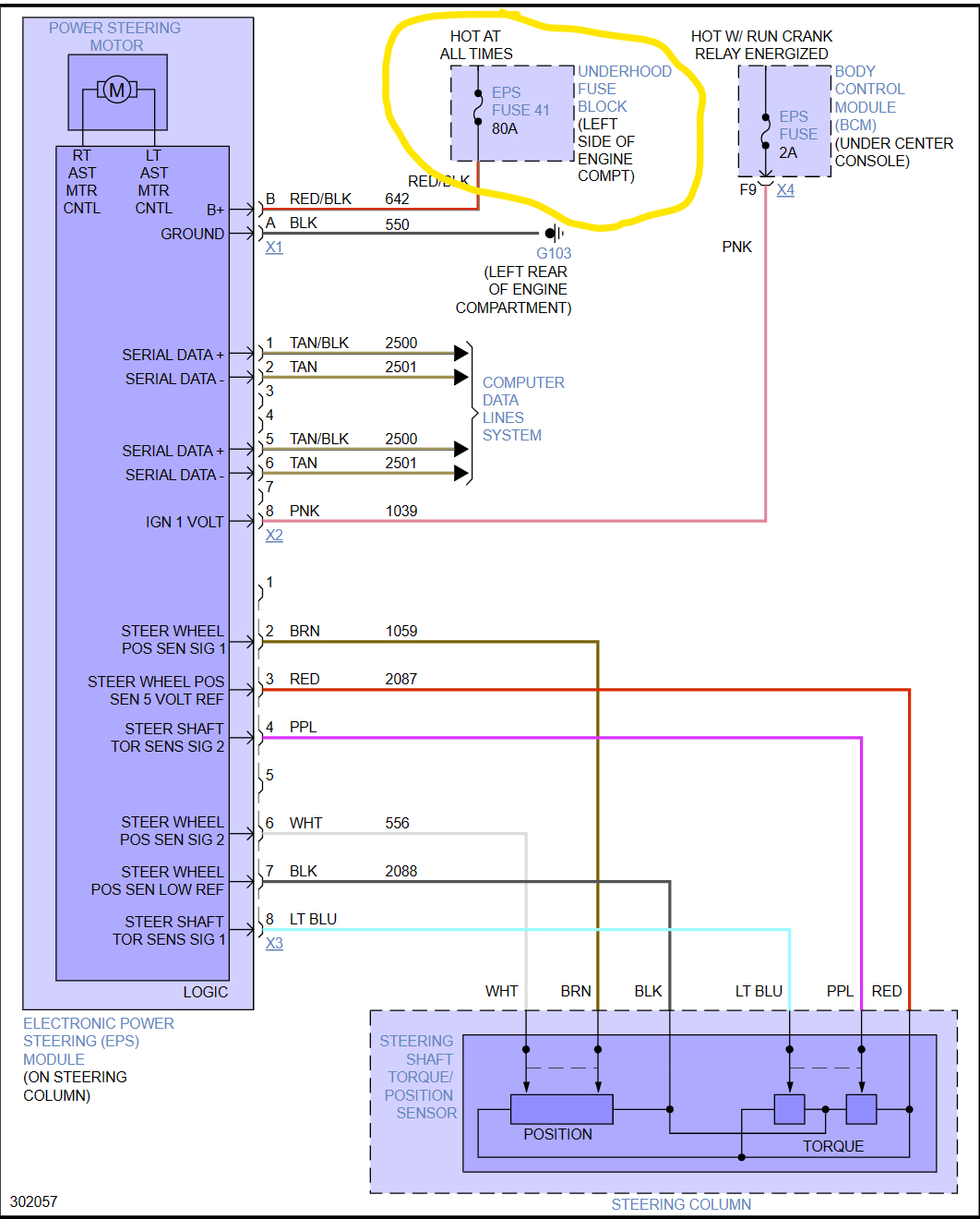

I am sending a wiring diagram of the Electronic Power Steering (EPS) Module. Let's check and see if it is getting power. If the motor is heating up because it is working too hard it could have blown the fuse.
There is an 80 AMP fuse for this system it looks like. Let's check it and make sure it is good.

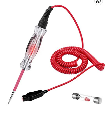

Here is a quick article on how to check a fuse. This method uses a test light, which is the best way because a fuse can look fine but still be burnt out. This test will tell us for sure that it is good or bad.
If you don't have one you can get a test light at your local auto parts store, or I found a pretty nice one for you on Amazon. Here is the link:
https://www.amazon.com/WINAMOO-Premium-Automotive-Extended-Circuits/dp/B08D9RY532/ref=sxin_15_pa_sp_search_thematic_sspa?content-id=amzn1.sym.749943ff-94bd-4679-8f03-3b5488f65fae%3Aamzn1.sym.749943ff-94bd-4679-8f03-3b5488f65fae&cv_ct_cx=test+light&keywords=test+light&pd_rd_i=B08D9RY532&pd_rd_r=7b3a36d7-bf83-4f5e-9921-47ed4333fc6e&pd_rd_w=AiROl&pd_rd_wg=Vfitg&pf_rd_p=749943ff-94bd-4679-8f03-3b5488f65fae&pf_rd_r=FTHN4YN2W2MVG7766FEF&qid=1687016636&sr=1-3-2b34d040-5c83-4b7f-ba01-15975dfb8828-spons&sp_csd=d2lkZ2V0TmFtZT1zcF9zZWFyY2hfdGhlbWF0aWM&psc=1
You're going to connect the alligator clip on the negative battery terminal. Then touch the probe end to the positive terminal and make sure the light works. If not try wiggling the clip on the negative terminal, it might not have a good connection.
Once you know it works you are going to touch one side of the 80 AMP fuse and then the other (I added a picture for you). The light should light up on both sides. If only one side lights up the fuse is bad.

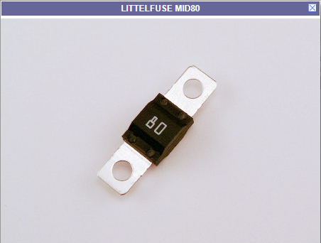

If the fuse is bad, I found one on Rock Auto for you. Here is the part number: MID80
Here is the link as well: https://www.rockauto.com/en/catalog/chevrolet,2009,malibu,2.4l+l4,1442753,electrical,fuse,2676
