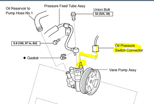

i had a leaking line on my power steering i fixed the line, now i have no power steering.

After reinstalling the new hose, did you bleed the air from the pump and unit? Also, are there any leaks? Did you remove the accessory drive belt for any reason? Also, is the pressure switch connected?
See pic 1 below.
