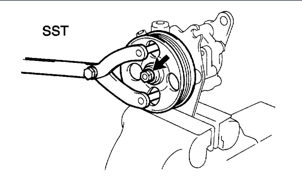

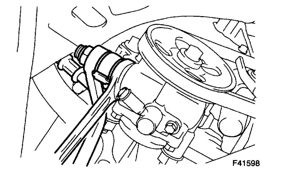

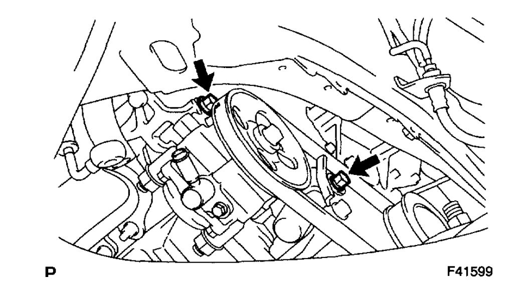

Hi, I noticed something the other day. When I was in a red light and I wanted to make a u-turn as I was turning the steering wheel I noticed it was getting a bit harder to turn as I was getting close to the turning (1/2 a turn before getting to the turning limit) wheel got a harder . As soon as I let go of the brake and gently press the gas pedal it would loosen up. It does it both sides. What can it be? Power steering fluid is topped off.
Dec 29, 2019 at 5:53 AM
Good afternoon,
This could be a worn out pump or it could be dirty fluid in the rack itself.
https://www.2carpros.com/articles/how-to-replace-a-power-steering-pump
I would start by changing the fluid and seeing it helps the issue. If it does not then lost likely the pump is worn out not supplying enough pressure.
https://www.2carpros.com/articles/power-steering-fluid-flush

7. DISCONNECT PRESSURE FEED HOSE
a) Using a spanner (24 mm) to hold the pressure port union, remove the union bolt and gasket.
8. REMOVE VANE PUMP V BELT
a) Loosen the 2 bolts and remove the vane pump V belt.
9. REMOVE VANE PUMP ASSY
a) Remove the 2 bolts and vane pump assy.
10. REMOVE VANE PUMP PULLEY (TYPE A VANE PUMP)
