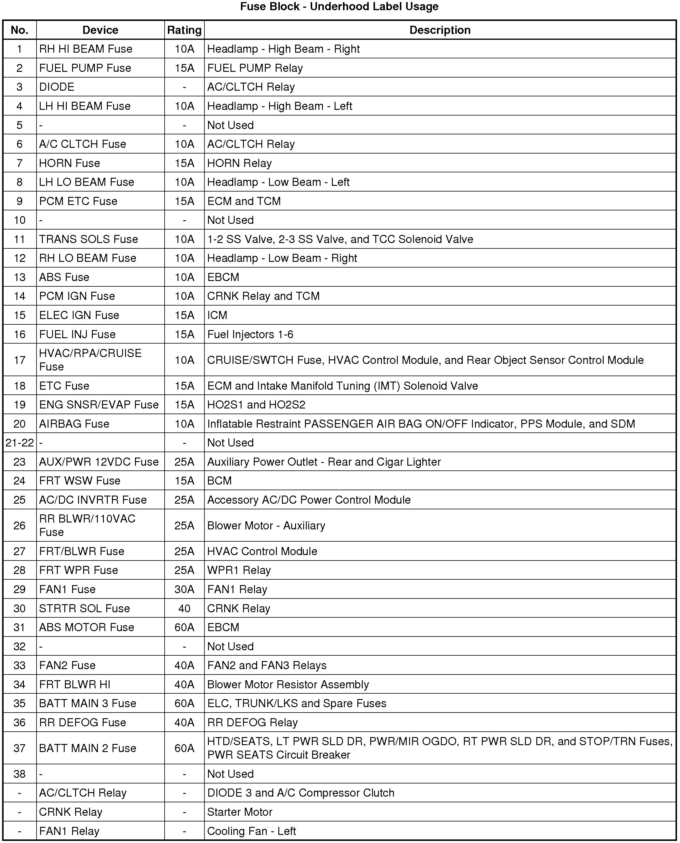

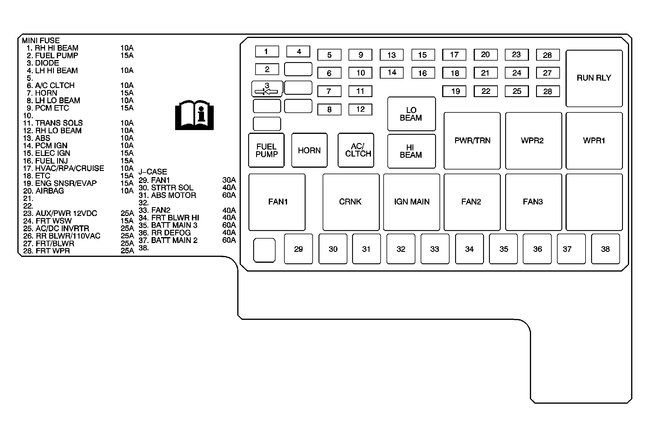

Hi Terry and thanks for using 2CarPros.
The sliding doors on this vehicle receive power via a circuit breaker. It is number 37 in the under hood fuse/relay box. I attached a picture of the box and a legend of what each component is for.
I would check to see if the circuit breaker is good. It is a 60 amp circuit.
Here are a couple links that you may find helpful:
Let me know what you find. Since there is no noise, I have a feeling there is no power getting to the sliding door control module (SDC).
