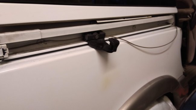

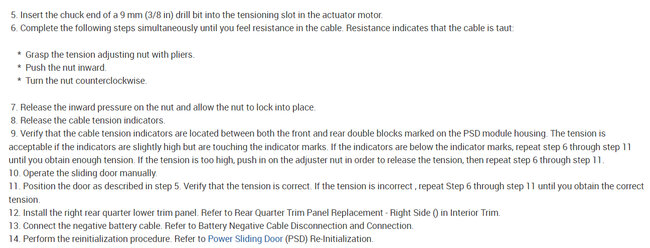

I bought this van and the power sliding door has always been sticky I press the button an the door wont open but if i open it slightly then press the button it works. I found out the roller wheel was damaged really bad and the other one was barely working so i ordered a replacement and took apart the rear quarter panel trim to change it out. I have replaced the part but cant figure out how to adjust tension on the cable.
It seems loose no matter how many times i try to tighten it.

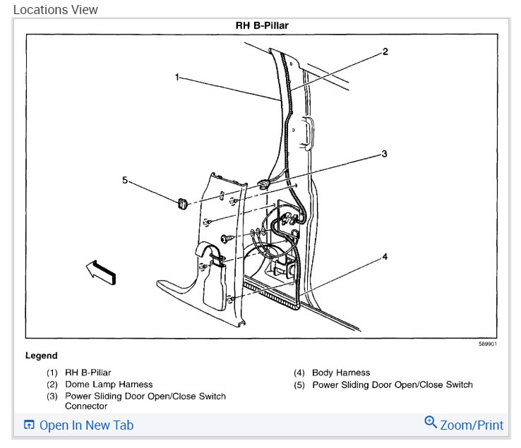

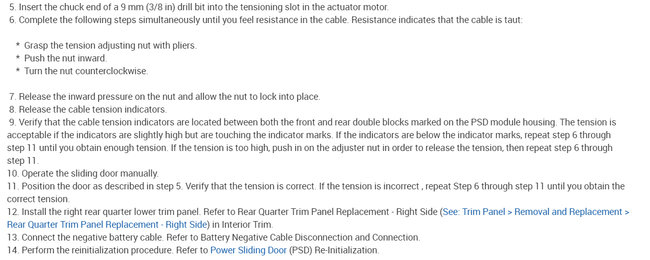

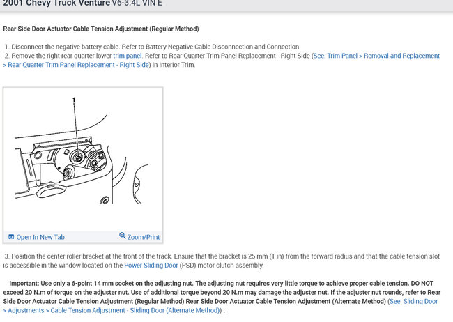

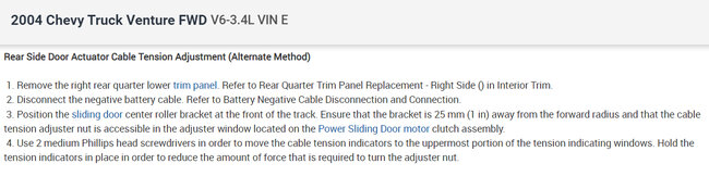

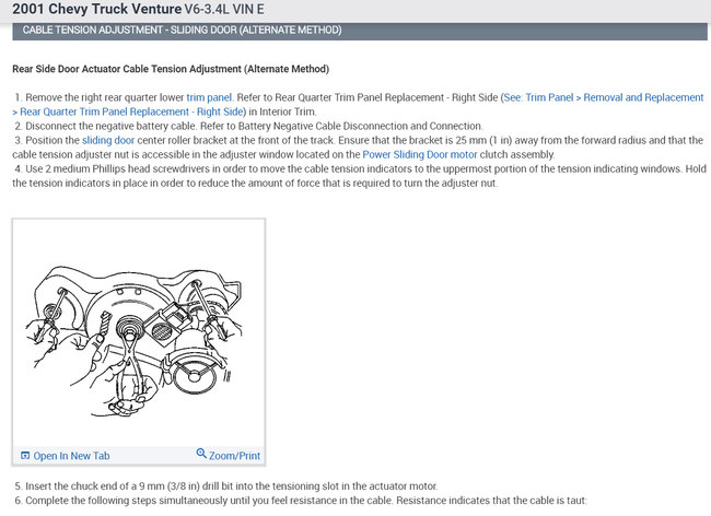

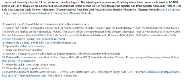

Yep, there is a procedure that needs to be followed, here is the instructions in the images below. Check out the images (below). Please upload pictures or videos in your response of any problems so we can see what to help you with.

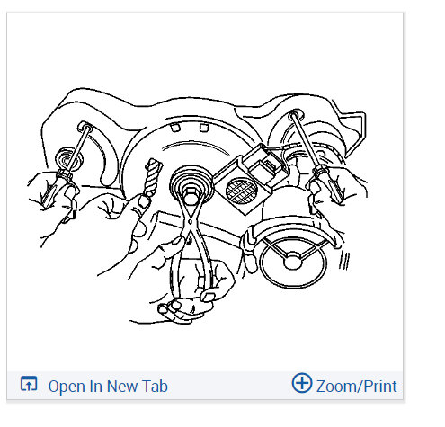

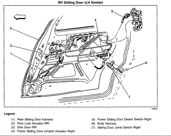

There are two different methods of adjusting the sliding door cables here are both in the diagrams below. . Please let us know if you need anything else to get the problem fixed.

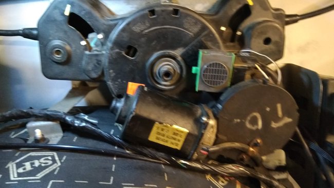

Just installed new (used one) Power Sliding door motor with cables on My 2002 Montana. I can't move the door roller but 10-15 cm? Is this due to cable tension system of what?

It sounds like the cables are not adjusted correctly, check out the third diagram on the post above, also can you shoot a quick video with your phone so I can see what's going on? You can upload it with your response.

As you can see my second pic, the door is not connected on the roller. So obviously door moves freely but the roller does not move but 10 cm.
Maybe my decreasing tension was bad idea, I should do increasing tension instead?

I see, check my post on the from August 19 it shows how to set the tension on the cables, let me know how it goes.
