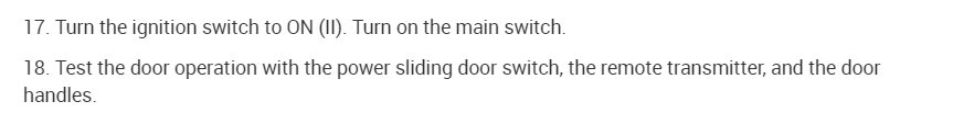

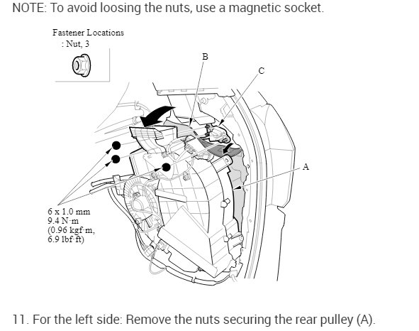

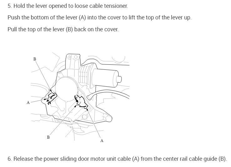

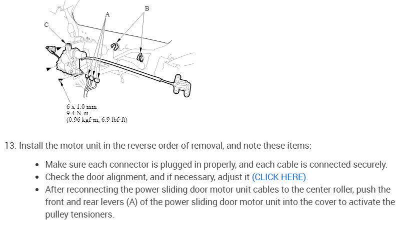

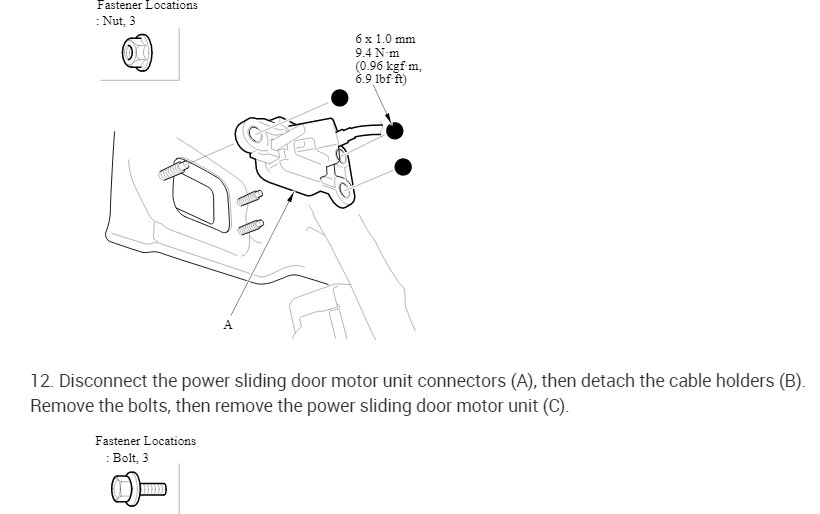

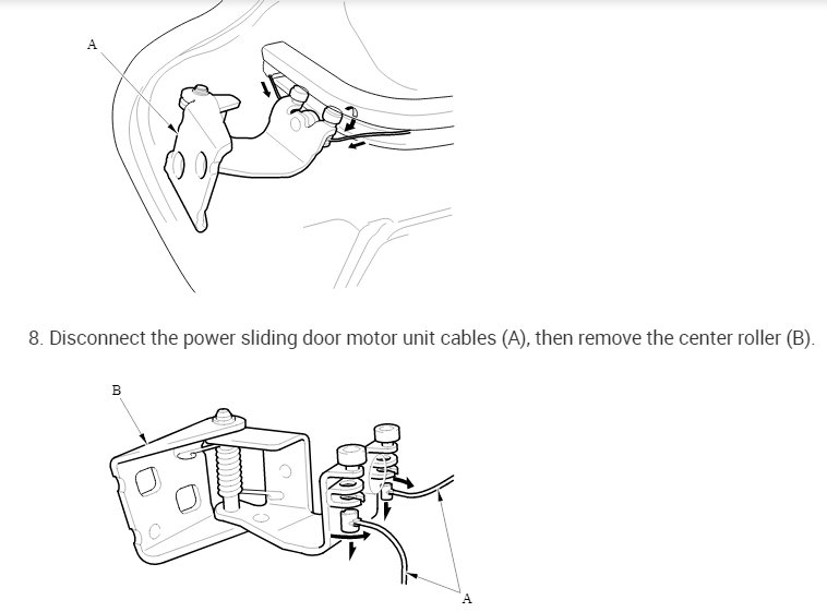

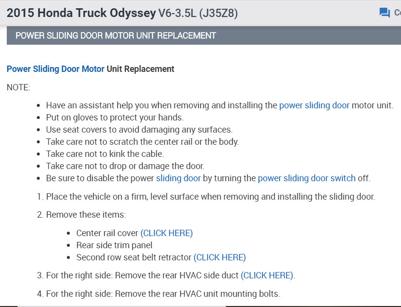

Hi, the cable from my power sliding door is broken. I can’t open the door at all, how do I cut the cable to be able to use it manually?
Jun 6, 2020 at 11:10 AM
DANNY L
  • 5,648 POSTS
Hello, I'm Danny.

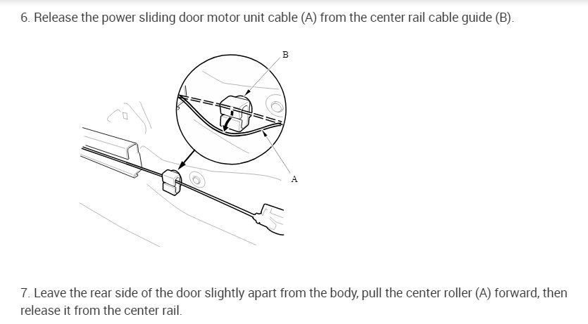

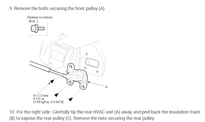

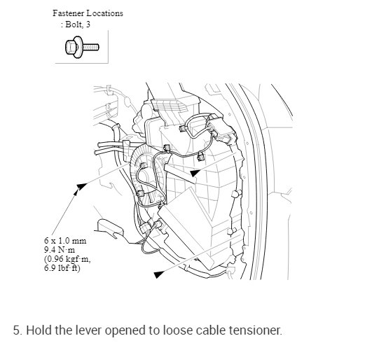

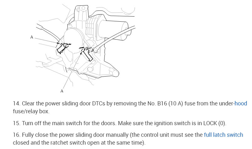

I've attached picture steps below on how to gain access the the power sliding door motor for the repair or disconnect of the cable.You will need to remove the right rear panel in the rear cargo are.If you need info to remove panels I can as well.Let me know if you have any further questions about this issue.Hope this helps and thanks for using 2CarPros.
