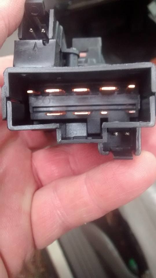

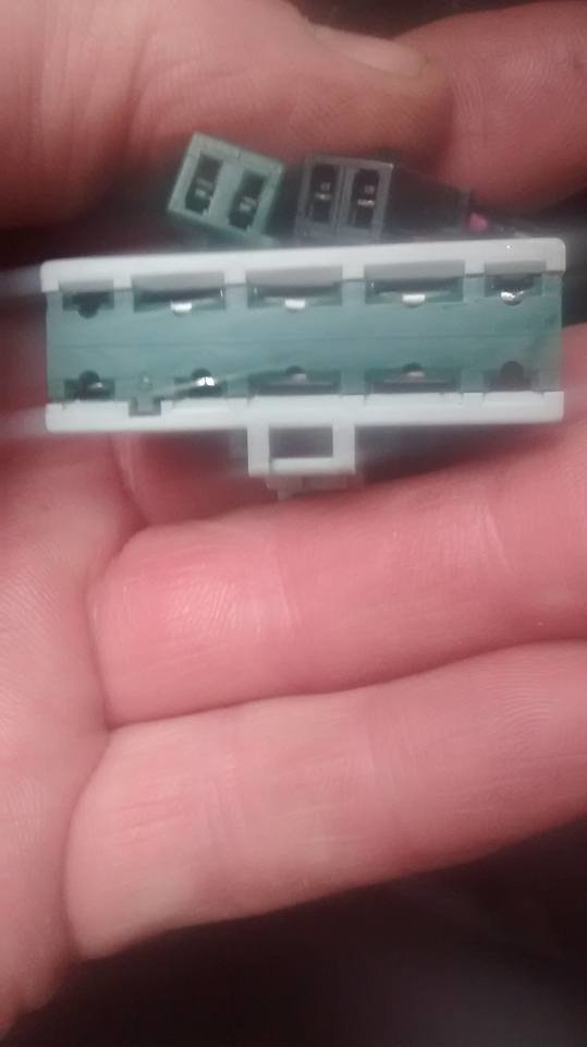

I took the ignition out and looked at the electrical, no visible damage to switch or terminal plug..
Tried a new ignition switch, No change....

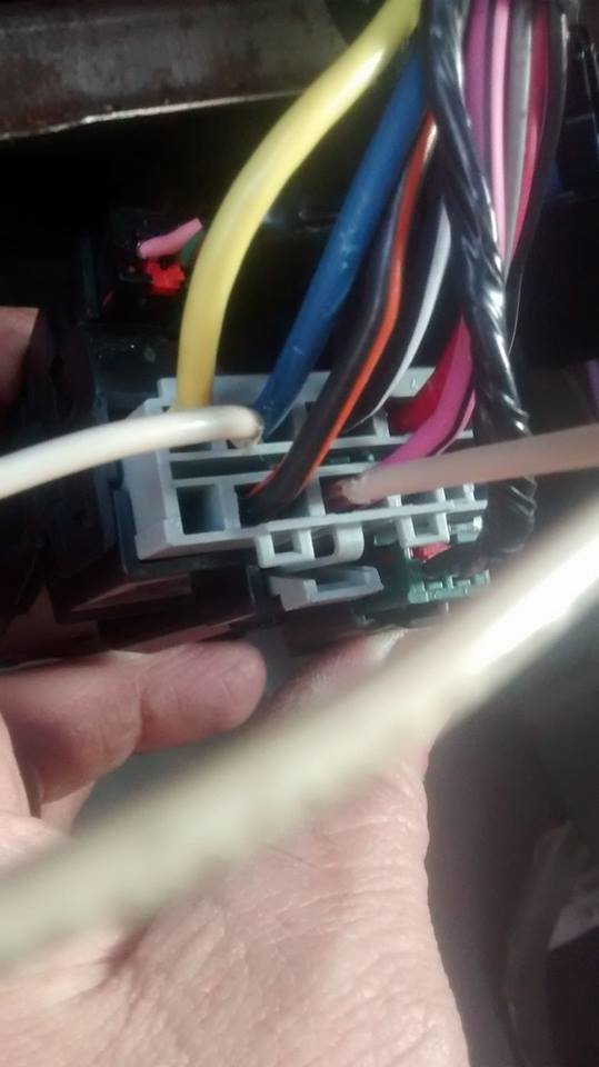

Plug the connectors back in, then back-probe through it on the pink / black wire. You should have 12 volts there. If you do, back-probe the black / orange wire. 12 volts should be there when the ignition switch is in the "run" position. Those voltages will tell us where to go next.

Hey, I've tried three ignition switches from different auto parts and no change.
Back-probed the pink / black wire, 0 volts
Back-probed the black / orange wire, 0 volts
Ran a Jumper wire from the big Blue wire to the pink / black and to the black / orange wire and had 12 volt's on them and had 12 volts on all three fuses and everything worked...

When I jumped power from ignition switch plug Blue wire to the pink / black wire and the black / orange wire it put power on all three fuses #11.#12 under dash #12 under hood...
Without white Jumper wire the pink / black wire and black / orange wire both only have 0.02 volts

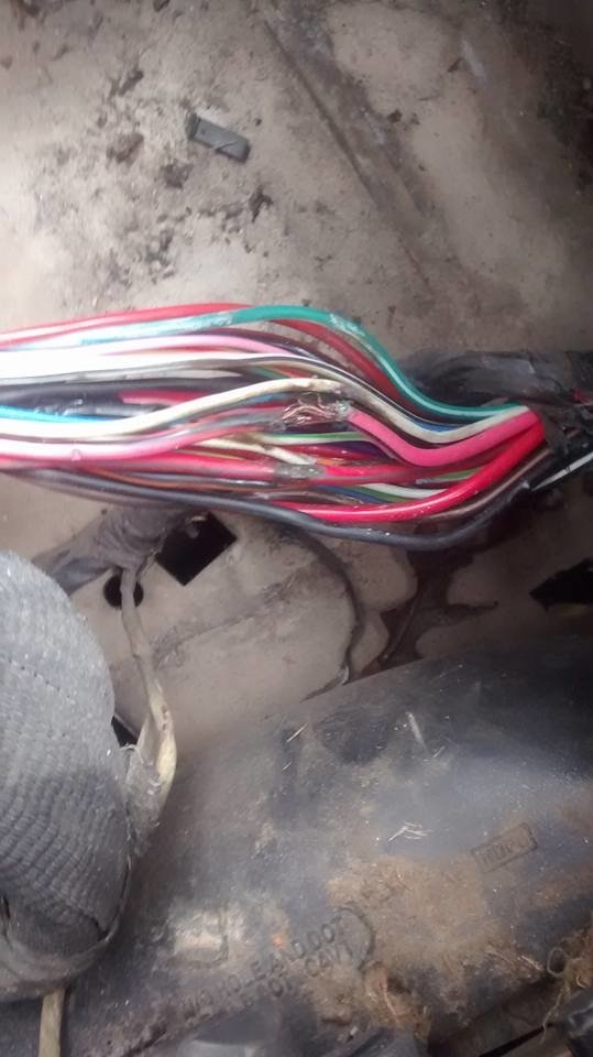

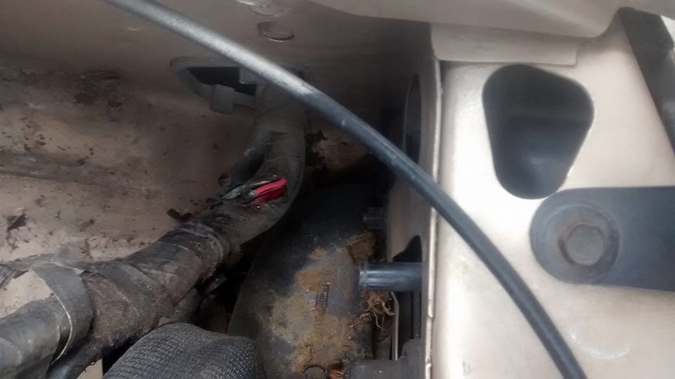

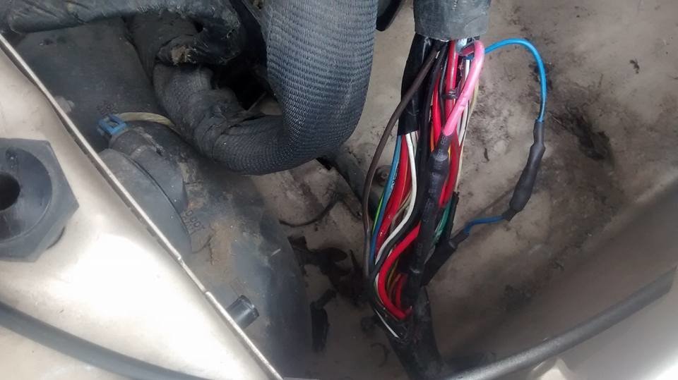

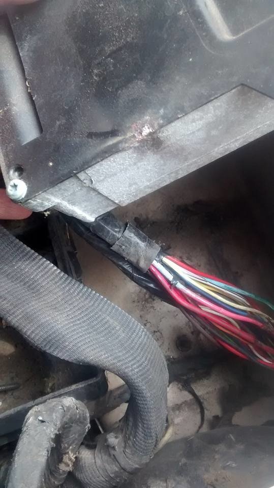

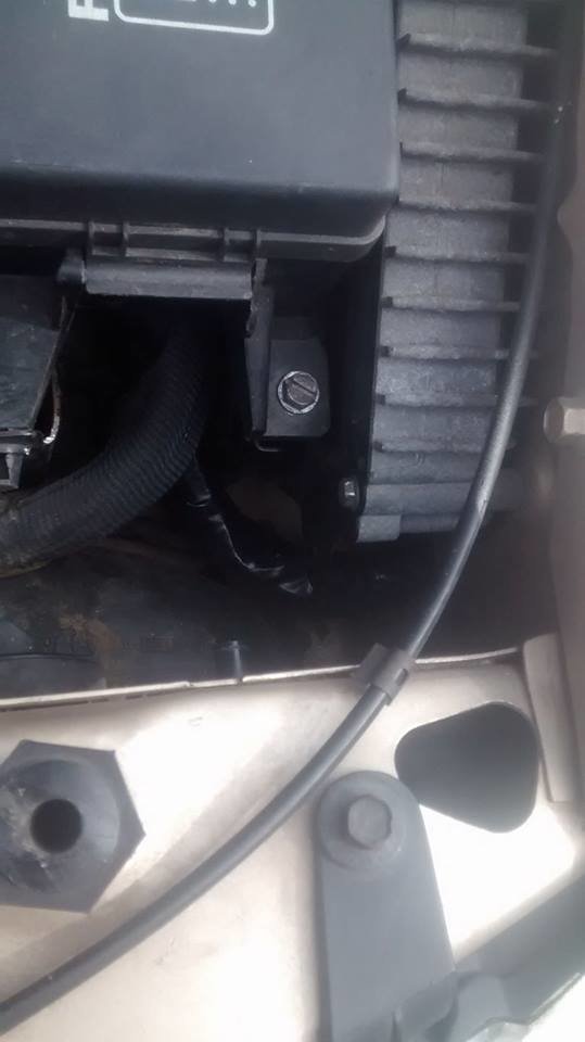

Fuse #103 40 amp was dead, I ran my jumper wire and heard/seen spark near front corner fuse box next to ECM so I removed battery, fuse panel, ECM.

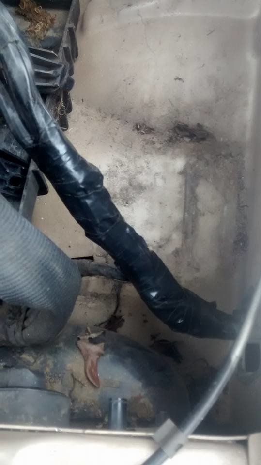

Apparently at sometime the ECM was replaced and on drivers side the wire harness coming through front corner of inner fender near ECM was ran wrong and rubbed the ECM until the Pink/Black wire and a small blue wire shorted against the ECM plate.. I replaced the bad with wire and butt connectors and heat shrink and then used black electrical tape to wrap all the wires then ran the harness its proper rout assuring of no future danger, I replaced the #103 40 amp fuse...
All works great as it should....
