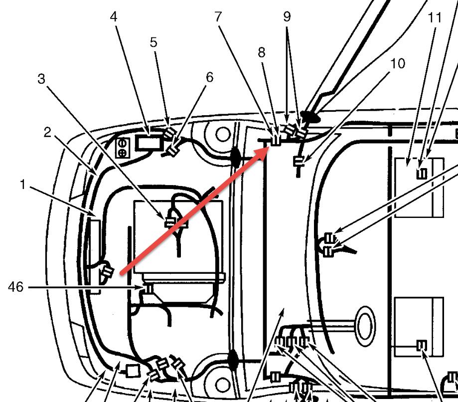

Power seats don't work and neither does either of the automatic sliding doors.

Neither of the power seats do not work and neither do either of the sliding doors.

for doors scan for codes as it may be a body module problem and then check if circuit breaker in fuse box if sending power to switch it may be switch or check to see if switch sends power to motor. a pro will have to scan for codes auto parts can't do it.

where is body module you mention. And, which switch are you referring too?

the switch is the one that operates the seats. body module is item 7 in pic. If you replace it a pro has to program it to your vehicle as they are vin specific

is the module in the fuse panel on the right side of the dash?

rh side of dash but a pro has to use his scanner to match to your vehicle if you have ideas of replacing it your self.

I guess you mean it is under the dash, and not in the fuse panel.
What about the power seats? I will check for power on the plug under the seats. Both don't work.

yes it's under the dash for the bcm and really don't kow why you wan to find it. as for switches see if power is going to them if not it can be the circuit breaker in fues panel is bad or a short in wiring.
