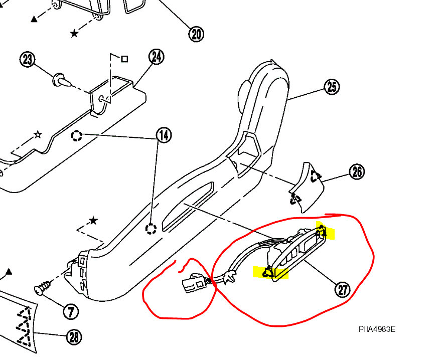

I would start by checking the fuse in the power distribution box under the hood. See pic 1 for which fuse to check.

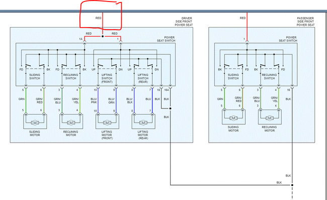

Next, if the fuse is good and there is power in and out, check for power to the switch itself. If there is power and they still don't work, you may have a faulty ground. See pic 2 for ground location.

If I recall, the switch is clipped into the plastic molding on the side of the switch. Take a look at pic 1 and let me know if it helps.

No this switch is on the too right, pretty much part of the top of the seat, as most Nissan's are, not pike the pic.

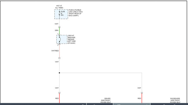

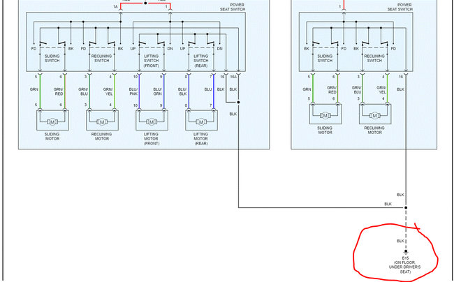

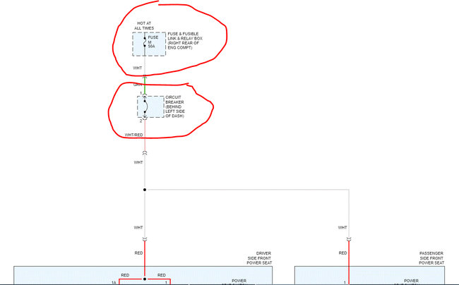

If the voltage is negative, make sure you don't have the polarity reversed. As far as the power supply, it comes through both a fusible link and a circuit breaker. The wire is white but splices to red before going into the control. Also, the ground between the two seats is spliced and ground is located under the driver's seat, attached to the floor.
See the attached pics. It shows the wiring schematic for both front seats.
Let me know if this helps you.
