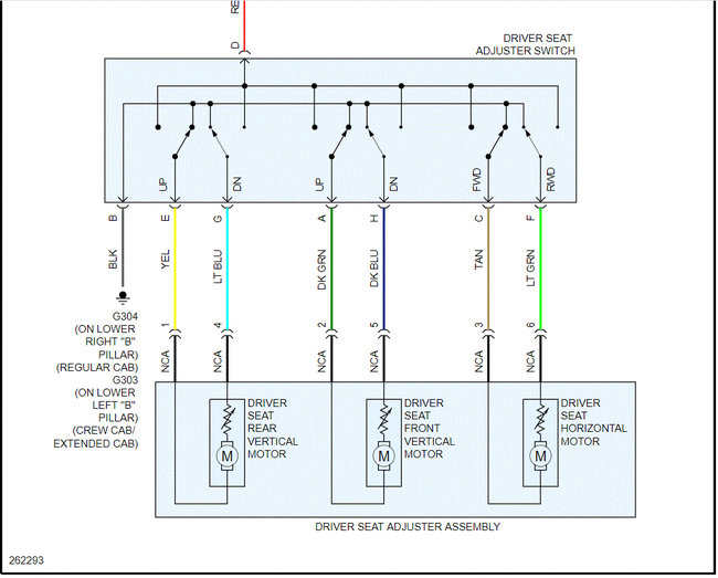

So I found another article on here that said in a 1997 Blazer the seats and door weren’t working and they wouldn’t be due to a blown fuse. I am having the same issue with the truck listed above. They seemed to this it would more likely be an acc circuit breaker.
Looking for help. The seat is stuck extremely close and it’s almost undriveable.
Is this most likely the issue and if so how can I locate and replace the part?

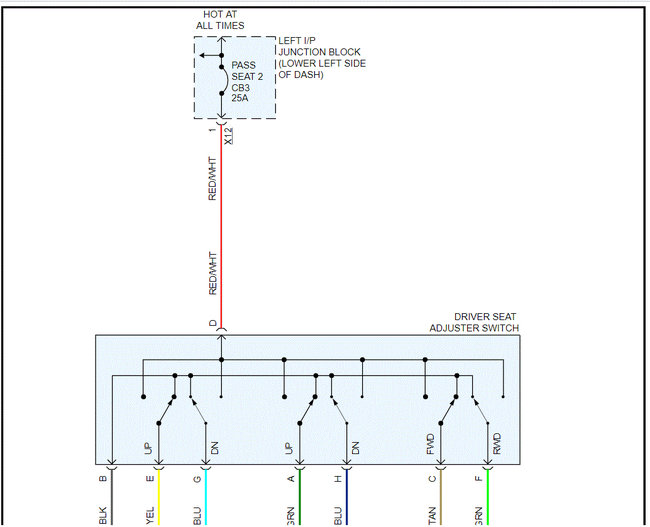

It is a circuit breaker. It's located in the vehicle (under left side of dash). I attached the entire wiring schematic below. I had to cut it in half to make it readable.
First, check the circuit breaker and see if there is both power to it and out. If there is, go to the seat switch and check the red wire with a white tracer for 12v.
Pic 3 shows the circuit breaker location in the box.
