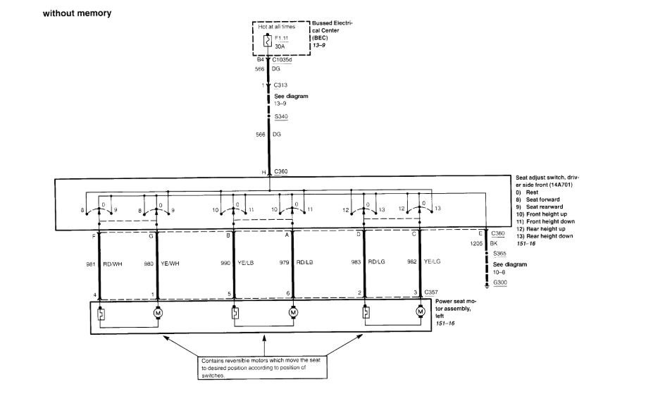

My driver side power seat stop working.

Good evening.
I attached a diagram of the seat circuit. Check the fuse listed for power on both sides.
If that is good, you will need a test light or voltmeter to do some checks at the switch that controls the movement of the seat.
