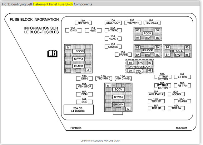

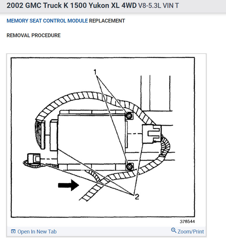

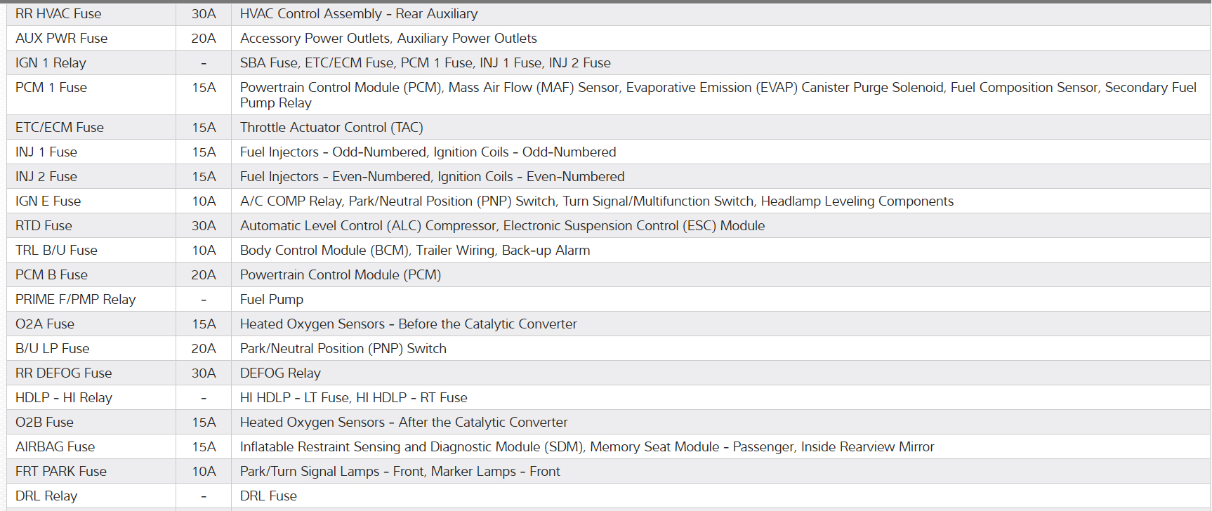

My driver side seat stop working after I left my window and sunroof open. what should I do?
Mar 30, 2021 at 8:40 AM
  • 55,447 POSTS

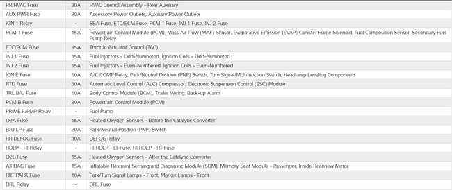

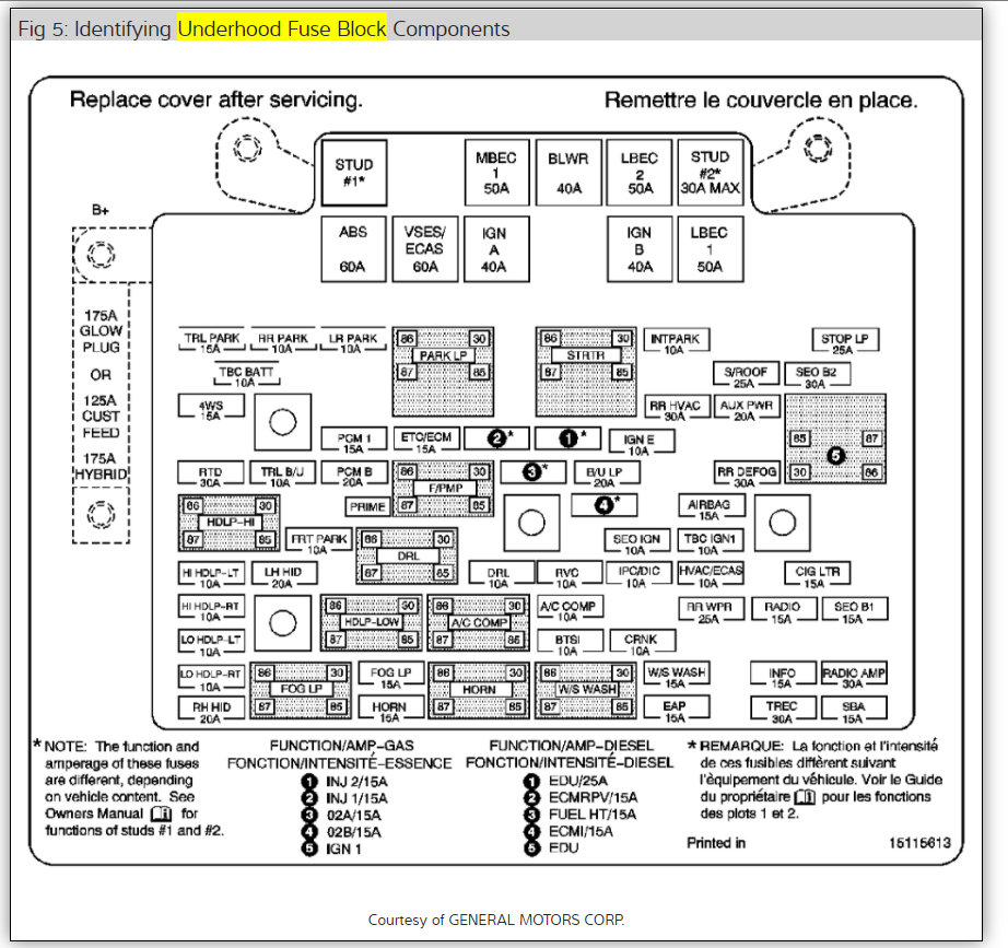

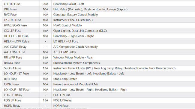

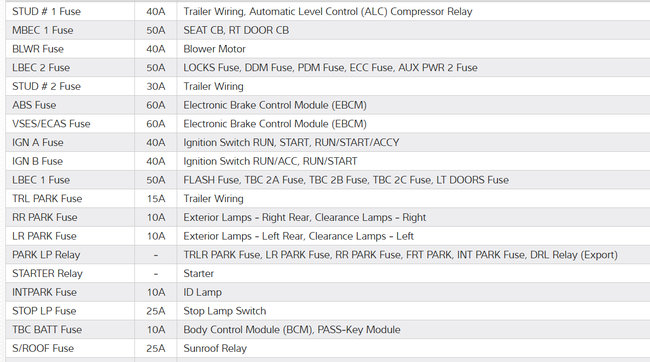

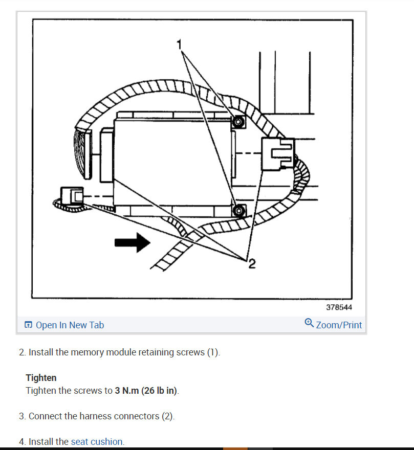

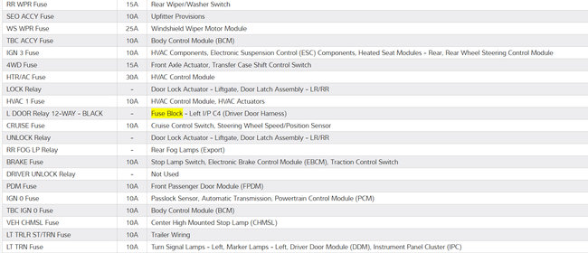

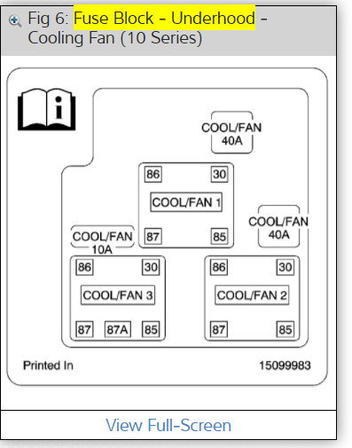

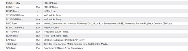

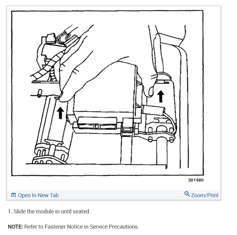

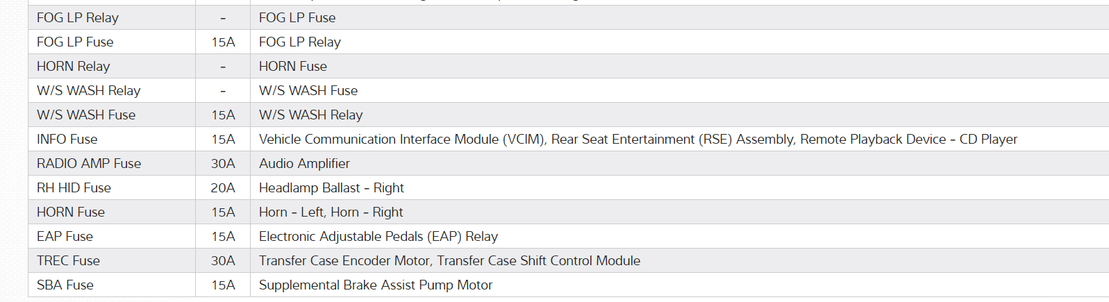

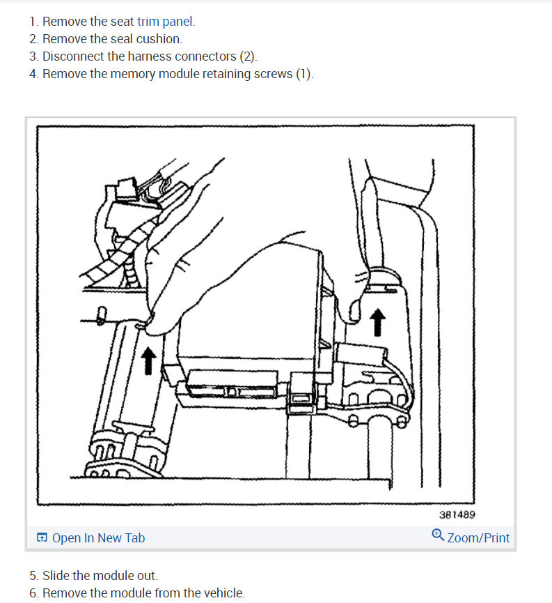

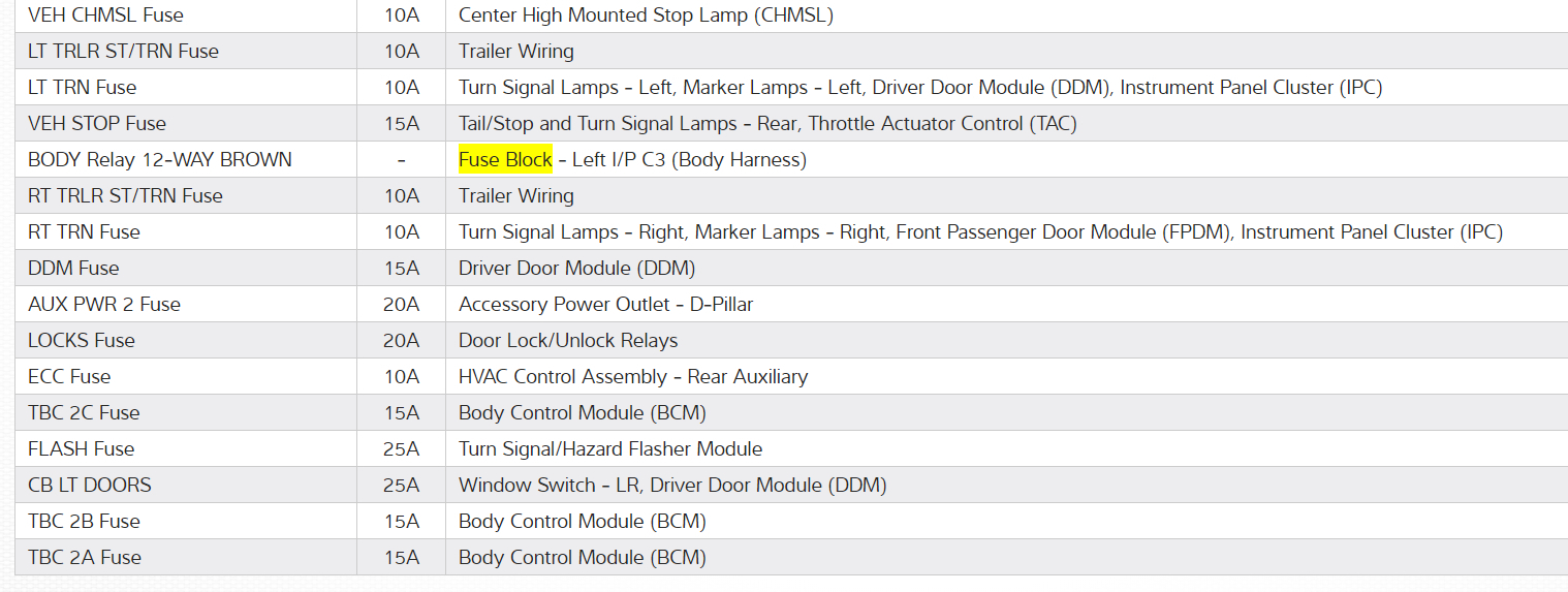

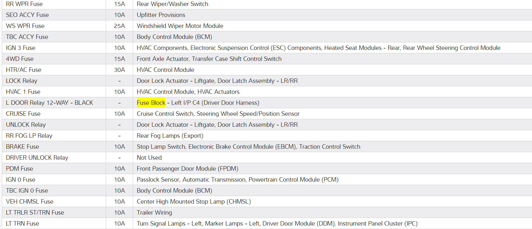

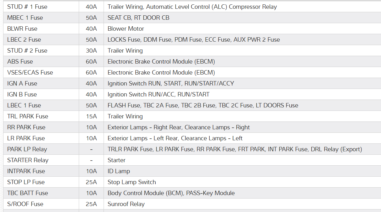

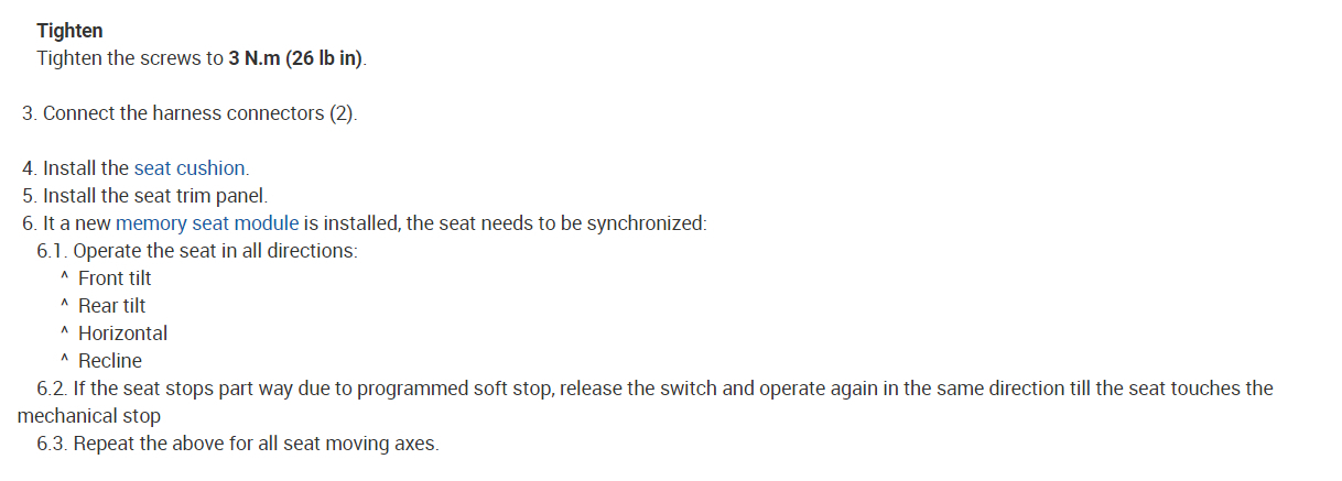

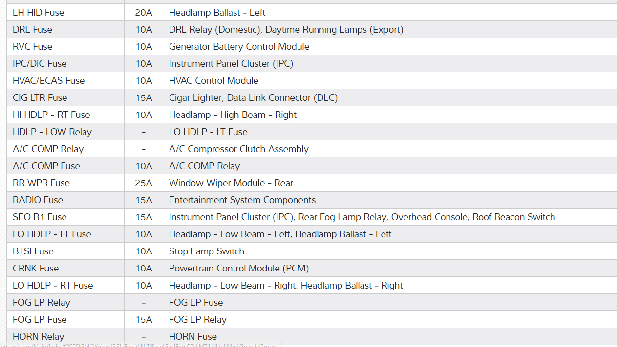

This is common when the drivers side seat module goes out. but we should check the fuses first. here is a guide to help with the fuse locations as well. I have also included the DSM replacement instructions in the diagrams below.
