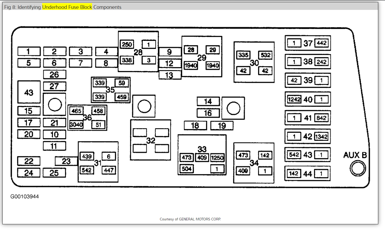

The radio, the power locks and the power seat control stopped working. Checked all fuses none blown any suggestions would be greatly appreciated.
May 31, 2022 at 9:02 PM
  • 55,579 POSTS

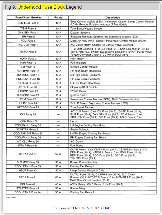

In the under-hood junction fuse block, there is a Batt1 #37 maxi fuse 60 amp we need to check for power. this guide will help show you how with the fuse locations in the diagrams below:
