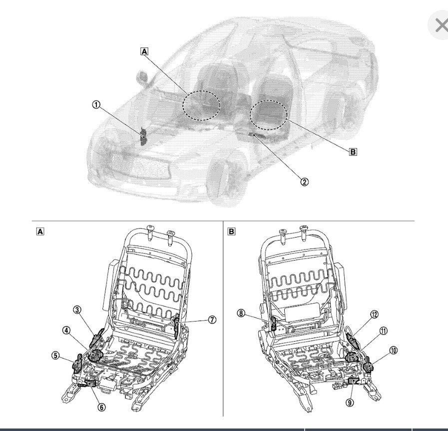

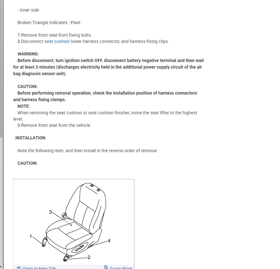

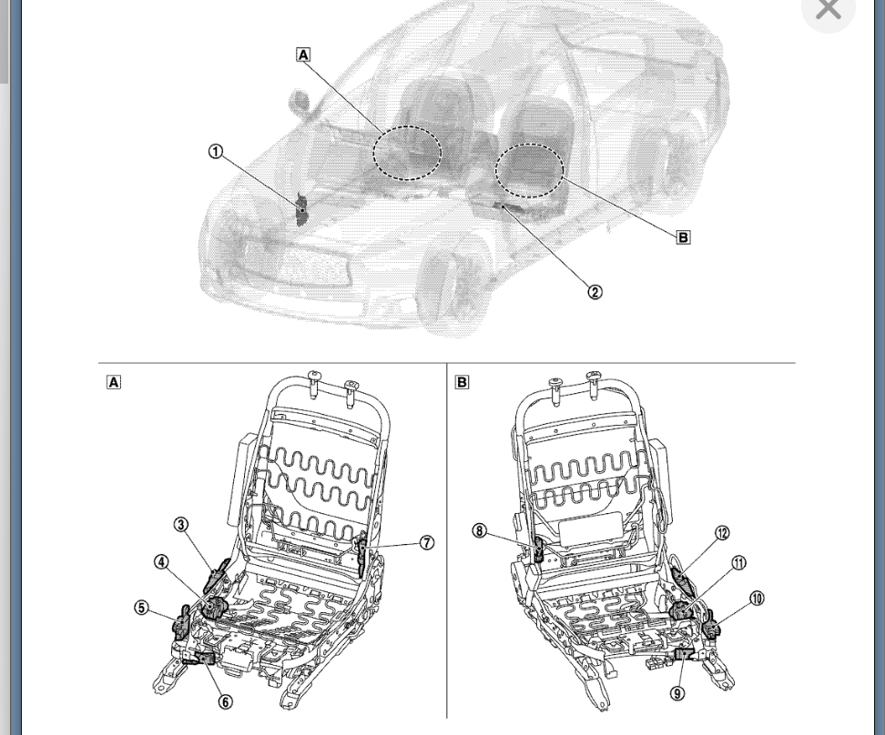

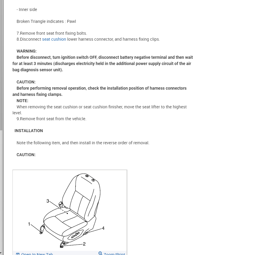

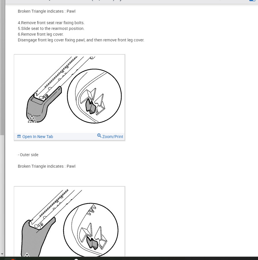

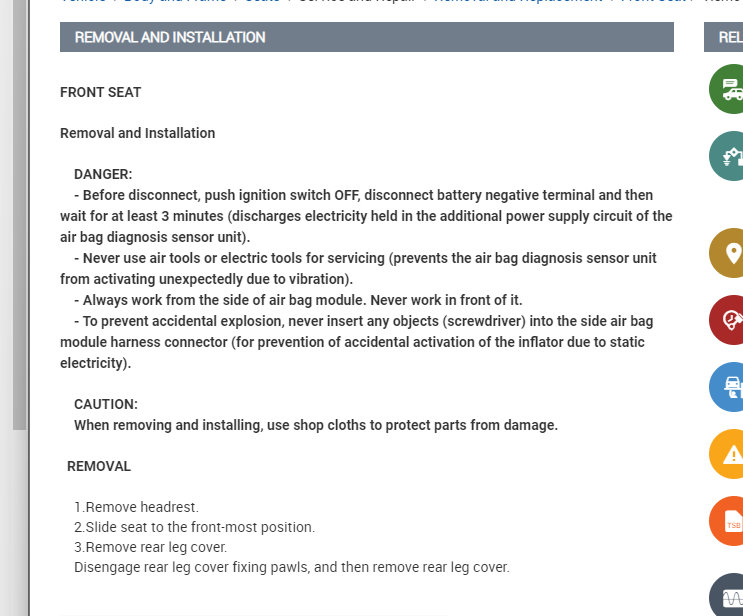

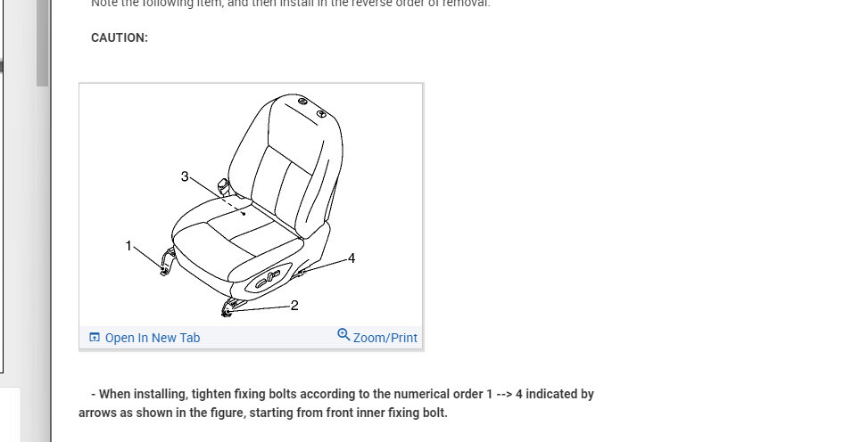

I have not removed one on this specific vehicle, but I have found that on these vehicles it is far easier and quicker to just remove the seat and tip it backwards which will give you access to the motor.
I am attaching the info from the manual on how to do this below
Please take a look at this and how you make out with it.
Let me know if you have questions on this and we can go from there.

Thanks. I don't see anything in the instructions about removing the motor itself, for the sliding motor.
Sunday, May 1st, 2022 AT 12:33 PM
Sorry about that. However, I just looked for it and it doesn't have a process for that. This is not uncommon with these types of components and the aftermarket manuals. They have how to remove a seat cushion but not this motor.
Sorry that it doesn't have this detail.

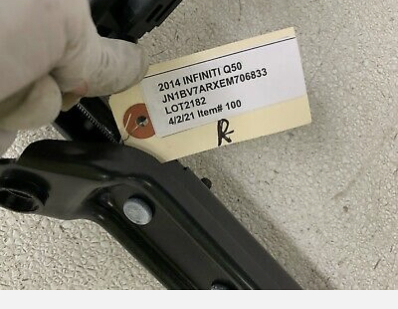

I was able to remove the seat from the track finally. The track on the left when I tighten the bolt in the back will move the track forward, but the other side won't move. There is a boot at the end of spinning threaded rod if you know what I mean. If it is stuck and would not move when I tighten it for it to spin, what would you do, am sure something is stuck in that track. Picture is just from the net to show that rod which at the end has a bolt which is not showing.

This is a common problem turned out with these tracks, they are defective, I got it to move with the socket, but when I out it on and it doesn't, only one side, the other side moves when electric motor applied. Can't find it used anywhere, only the passenger side, bummer. Can you find out if the part number for right is same for left? I am assuming no. I lubricated and cleaned it real good but still.
Wednesday, May 18th, 2022 AT 7:47 AM
That is unfortunate but makes sense. Unfortunately, they are not reversable because the seat motor and switches mount to only one side. So that means you would need to spin it around and the bolts will not line up for the front holes of the track with the rear mounting location.

This was a challenge, but I got it fixed. So since only one track was stuck, I kept turning the rod back and forth for the length of the seat, spraying carb cleaner and Rust plaster spray, eventually it loosened up. But removing it was a pain since the fourth bolt was not showing, so if anyone ever faces this, remove the four nuts that hold the track to the seat and lift the seat. Put it all together and it works. Thanks for the help.
