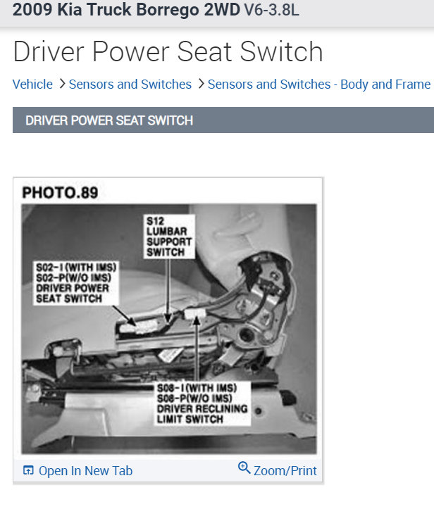

The power seat button that pushes forward and back on the driver's side is not working?
2009 KIA BORREGO
97,000 MILES • 3.8L • V6 • 2WD • AUTOMATIC
SDSLBA
The height and lumbar adjustment are working fine. What is the approximate cost and/or repair instructions for this? I am having difficulty finding a part called power seat switch for my vehicle anywhere.

For some reason they are not listing an adjuster switch so you might need to find a used one. Here is a generic guide to help with the steps and specific information for your car in the images below:
https://www.2carpros.com/articles/seat-position-switch-replacement
Control Switch 0.6 hours labor.
