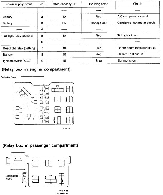

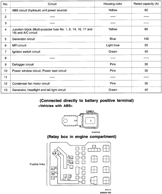

I cracked a head on my vehicle and the diagram on the cover of the fuse box under the hood is all worn away. Does anyone have a picture or diagram of what that is supposed to look like?

Let me know if these help.

PHILMAN53
Just what I needed, thanks so much!
