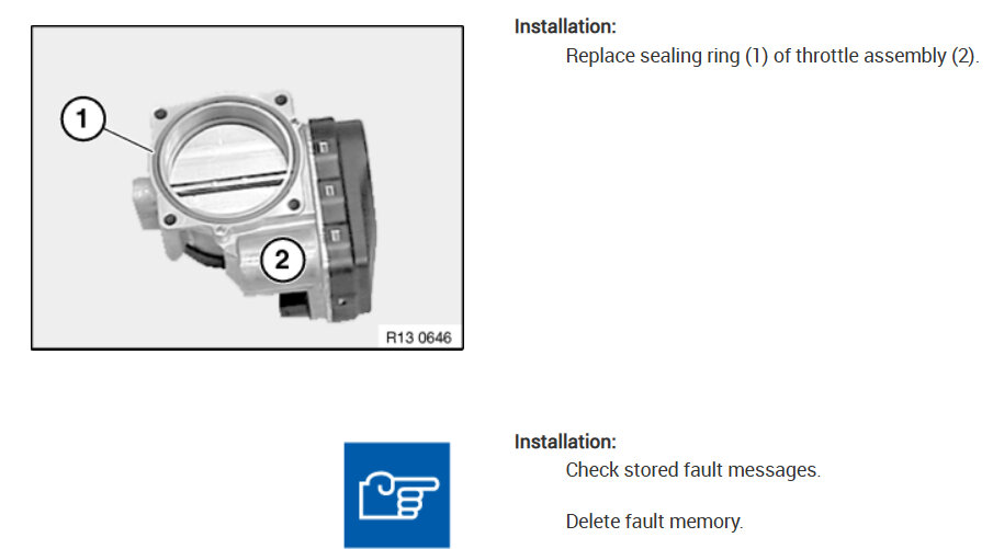

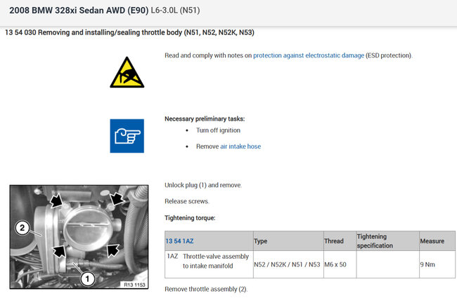

Sure, this is a classic vacuum leak or a dirty throttle body. Here is a guide to help us fix it and instructions in the images below to help you with your car:
Use this guide when the engine is cold:
And this guide to help clean the throttle body:
Check out the images (below). Let us know how it goes.
