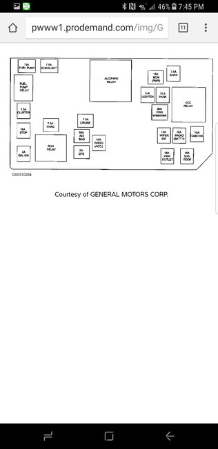

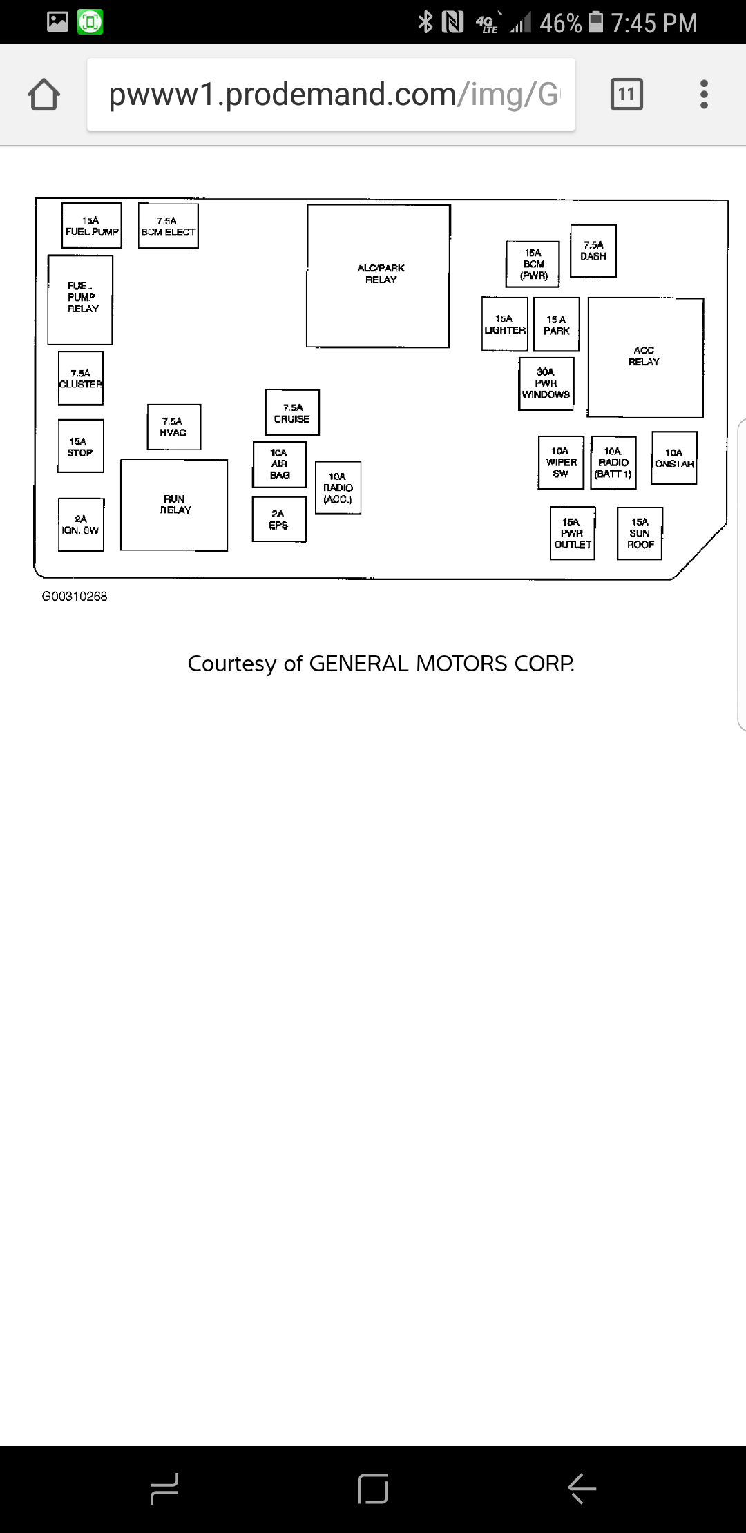

My front power outlet does not work and the back one works perfectly. it occurred after using an electric air pump using front outlet.
Jul 19, 2017 at 11:40 AM
SATURNTECH9
Experienced Mechanic
30,869 POSTS

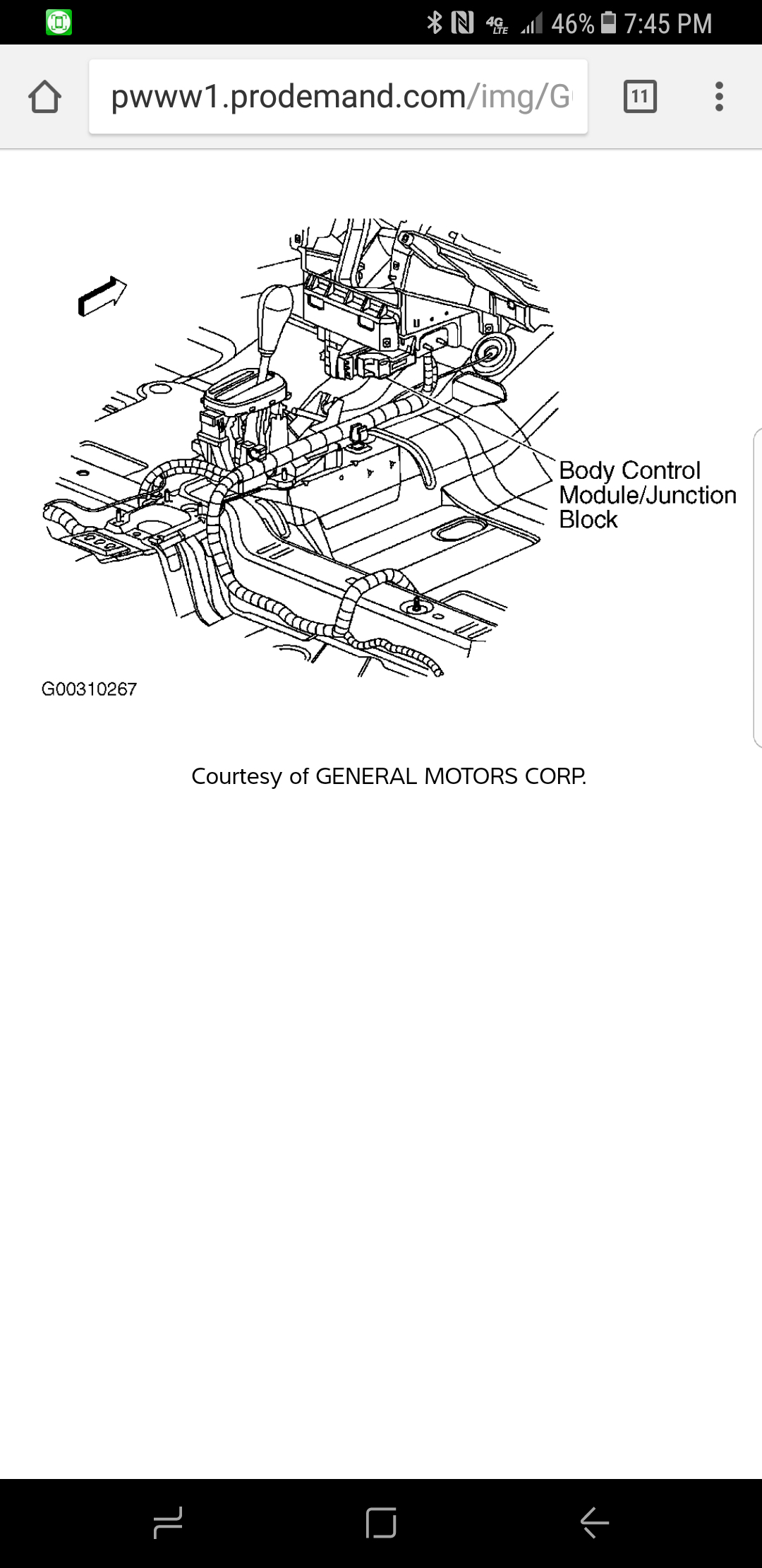

You blew the fuse by using the pump that was too much drama for the fuse.
Jul 19, 2017 at 12:43 PM
SATURNTECH9
30,869 POSTS
The fuse labeled lighter is the fuse you want to replace, it is a 15 amp mini fuse.
Images (Click to enlarge)
Jul 19, 2017 at 12:47 PM
BRADEN MCCANN
MEMBER
4 POSTS
Thanks so much it worked perfectly!
Jul 20, 2017 at 10:47 AM
SATURNTECH9
30,869 POSTS
Your welcome glad it went well please tell all your friends about us.
