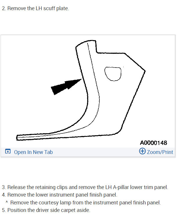

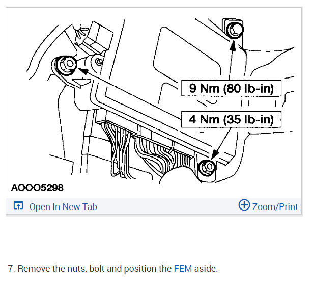

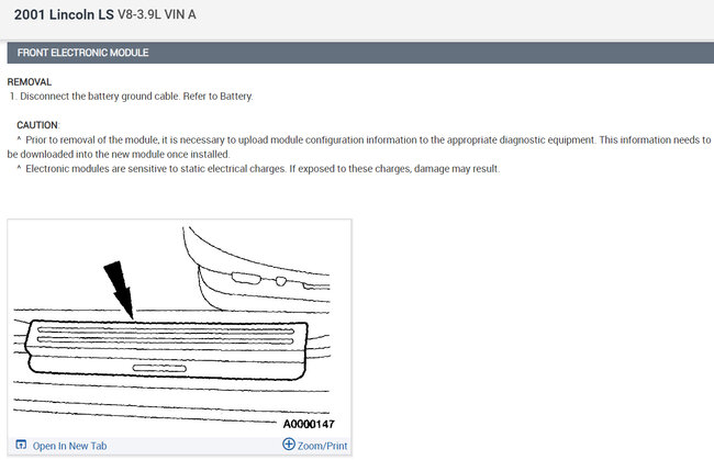

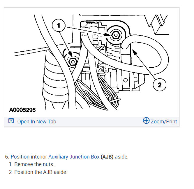

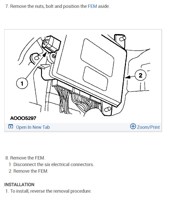

It sounds like the front electronic module is out. Is this the module you replaced? Here is the location of the module and how to change it out? Check out the images (below). Please let us know what happens.
Oct 16, 2024 at 4:30 AM
RICHARDARLEN
  • 8 POSTS
Yes, that’s the one I replaced.

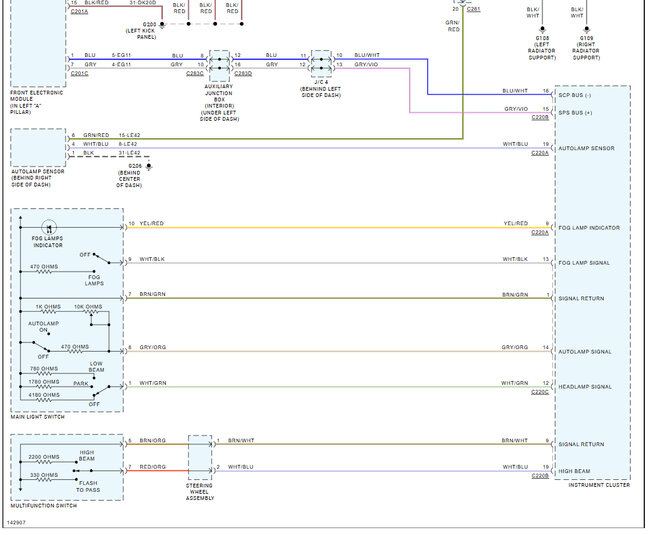

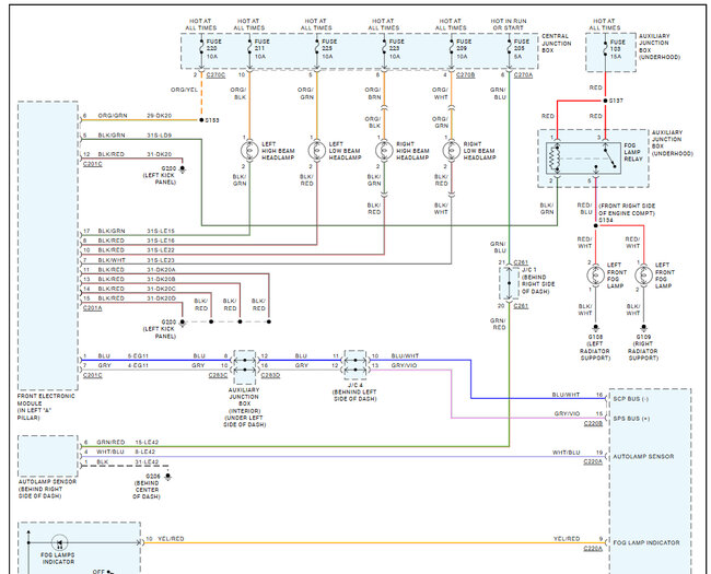

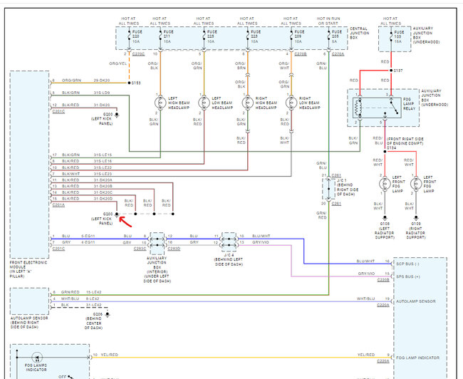

Okay, at the left kick panel there is a ground (4 of them - G200) for the front control module, let's see if they are connected clean and tight. Here are the wiring diagrams for the module and the ground locations as well. Check out the images (below). Please let us know what happens.
Oct 17, 2024 at 2:06 AM
RICHARDARLEN
  • 8 POSTS
I unscrewed G200 grounds and sanded and cleaned them. It didn’t change anything, sorry to say. do you have any more tips to check?
Oct 19, 2024 at 10:29 PM
  • 55,711 POSTS
Can you confirm all 5 grounds are good? Please connect the test light to power and check the 5 red/blk wires at the front control module.

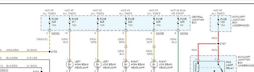

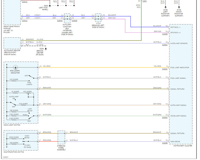

I check every fuse in all three fuse boxes to double check everything I remove sanded and reattached them to unibody they were to main ground cables one in trunk and one before ECM rt firewall everything okay.
Oct 28, 2024 at 3:22 AM
  • 55,711 POSTS

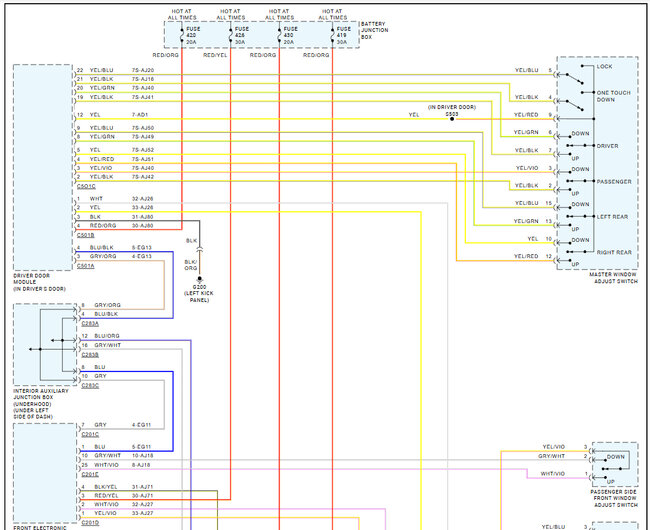

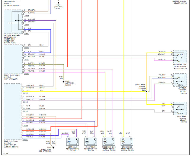

Here are the wiring daigrams for the windows, use the test light to re-check for power, and then switch the lead to power to check the grounds. We must be missing something.
