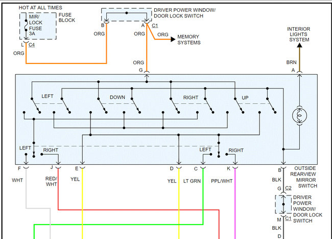

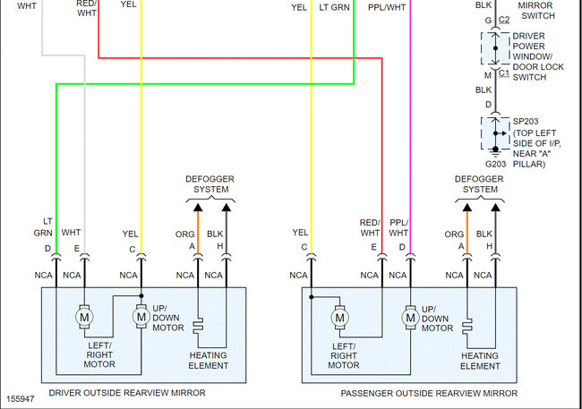

I have a 2006 Silverado that I converted using 2002 Power Windows and Door Locks. I have pinned out the Power Windows and Door Locks. Built a reversing double relay for the door locks and a bridge harness for the power windows.
Everything works, well sort of. I am now trying to figure out the power mirror switch and have hit a bit of trouble. I used the donor harness from a four door 2002 Silverado and purchased the factory switches for the two door since I have the standard cab.
The issue seems to be the the wire and switch may not be the same between the 2 door power mirror switch and 4 door harness. I removed the green and purple wires that go to the rear windows. Leaving the other wires in the same positions.
I can find the 4 door switch pinouts which match mine but not the 2 door so my questions is, are they different? and if so does anyone have the pinout for the 2 door?
If not I will strip the wires to the mirrors and bypass the switch since my power windows and door locks work.

You have your hands full. LOL As far as the schematics, I attached what I have for power mirrors on an 2002 basic cab. Let me know if they help. If you need them for a different year, let me know that as well.
Let me know if this helps or if there is something different I can get.
