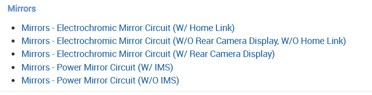

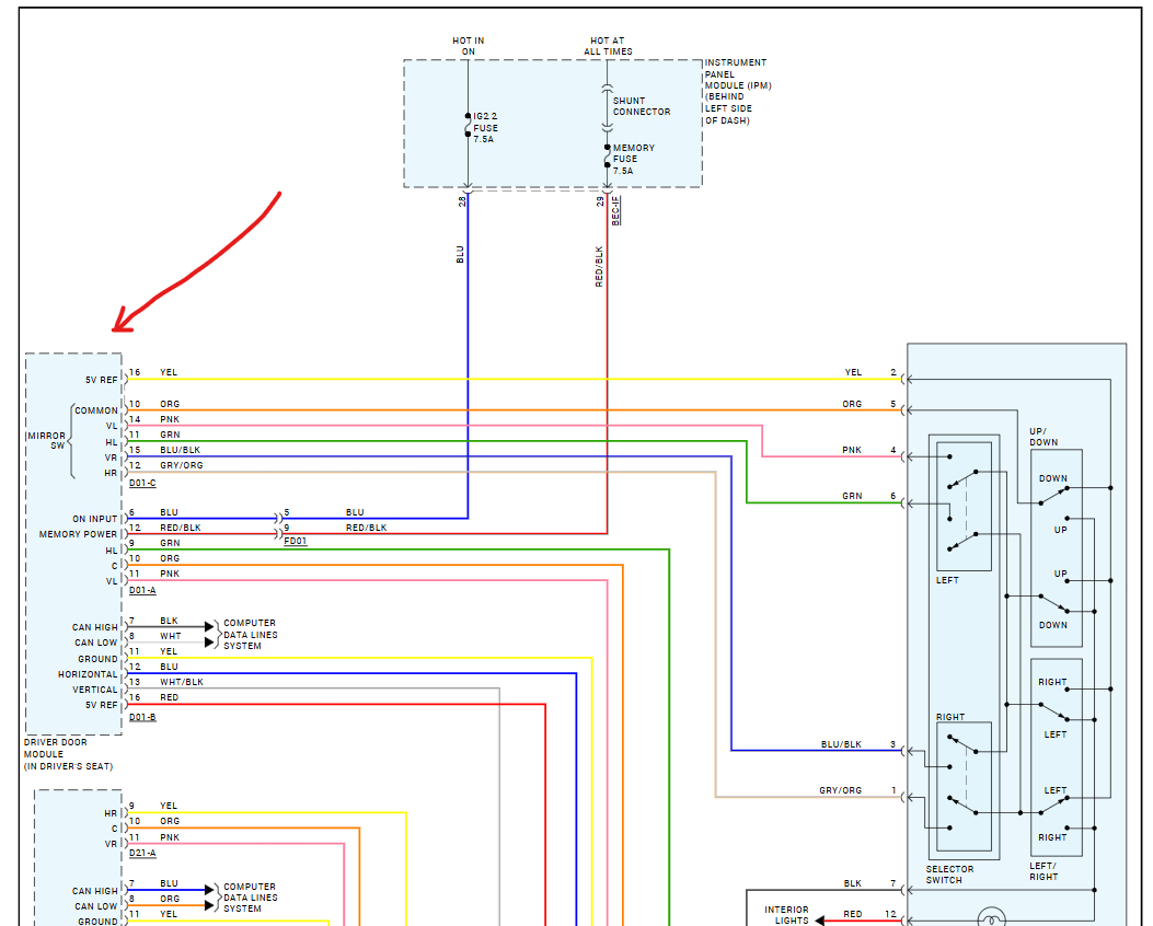

no matter what I do to the right or left to adjust the mirrors they keep moving on their own after especially go down, I suspect a mirror switch issue
May 28, 2026 at 5:23 PM
  • 55,770 POSTS
Yep chance are the switch is bad or the drivers door module. Here are your choices on the system you might have which makes a difference. Check out the images (below). Please let me know what happens. Check out the images (below). Please let me know what happens.

the switch replaced and all good. thanks
