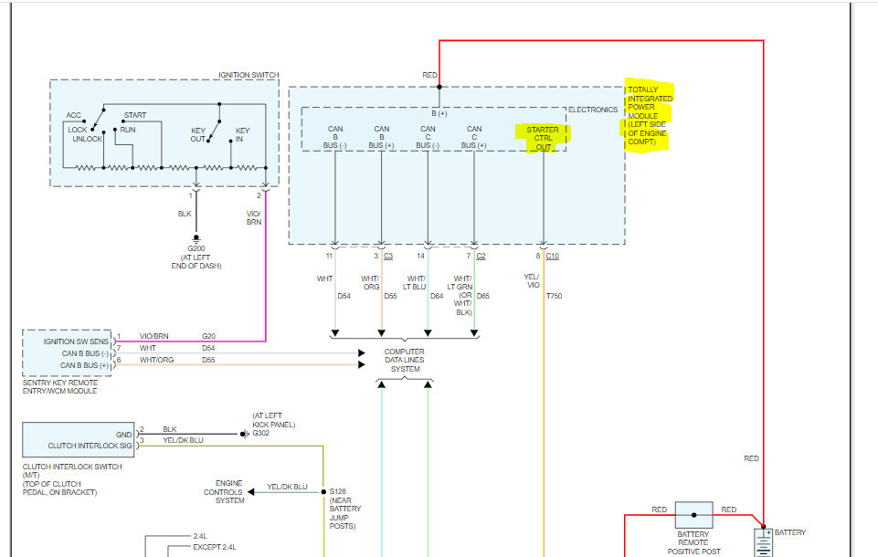

A misfire is common, but the starter issue isn't. Do you mean after the engine was running, the starter engaged by itself and then didn't stop turning the engine for approximately 10 to 15 seconds later?
This vehicle has what is called a totally integrated power module (TIPM). The TIPM is what triggers the starter when requested. (see pics below) It isn't uncommon for the connector pins to break, corrode, or fail at the connection causing problems.
Let me know if I correctly understood what happened with the starter so I know what direction to point you in

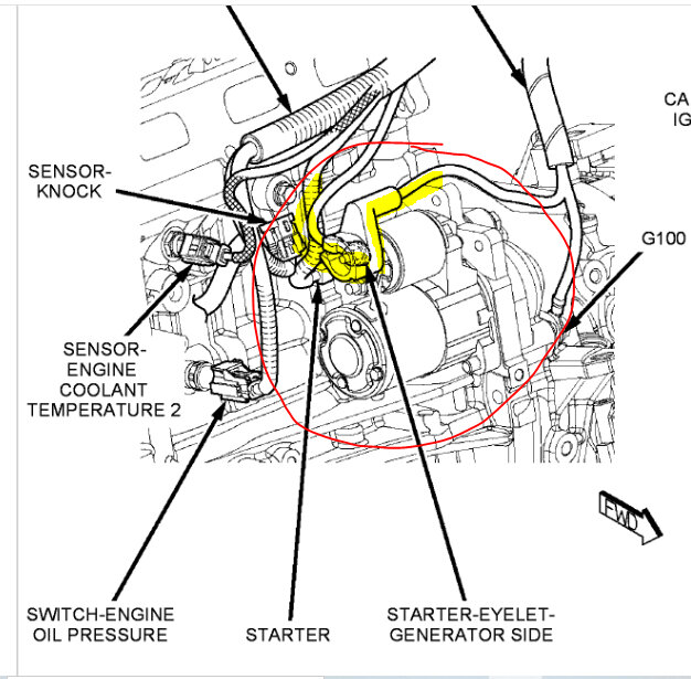

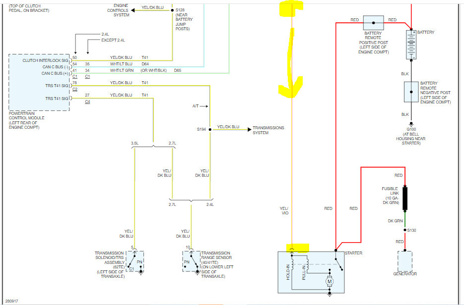

To me, that indicates power is being sent when it isn't wanted. If possible, locate the starter motor. You will find three wires going to it. Check both the condition of the wiring's insulation (rubber part covering the wire itself) and make sure both connections are tight and not able to touch each other at any point.
The red wires at the starter have power at all times. The smaller yellow wire only should have power when the key is in the start position. If in some way the red wires are able to short to the yellow wire, the starter will engage. Where the wires connect on the starter is a cover. (see pic below) Confirm that isn't melted. I've seen them melt, and come loose, and this happens, but that is not in any way a common occurrence. Do not disconnect anything at the starter without first disconnecting the negative battery terminal at the battery.
If there are no issues at that point, then my first suspect is the TIPM as previously mentioned or the connector at the TIPM.
Let me know what you find.
joe
See pic below
