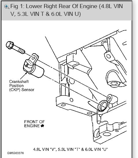

is this a V8? engine stuff doesn't come through on the new site here? if it is do a wiggle test on crank sensor and cam sensor the connector may be bad. Otherwise I have no other suggestions.
Jan 13, 2016 at 10:28 PM
JIMMY D JOHNSON
  • 10 POSTS
Yes it's a V-8 wear with those sensors be located thank you I appreciate all your help
Jan 14, 2016 at 12:19 AM
HMAC300
  • 48,601 POSTS
the crank sensor is on side of block by starter cam senslor top center of block at rear
Jan 14, 2016 at 1:16 AM
