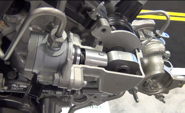

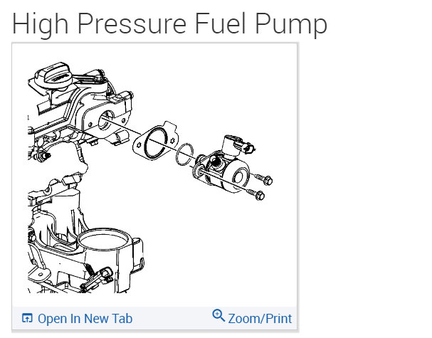

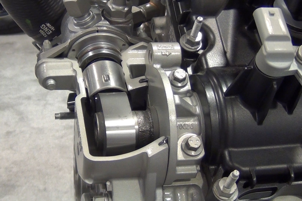

This is the first time I have heard of this problem, the high pressure fuel pump is driven from the camshaft on the engine for the direct injection system. Here is where the high pressure fuel pump is located and how the camshaft drives the pump, check the images below. Thank you so much for getting back to us.
