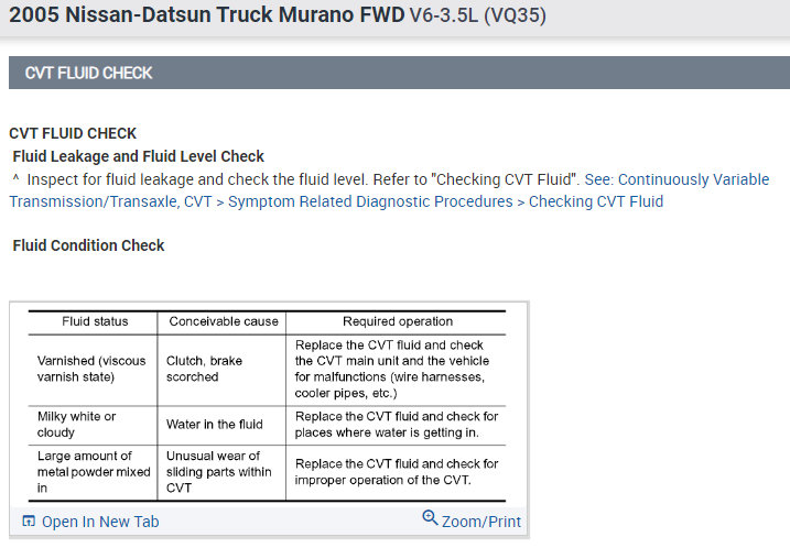

It sounds like an issue with the CVT transmission.
The howling you hear is the transmission, it can be due to worn out components.

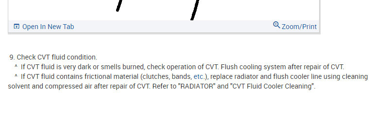

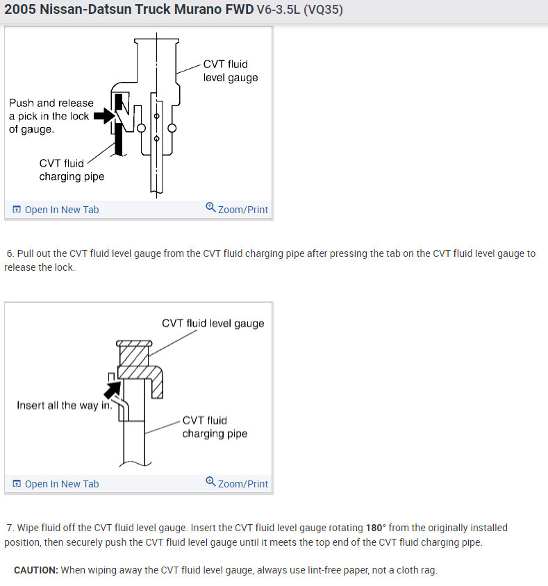

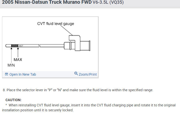

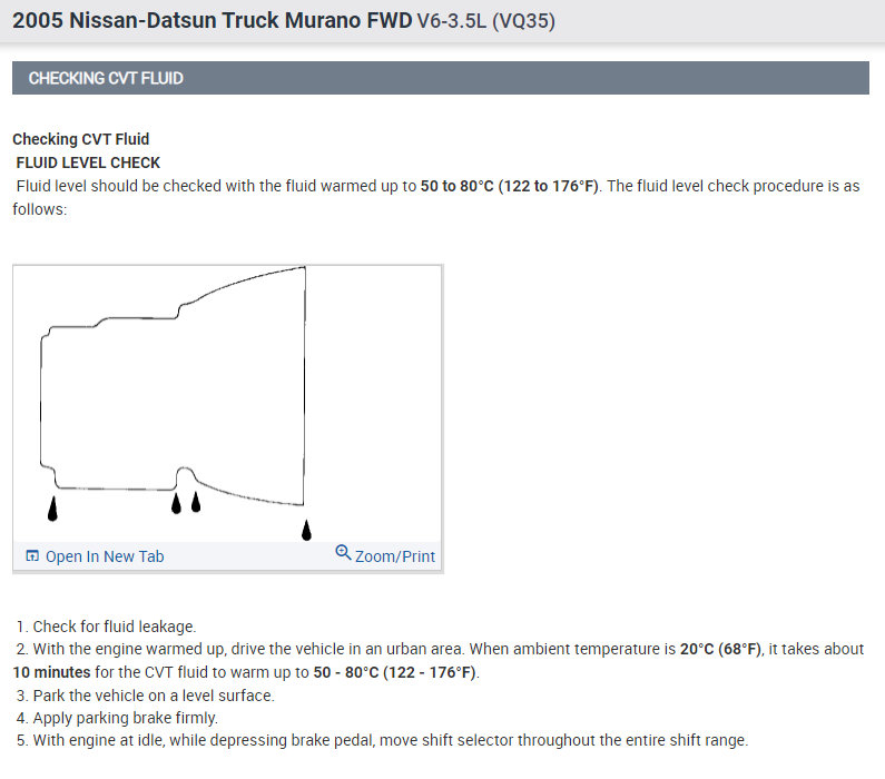

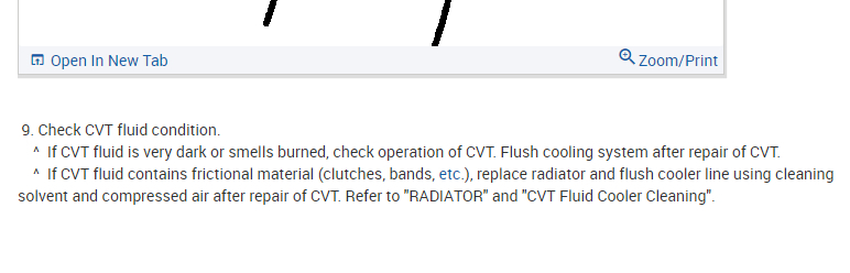

That noise can also be due to low or dirty transmission fluid.
Check the fluid make sure it is at a correct level and in good condition.
If the fluid level and condition checks out then the issue is likely internal.
It could be a worn out CVT belt inside the transmission or faulty pump.
