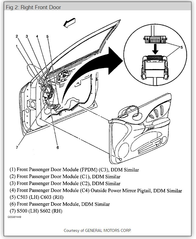

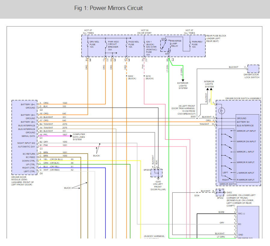

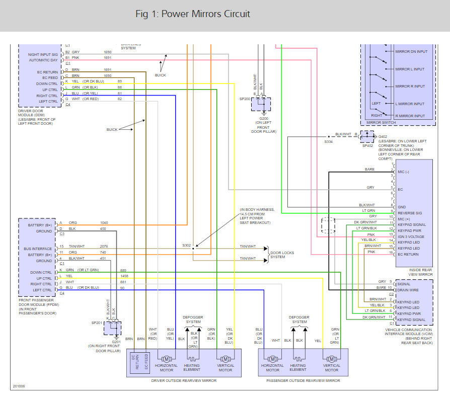

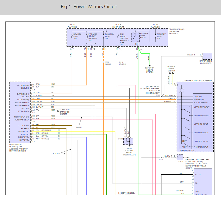

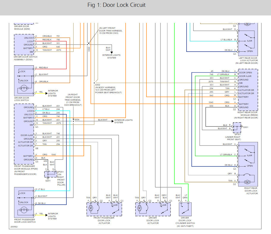

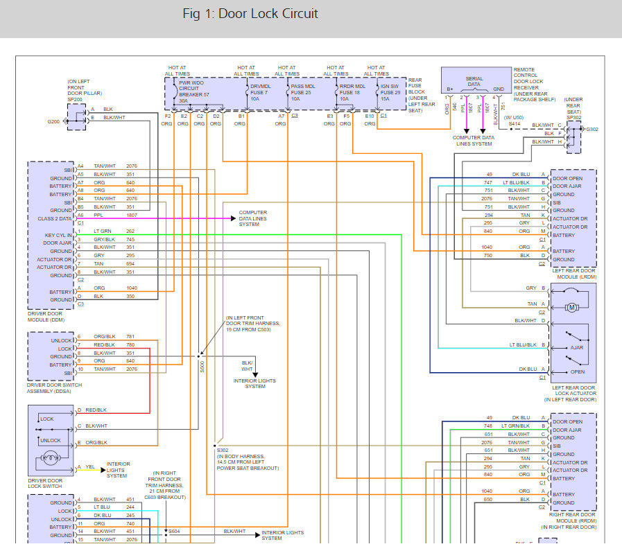

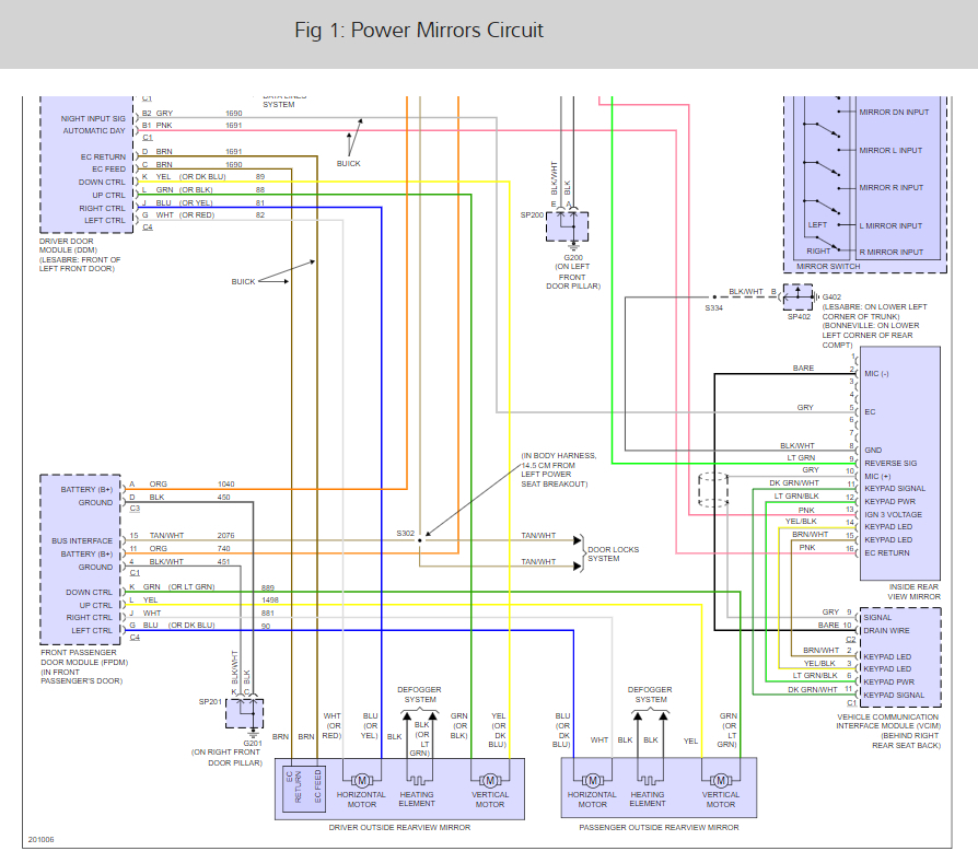

My power locks windows mirrors stopped working awhile back and my lights on the interior of my car only work when they want to and tend to stay on for a long time after I get out if they turn on. I checked all of my fuses and none of them are bad. Thank you in advance for your help.
Oct 21, 2018 at 5:14 PM
  • 54,178 POSTS
It sounds like the drivers side door module has gone out which is common here is the wiring diagrams so you can see how they system works and the DDM location. I would try to find a used one and plug it in to see what happens. If you need to get a new one it will need to be initialized by a shop should cost about $120.00 to have it done.
