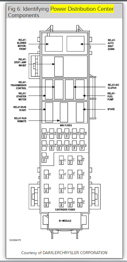

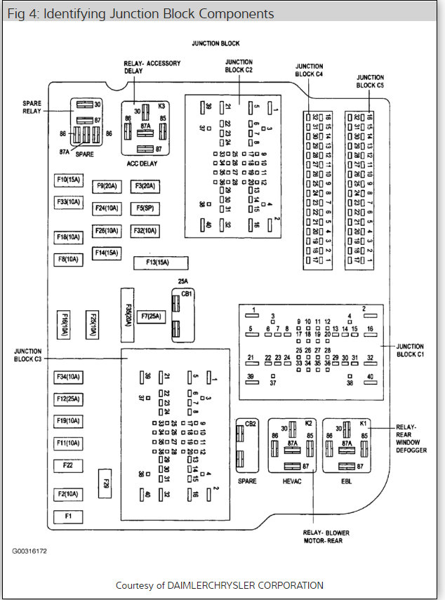

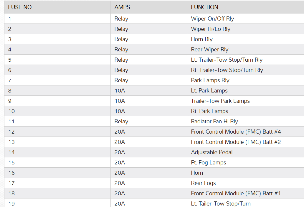

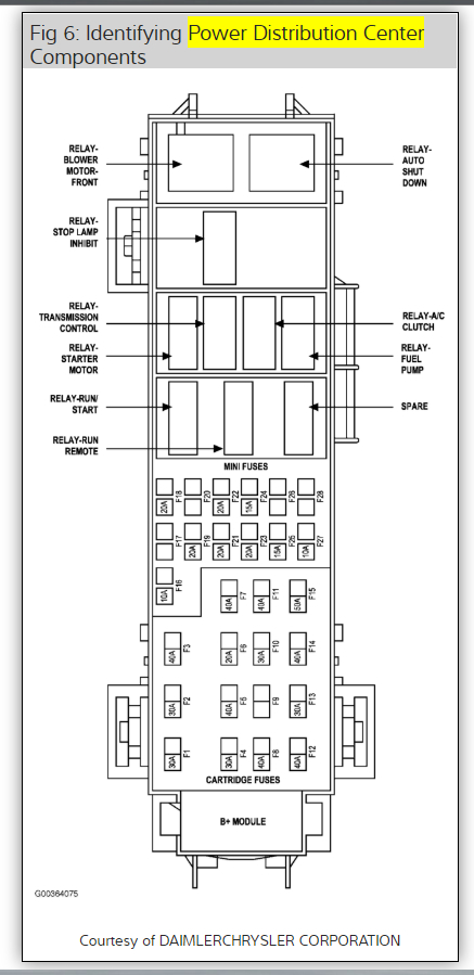

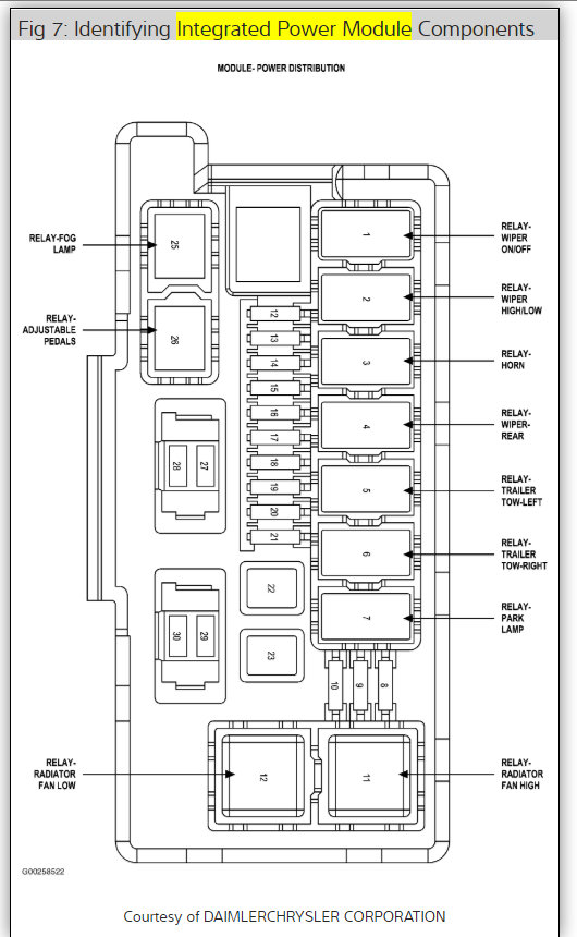

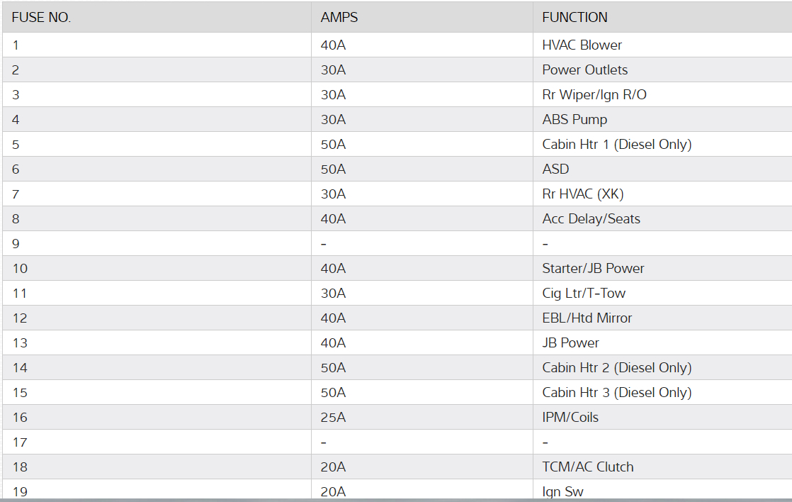

I can only lock and unlock the doors manually. The power locks on the arm rest and the FOB do not work. Windows work fine. I also do not have access to the back because the lift door will not unlock. Any ideas? The fuse looks fine on it.
May 3, 2018 at 12:46 PM
  • 55,224 POSTS

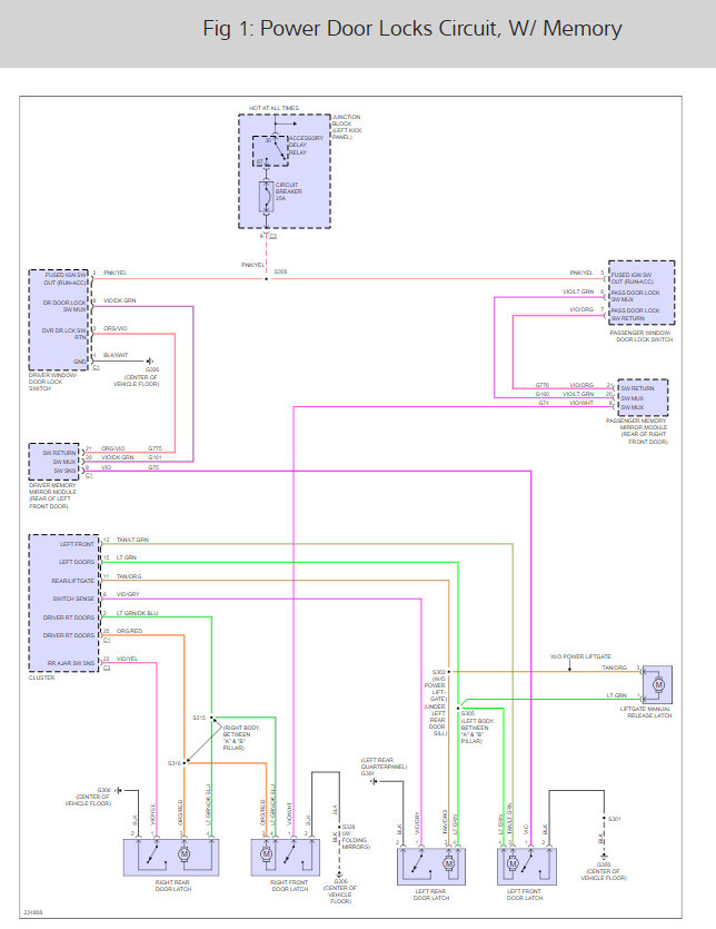

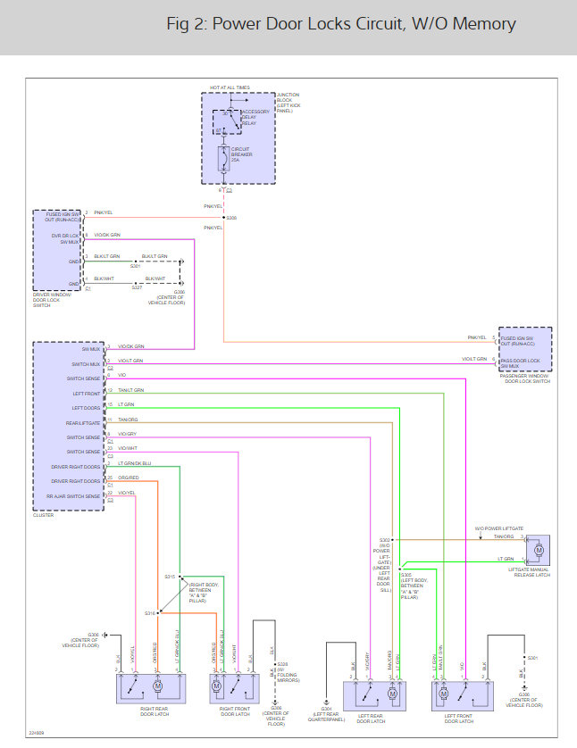

It sounds like you have an accessory delay relay that is not working. Here is a guide to help you:
Here is the door lock wiring diagram so you can see how the system works and the location of the relay.
