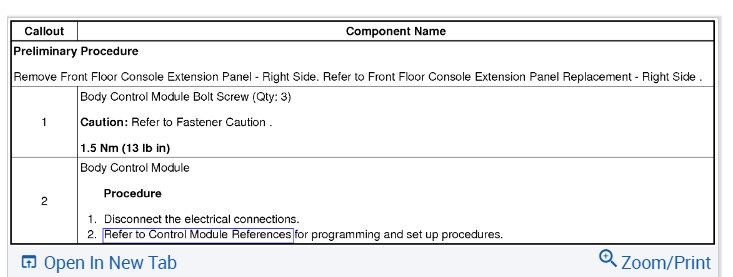

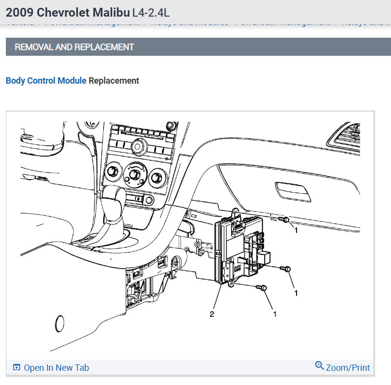

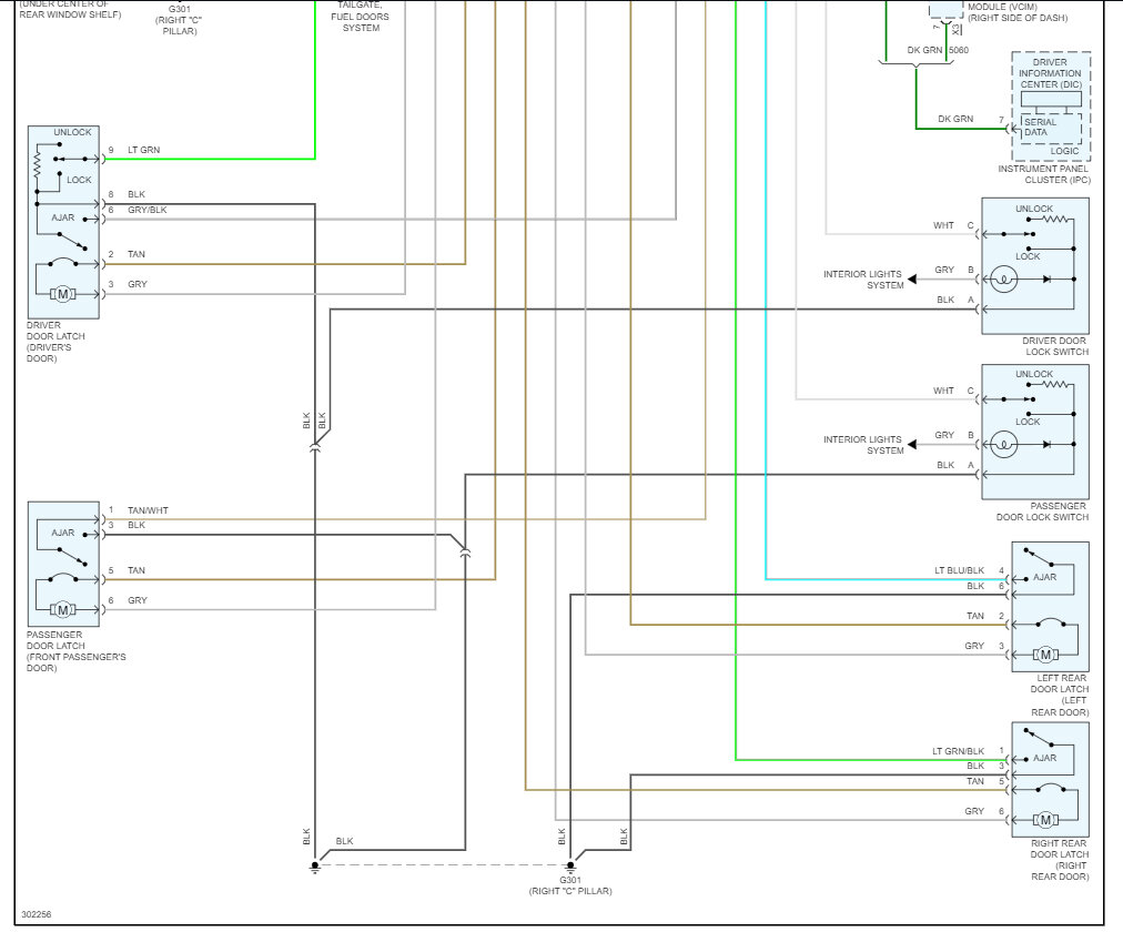

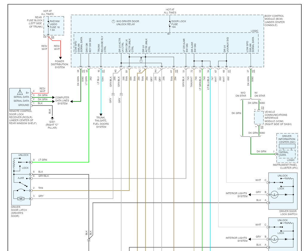

Here is how the door lock works in the door lock wiring diagrams below. Also, I have included how to change out the BCM as well, you can get a preprogrammed unit by searching Google or Ebay. Also let's check the system grounds, this guide can help:
Use the wiring diagrams to see the ground locations. Check out the images (below). Let us know what happens and please upload pictures or videos of the problem so we can see what's going on.
