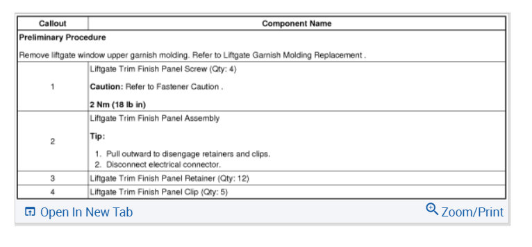

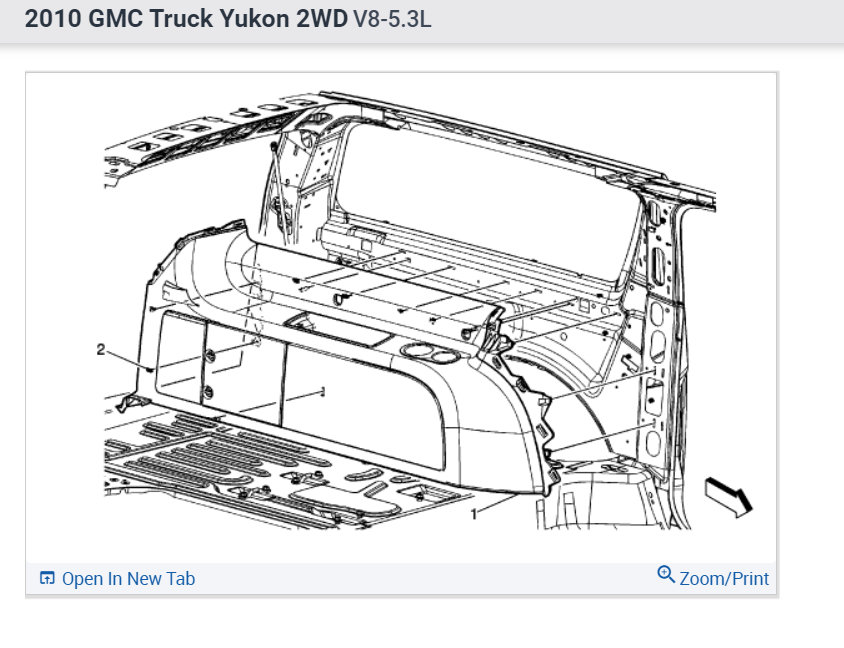

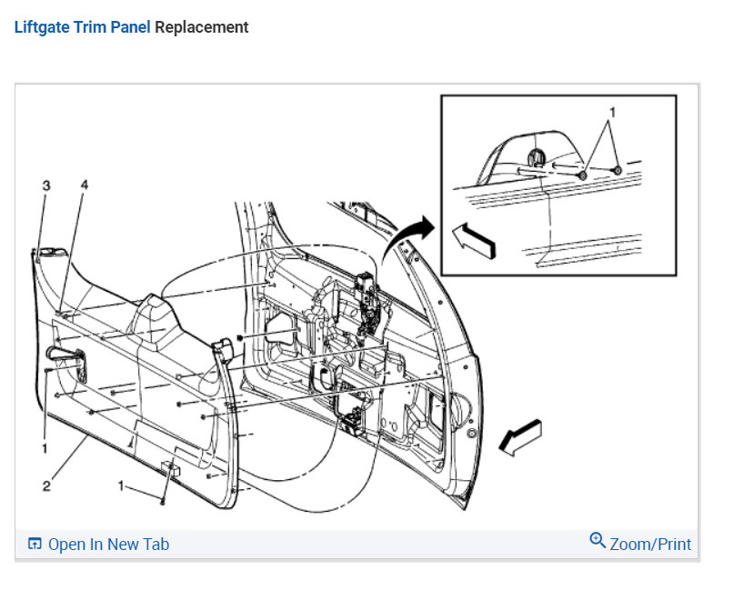

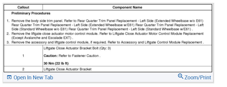

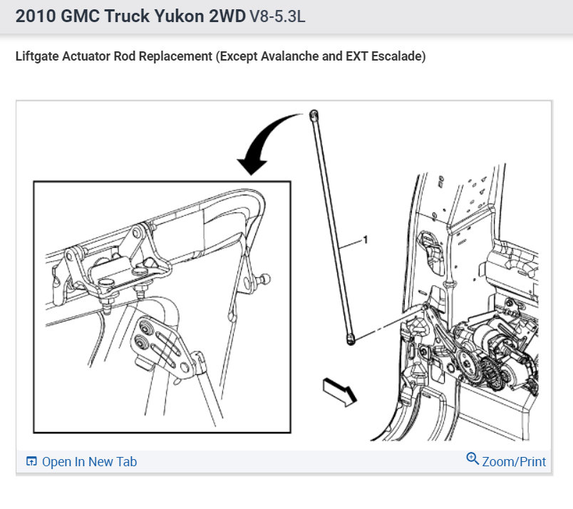

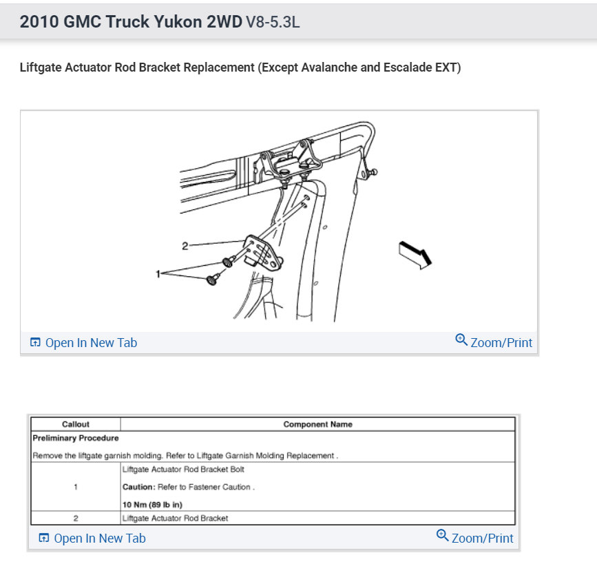

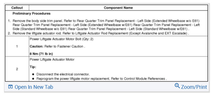

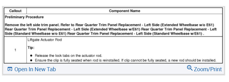

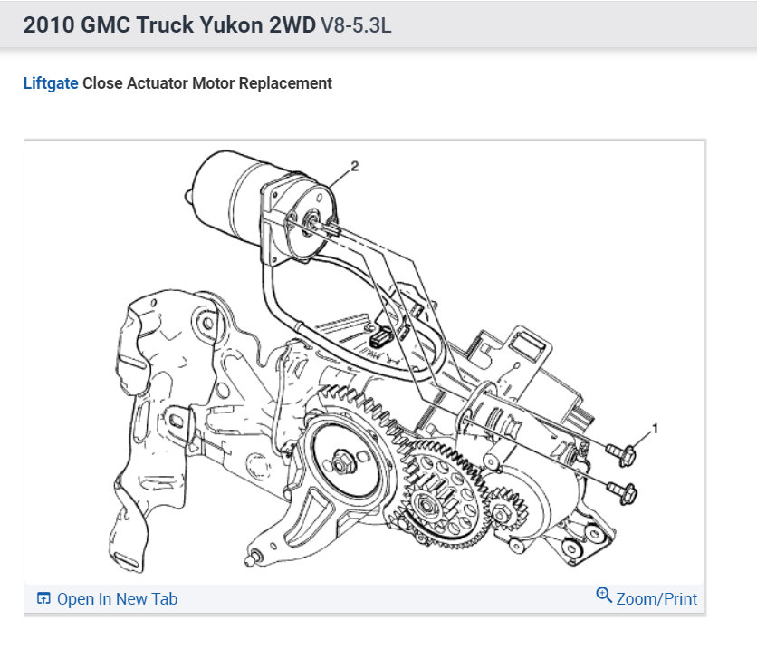

This happens when the liftgate motor locks up or the gear strips out not allowing the liftgate to move, you will need to undo the interior panel to get at the motor to disassemble. This can be a little tight, but the plastic will give and allow the job to be done. Check out the diagrams (below). Let us know what happens and please upload pictures or videos of the problem.

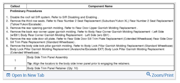

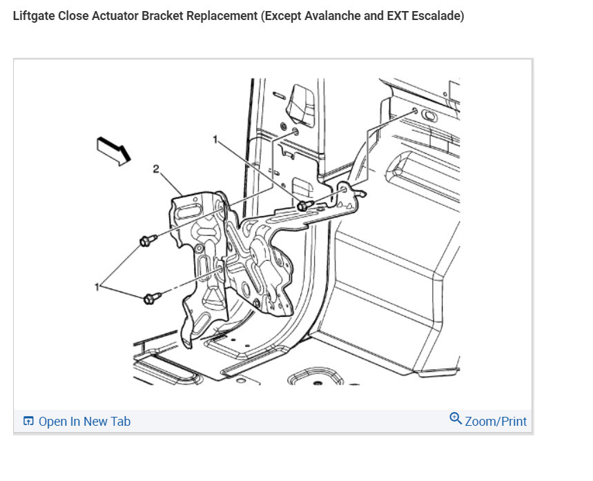

Yep, that's the hard part, you need to get in there and start undoing screws, the parts are plastic so they will give a little to be removed. I remember the interior guys removing the rear seats to help with the repair. Here are some diagrams to help you remove the panels.
