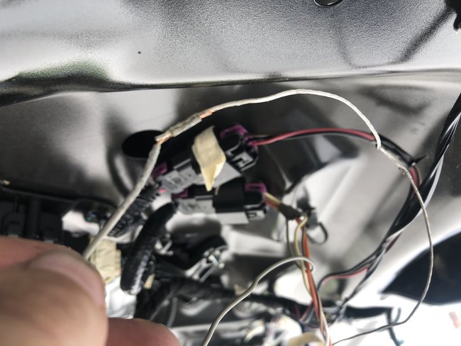

Power lift gate opens on its own when the vehicle is on or off and not locked

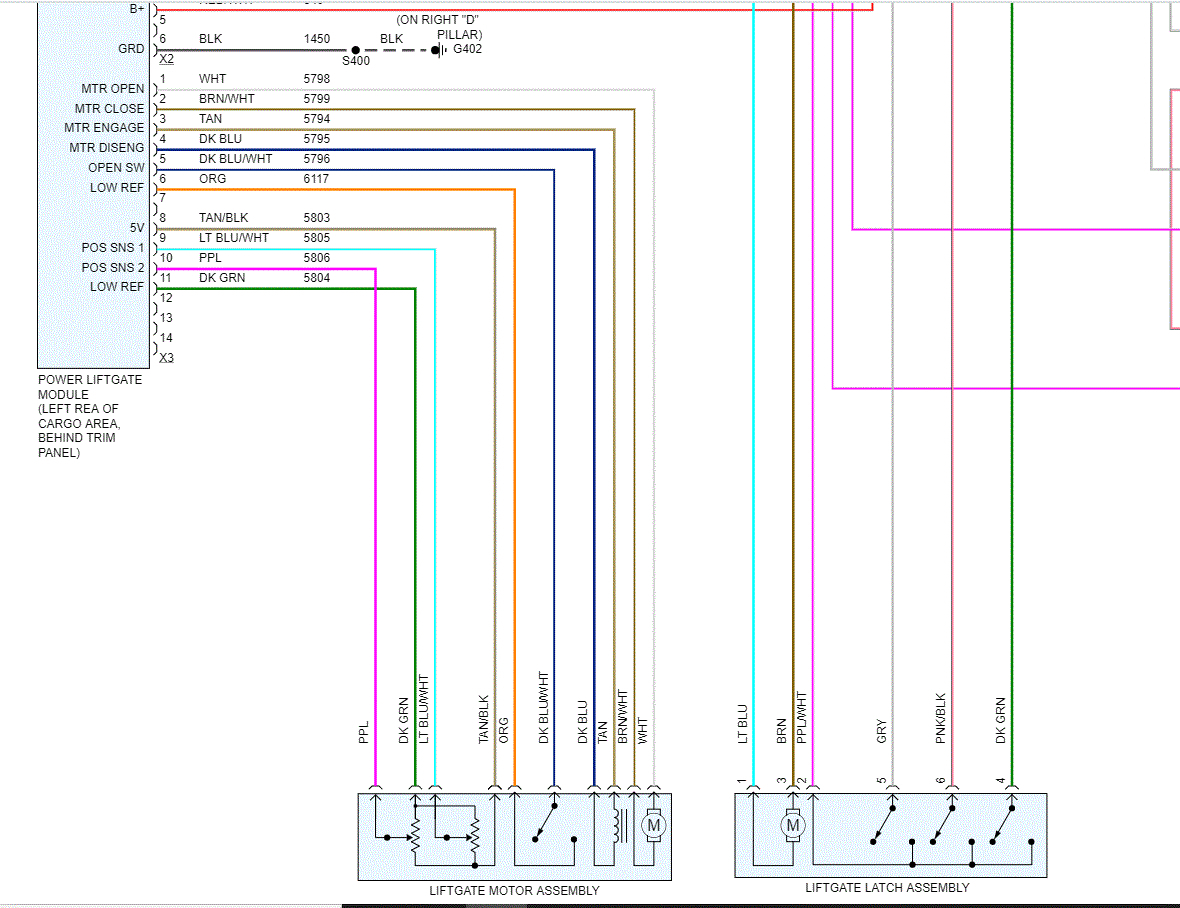

When the vehicle is locked it won’t open on its own. When it auto mode I can hear it cycle trying to lock when I put it in park.

There are several different technical service bulletins related to the power lift gate malfunctioning in various ways. The issues seem to all stem from the wiring harness. What really needs done first is to check for diagnostic trouble codes. These codes are B codes which a basic scanner can't read.

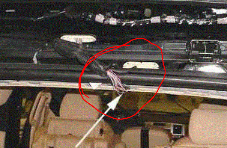

I am going to attach one of the TSB's for you to see. If you look at the first picture below, I circled the area where I believe you have a problem. You can inspect it yourself for anything that is obvious. The remaining pics correlate with this sample TSB.

Some customers may comment that the power liftgate opens about a third of the way and then reverses to the closed position. Other customers may comment that when the power liftgate is open, the liftgate starts to close about a third of the way and then reopens. The technician may find diagnostic trouble codes (DTCs) B153E-Liftgate Position Sensor Signal Circuit and/or B153F-Liftgate Object Sensor Signal Circuit set.
Cause
The cause may be a sharp sheet metal edge inside the inner roof panel chafing the liftgate wiring harness.

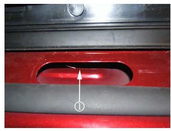

7. Remove the wiring harness pass through retainer, wiring harness, C405 connector and the washer hose from the roof panel.
pic 2
8. Visually inspect the liftgate wiring harness as shown above and repair any damaged wires. Refer to Wiring Repairs in SI.

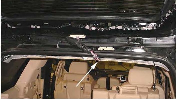

9. Install a piece of Kent-P92565, wire harness wrap 18 mm (3/4 in) inside diameter (I.D.) by 145 mm (5-3/4 in) length or equivalent flexible conduit to the liftgate wiring harness.
pic 3

Check the wiring I indicated first. If you see nothing that could be causing the problem, have the computer scanned and let me know what codes are found.
Take care and let me know if you have other questions.

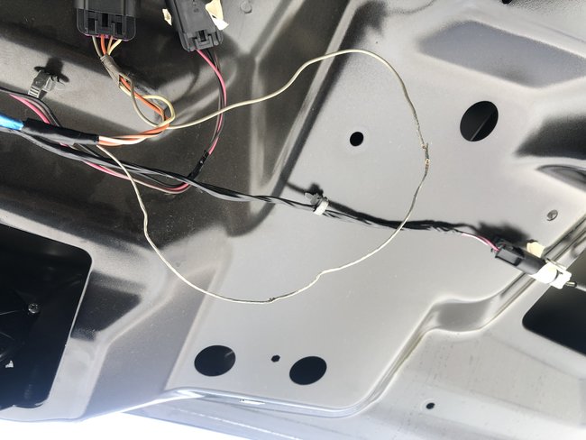

I checked the location you described and there does not appear to be damage. however, I followed the wires to the motor in the tailgate and found what appears to be a bare wire that had duct tape wrapped around the connection part. Could this be the issue and if so what do recommend as a fix?
May 13, 2020 at 4:58 AM
  • 110,244 POSTS

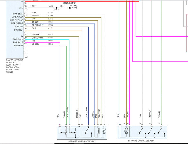

Yes, that can be a problem. The white wire is power to the motor open (see pic attached). Tape it with electrical tape so it can't short. Let me know what happens. Also, confirm that it is running between the motor and the lift gate control module.

Taped it and seemed to fix the problem. thank you for the help.
