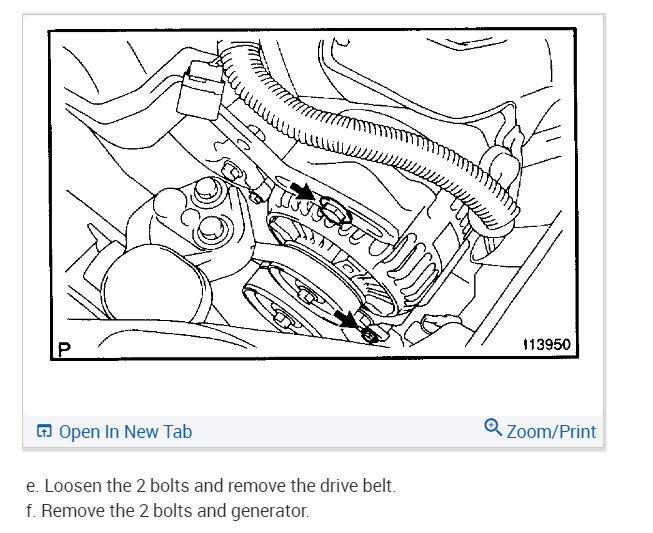

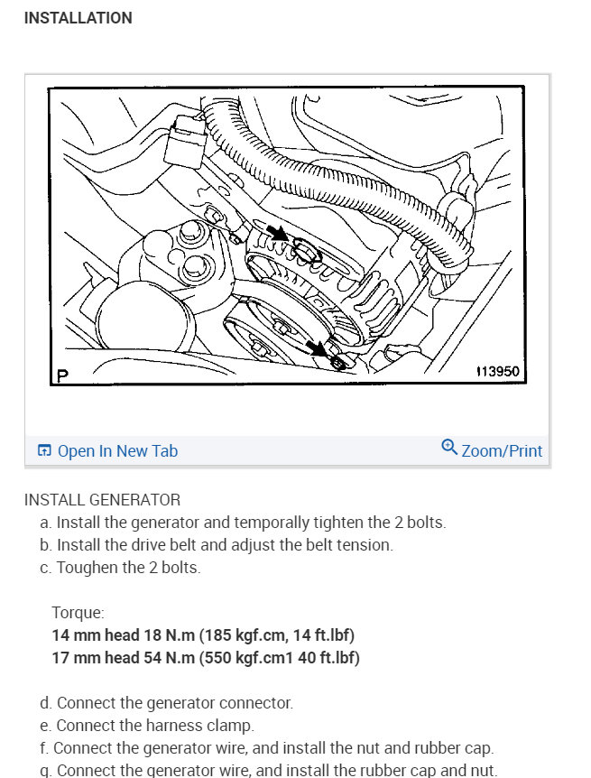

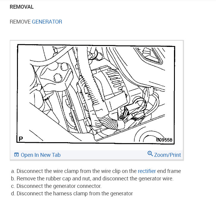

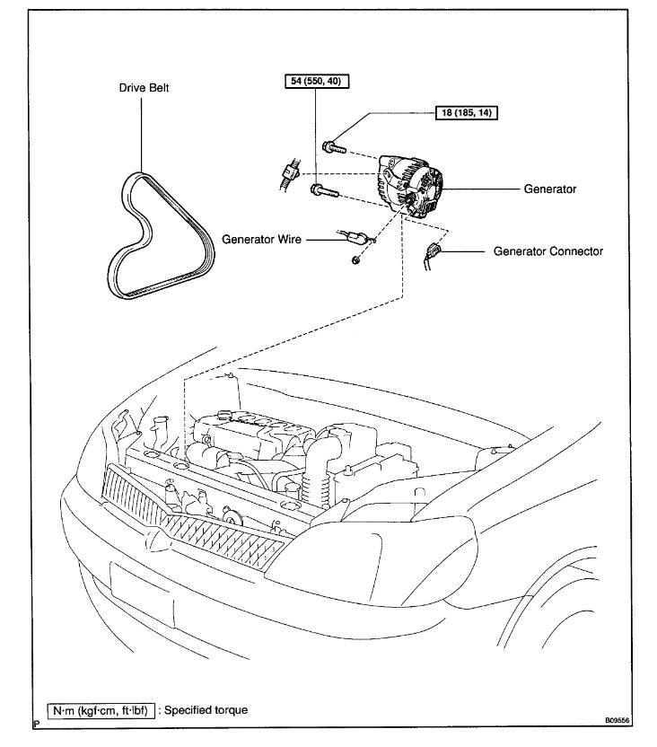

It sounds like the alternator is not working, to be sure this guide will should you how to check it using a voltmeter. Also, if the alternator is bad, I have included the instructions in the diagrams below to show you how to change it out.
