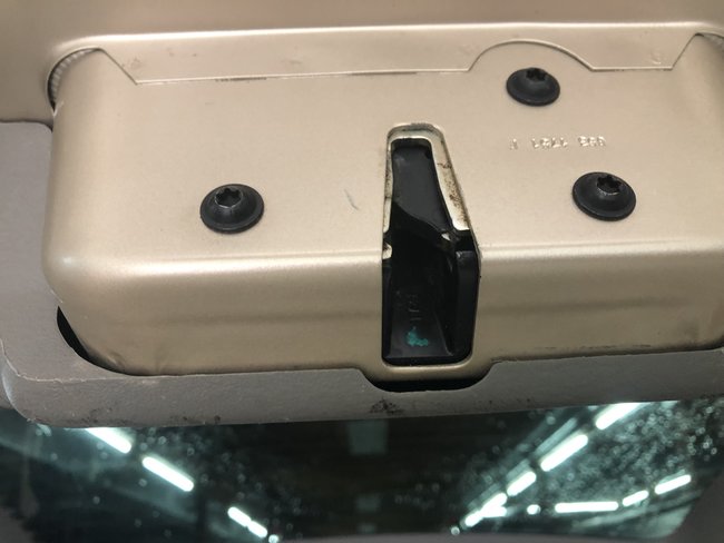

As the videos show, if you hit the power gate button you hear the beep as well as some unlatching but it doesn't open. And even after doing so and going to the back to lift it manually it won't open. Pressing the button under the trunk gate does the same thing, you hear something, only way to open it is with the key. Sometimes it is a bit unlatched but it still won't open manually. So my guess the motor is good cause i hear it but the latch is bad?

From the description and the video it looks like the rear lift gearing has failed. To get access to it you need to remove the left side D-Pillar trim panel, that is the one all the way at the rear between the floor and ceiling. To remove it you remove the trim strips across the top and the bottom of the rear hatch, then remove the seat belt loop on short wheelbase and the bolt holding the seat belt on the long wheelbase vans. Then the panel pulls free of the clips. Disconnect the speaker if needed.
With that out of the way you will see the motor assembly on the pillar. remove the wiring and then unbolt the lift assembly and lift it up and out. Now you can inspect the gearing and the levers to see where the failure is.
The motor number is 5019036AA and looks like the below image. The plastic piece is a common failure as it the internal gear.
Replacement of the motor is done by unbolting the motor from the lift assembly and bolting on the replacement. Then you install it and use a scan tool to erase any fault codes from the liftgate module.

I see, but even with the motor being bad, why is the door not unlatched? I would think based on common sense that the gate should be unlatched and if the motor you talking about is bad then it will just stay there, but the gate is still latched. And like i said only way to unlatch it so to turn the key, wouldn't you think a latch is a problem here?

The motor is supposed to pull a short cable that releases the secondary latch and then starts lifting the hatch up. Then once it comes back down the latch closes and the motor in the latch pulls the hatch down fully to the locked position. With the motor not assisting that second latch doesn't move enough to release it. The key bypasses the lift motor and the secondary latch so it will open.

When the motor assembly pulls a link to unlatch is that a mechanical cable or electronic? I don't see any cables, but before i remove the assembly i looked at the mechanism, can you see if anything in the videos doesn't look right?

Okay, the lack of the gas struts likely overstressed the motor. It's really nothing more than a seat motor with different linkage. The beeping should sound and then the motor lifts the gate. It also looks like the gearing needs a bit of lube. The drive gear should move away from the drive pinion when you lift the gate manually, that is part of the emergency system so you can yank the interior handle to open the hatch even without power. Yours might be the later version that repurposed the release cable to the hold open latch. They changed them a couple times when they had problems with the gates staying up. With the new struts and getting the motor to work, should take care of it, oh and add some white lithium spray into the latch and those drive gears.
