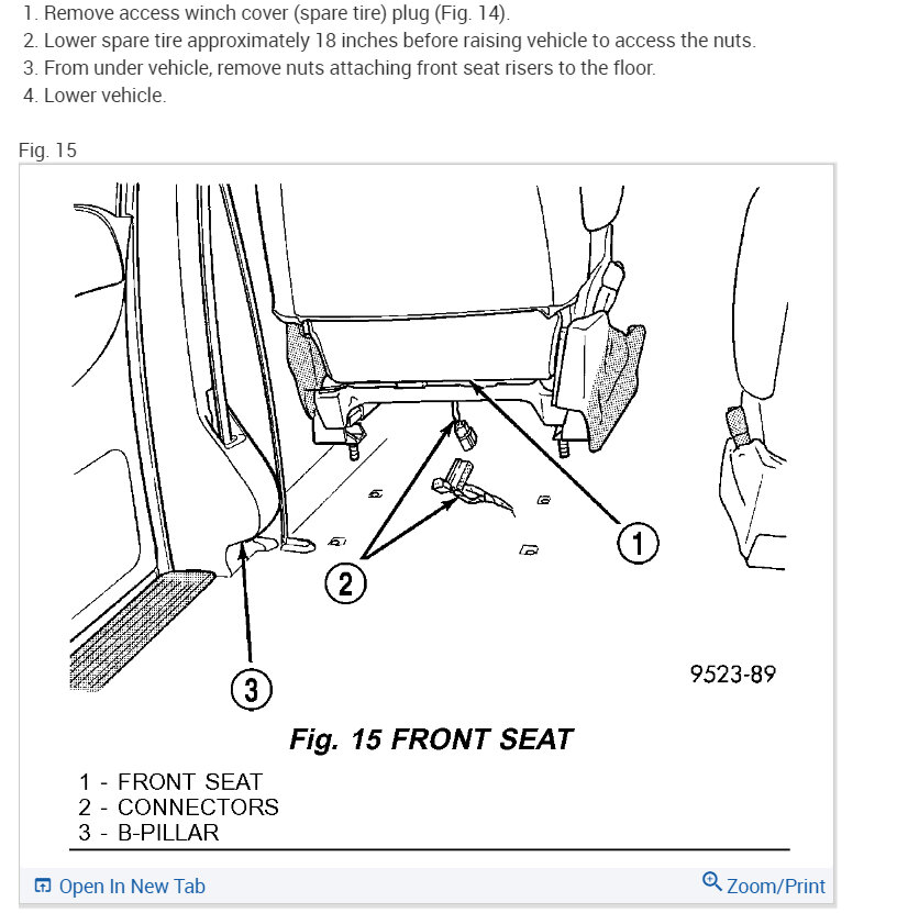

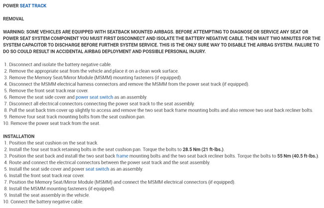

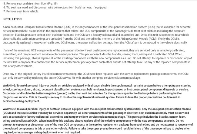

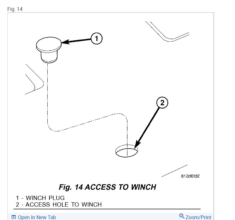

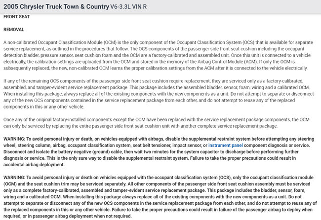

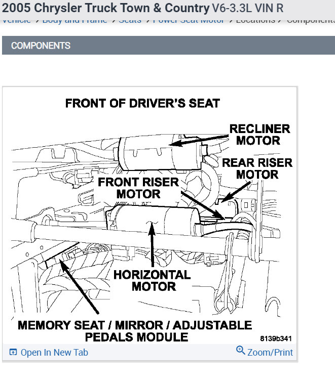

The drivers side slide seems to move forward and reverse until passenger side slide on seat does not move at all seat racks back and forth because only one side slides.
Jul 14, 2023 at 6:40 AM
  • 55,628 POSTS

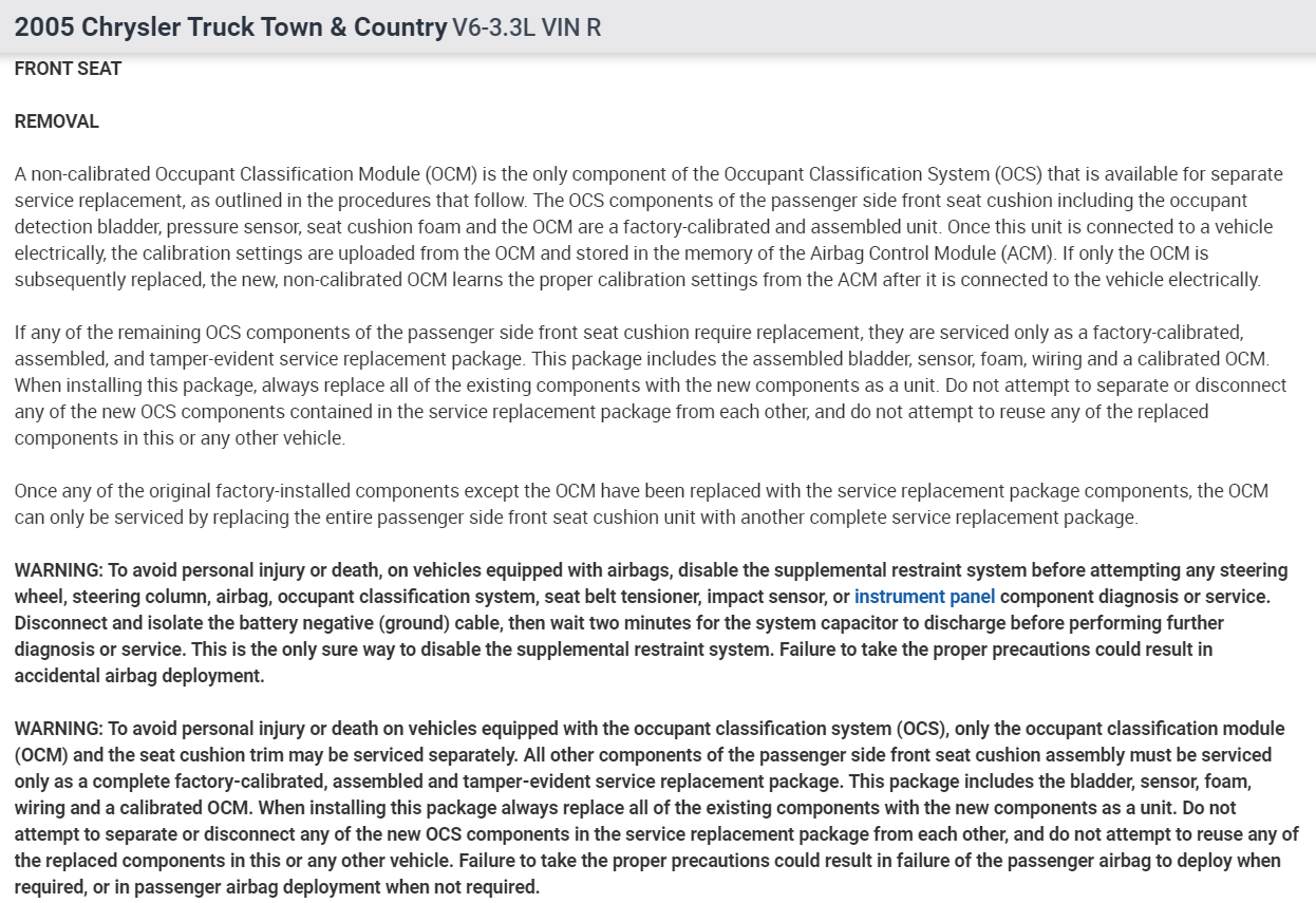

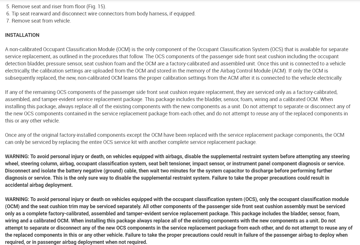

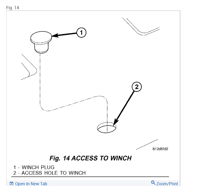

So, what happens is the seat drive is broken off of one side of the seat motor so you will need a new one. Here is how to remove the seat and change out the drive motor. Check out the images (below). Let us know what happens and please upload pictures or videos of the problem so we can see what's going on.
