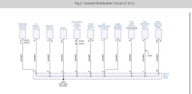

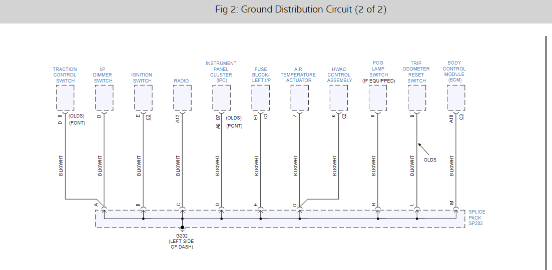

Have a power draw. Just started pull the bfc battery fuse 10 amp on driver side dash fuse location stops 90% draw this is on maxi fuse l/h bec battery 2. then pull fuse radio battery on passenger side to stop all voltage draw this is on maxi fuse r/h bec battery. Now my question is, where are the ground location at for these so i can check and make sure they are good? Best i can find is g202 but i do not know where that is located at or if i am even on the correct one.

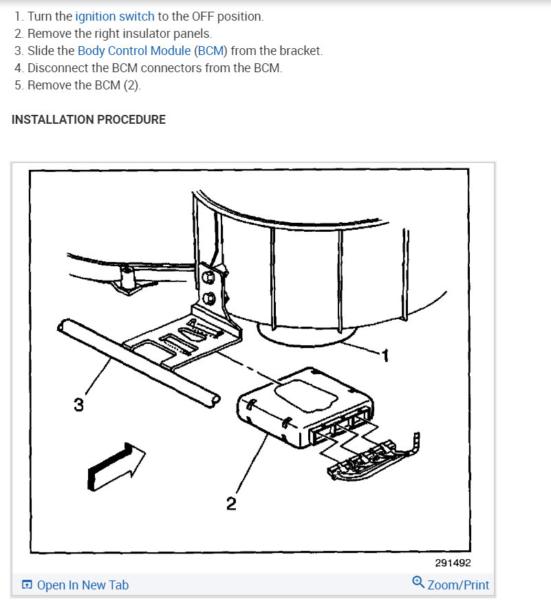

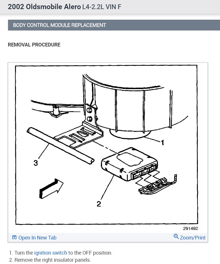

If I could jump in here, the BFC fuse runs the BCM which could have an issue causing the battery draw. Here is the wiring diagrams for the BCM and ground wires. If it checks out I have included the BCM replacement instructions as well. The ground wire is under the dash on the left side. (check the diagrams below)
1. The body control module BCM must be programmed with the proper RPO configurations. The BCM stores the information regarding the vehicle options and if the BCM is not properly configured with the correct RPO codes, the BCM will not control all of the features properly. Ensure that the following conditions exist in order to prepare for BCM programming:
^ The battery is fully charged.
^ The ignition switch is in the ON position.
^ The Data Link Connector (DLC) is accessible.
^ All disconnected modules and devices are reconnected before programming.
2. To setup a new BCM, access the SPECIAL FUNCTIONS menu on the scan tool to program the BCM. Select NEW BCM SETUP and follow the instructions on the scan tool.
3. If the BCM fails to accept the program, perform the following steps:
^ Inspect all BCM connections.
^ Verify that the scan tool has the latest software version.
Passlock Learn Procedures
IMPORTANT: If any module or device listed is replaced, programming of the module must be done prior to performing the Passlock Learn procedure.
Perform the Learn Procedure if any of the following components have been replaced:
^ The body control module, BCM
^ The Passlock sensor
Refer to Programming Theft Deterrent System Components in Theft Deterrent for the proper procedure.
^ The powertrain control module PCM
Refer to Powertrain Control Module (PCM) Programming in Computers and Control Systems for the proper procedure.
IMPORTANT: After programming, perform the following to avoid future misdiagnosis:
1. Turn the ignition OFF for 10 seconds.
2. Connect the scan tool to the data link connector.
3. Turn the ignition ON with the engine OFF.
4. Use the scan tool in order to retrieve History DTCs from all modules.
5. Clear all history DTCs.
