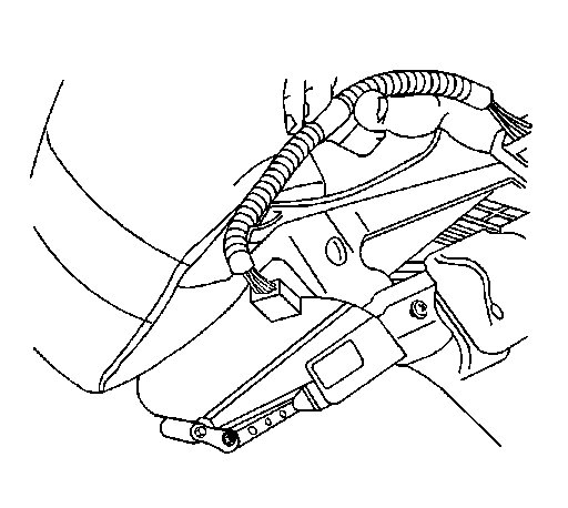

When replacing power seat switch under seat-does old switch just pry out?

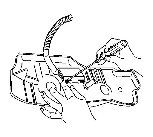

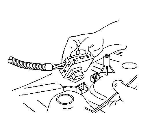

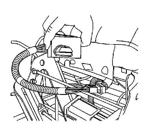

Here are the directions specific to your vehicle for switch replacement. All attached pictures correlate with these directions.
____________________________________________
SEAT SWITCH REPLACEMENT - POWER
Seat Switch Replacement - Power
Removal Procedure
1. Remove the outer trim panel from the front seat cushion. Refer to Seat Cushion Outer Trim Panel Replacement - Front Seat (See: Seat Cushion > Removal and Replacement > Seat Cushion Outer Trim Panel Replacement - Front Seat) .
2. Use a small flat-bladed tool to release the retainers which hold the power seat switch to the outer trim panel.
3. Remove the power seat switch from the outer trim panel.
4. Remove the power seat switch harness from the front seat support.
5. Disconnect the electrical connector from the power seat switch.
6. Remove the power seat switch.
