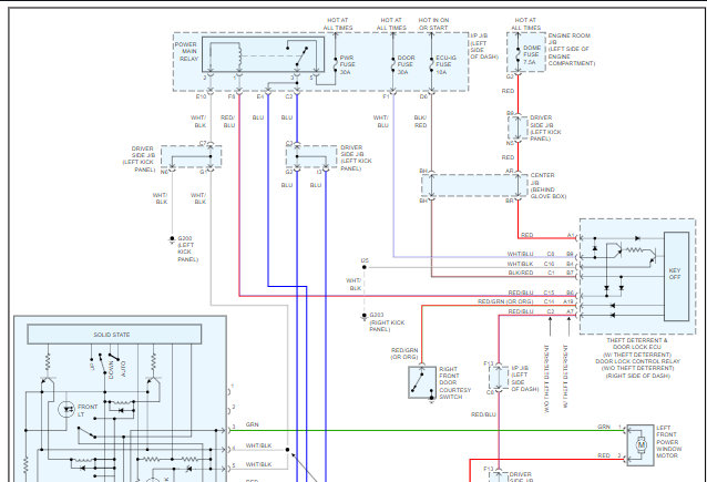

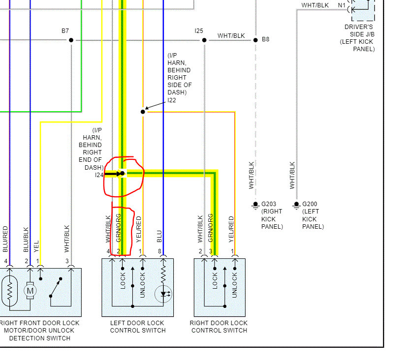

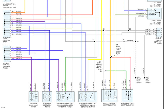

The first two pics are of the entire locking system. I had to break the pic in half to make it readable, but I did overlap it so you could follow it.
In pic 3, I circled two things. First, the green wire with an orange tracer should get power when you press the lock switch on the driver's side. You will need to remove the door panel to access this. I will provide directions for that next.
What I need you to do can be done with a test light. You will check to see if power comes out of the switch at that wire I mentioned. If there is power, I have a feeling the second thing I circled which is where the wires splice together, may be the problem. On the other hand, if no power is shown at that wire, then the switch is bad.

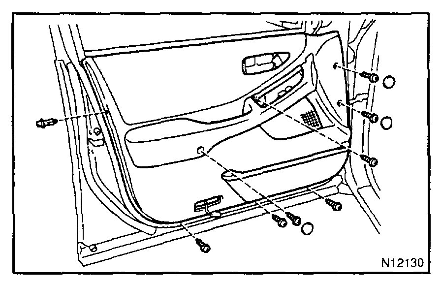

1. REMOVE INSIDE HANDLE BEZEL
2. REMOVE COURTESY LIGHT
3. REMOVE POWER WINDOW SWITCH
see pic 4
4. REMOVE DOOR TRIM
a. Using a screwdriver, remove the 3 caps.
HINT: Tape the screwdriver tip before use.
b. Remove the 7 screws and clip.
c. Insert a screwdriver between the door and door trim to pry the trim out.
NOTE: Be careful not to damage the door and door trim.
d. Pull the trim upward to remove it.
If you are able to access the switch wiring without removing the entire door panel, that is fine.

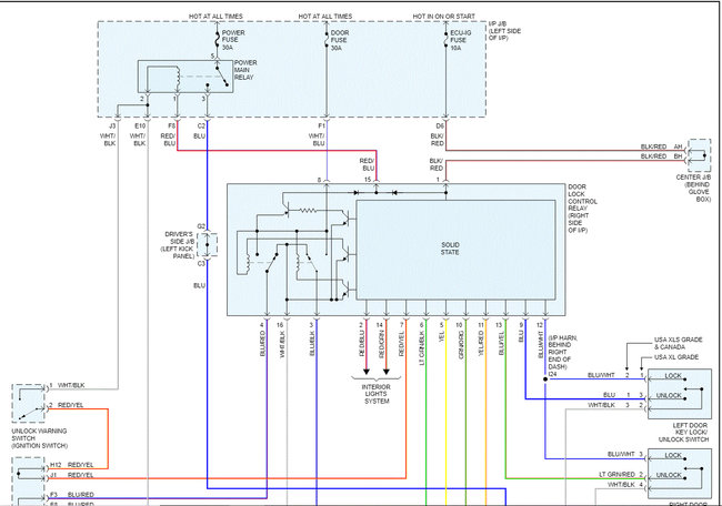

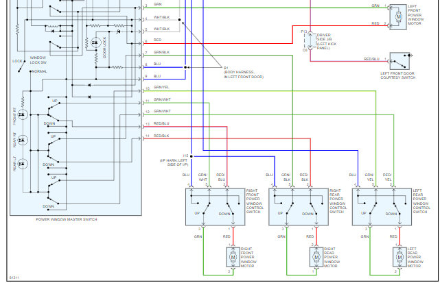

Can you please provide the wiring diagram for the power window system? They don't appear to be included in the diagrams you have provided? Thank you!
Jul 26, 2020 at 7:27 PM
DANNY L
  • 5,648 POSTS
Hello, I'm Danny.
Here is the power window wiring diagram you requested. I have cut the picture in half for you to view larger. If you need anything further let Joe or I know as we're here to help.Hope this helps and thanks again for using 2CarPros.
Jul 27, 2020 at 9:49 AM

Well, on the front passenger's side door, it is the blue wire. By the way, can you please provide a wiring diagram for the power window system? Thanks!
Aug 1, 2020 at 5:50 PM

If you scroll up in this thread I've attached a power window wiring diagram on a prior reply.Hope this helps and thanks again for using 2CarPros.

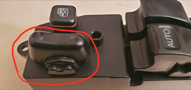

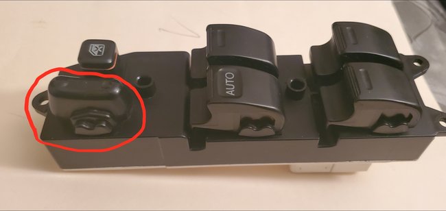

Can the lock/unlock switch button that is circled in red in the attached picture be removed? If so, how do I do it?
Thanks!
Cheers!
Aug 4, 2020 at 8:15 PM
  • 110,251 POSTS
They aren't meant to be taken apart. Under it is nothing more than a printed circuit board.
Aug 5, 2020 at 3:33 PM
