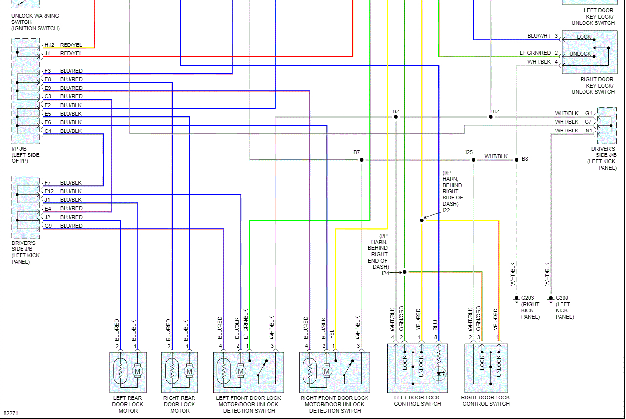

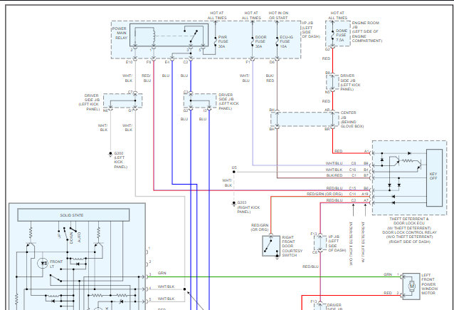

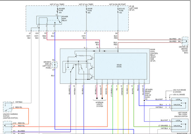

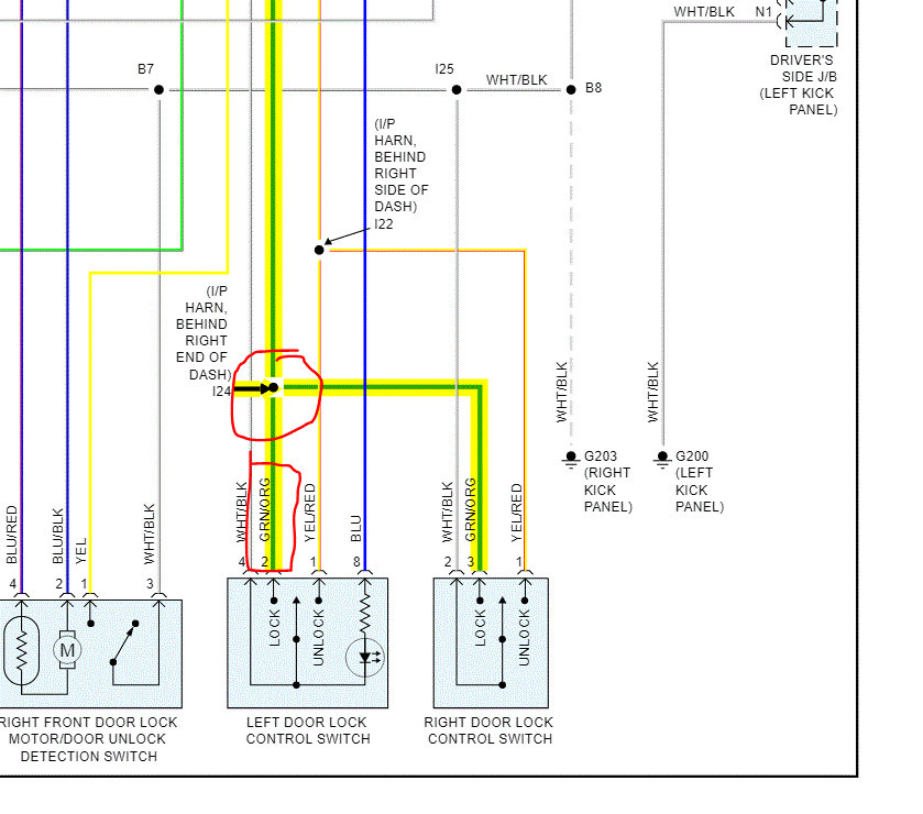

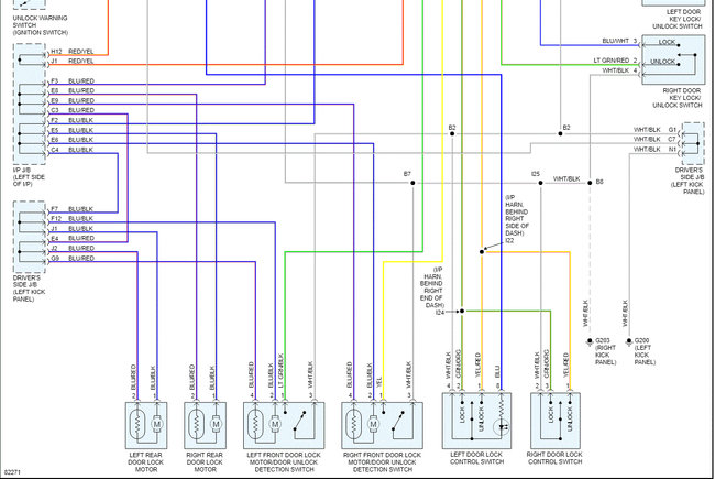

The first two pics are of the entire locking system. I had to break the pic in half to make it readable, but I did overlap it so you could follow it.
In pic 3, I circled two things. First, the green wire with an orange tracer should get power when you press the lock switch on the driver's side. You will need to remove the door panel to access this. I will provide directions for that next.
What I need you to do can be done with a test light. You will check to see if power comes out of the switch at that wire I mentioned. If there is power, I have a feeling the second thing I circled which is where the wires splice together, may be the problem. On the other hand, if no power is shown at that wire, then the switch is bad.

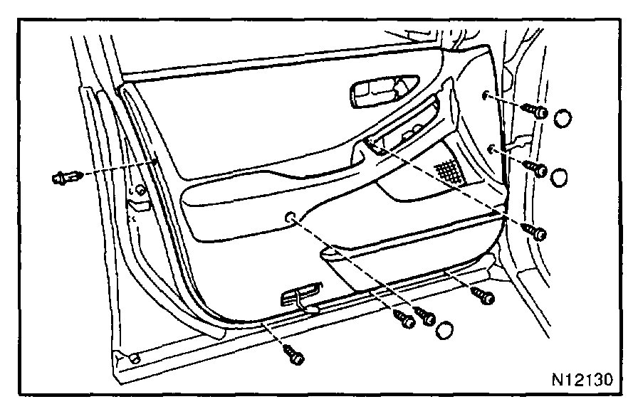

1995 Toyota Avalon V6-3.0L (1MZ-FE)
Procedures
Vehicle Body and Frame Doors, Hood and Trunk Doors Front Door Service and Repair Procedures
PROCEDURES
DISASSEMBLY
1. REMOVE INSIDE HANDLE BEZEL
2. REMOVE COURTESY LIGHT
3. REMOVE POWER WINDOW SWITCH
see pic 4
4. REMOVE DOOR TRIM
a. Using a screwdriver, remove the 3 caps.
HINT: Tape the screwdriver tip before use.
b. Remove the 7 screws and clip.
c. Insert a screwdriver between the door and door trim to pry the trim out.
NOTE: Be careful not to damage the door and door trim.
d. Pull the trim upward to remove it.
If you are able to access the switch wiring without removing the entire door panel, that is fine.

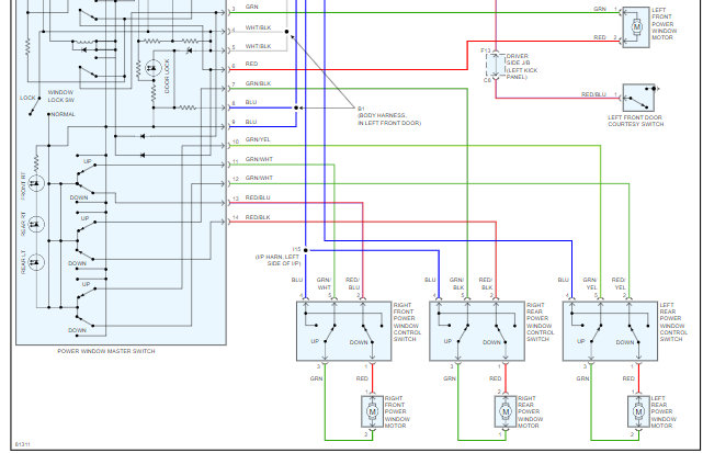

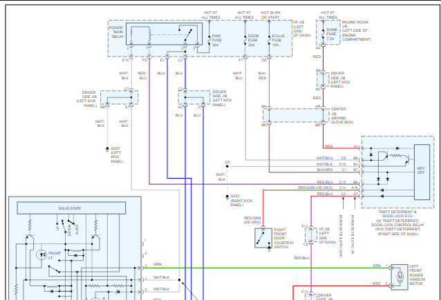

Can you please provide the wiring diagram for the power window system? They don't appear to be included in the diagrams you have provided? Thank you!
Jul 26, 2020 at 7:27 PM
DANNY L
  • 5,648 POSTS
Hello, I'm Danny.
Here is the power window wiring diagram you requested. I have cut the picture in half for you to view larger. If you need anything further let Joe or I know as we're here to help.Hope this helps and thanks again for using 2CarPros.

To resolve the issue with the power door lock on the driver's side, this is what I have done.
Unlike the rear doors, to access the switch panel assembly, the door panel does not need to be removed for the front doors. Then I removed the switch panel assembly and disconnected the wiring connector. Then I used a test light to back probe that wiring connector for the respective lock and unlock wires. Lo and behold, the test light was able to lock and unlock the doors. Hence, I was pretty confident that the issue must be from the switch panel, more specifically the circuit board. I then replaced the switch panel and everything is now operative. By the way, is there a way to fix the circuit board?

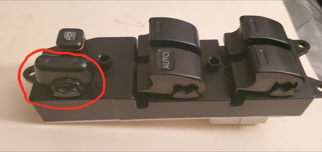

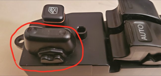

AVALON1995
  • 121 POSTS
Can the lock/unlock switch button that is circled in red in the attached picture be removed? If so, how do I do it?
Thanks!
Cheers!
Aug 4, 2020 at 8:15 PM
  • 110,244 POSTS
They aren't meant to be taken apart. Under it is nothing more than a printed circuit board.
Aug 5, 2020 at 3:33 PM

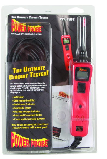

DANNY L
  • 5,648 POSTS
Hello again.
To answer your question, no. I would not advise taking apart or modifying the switch.The best tool to use when it comes to wiring issues is a Power Probe. It has way more testing capabilities than a test light.A Power Probe has a digital display and in addition to a positive and negative lead it also has a power cable that attaches to a vehicles battery.You can then have the ability by using a push button switch to actually apply voltage to a circuit or accessories to test function and get a voltage reading at the same time.Although test lights are handy this might by something to consider due to your current tricky wiring problem. I've attached a picture below of what they look like.Hope this helps and thanks again for using 2CarPros.
