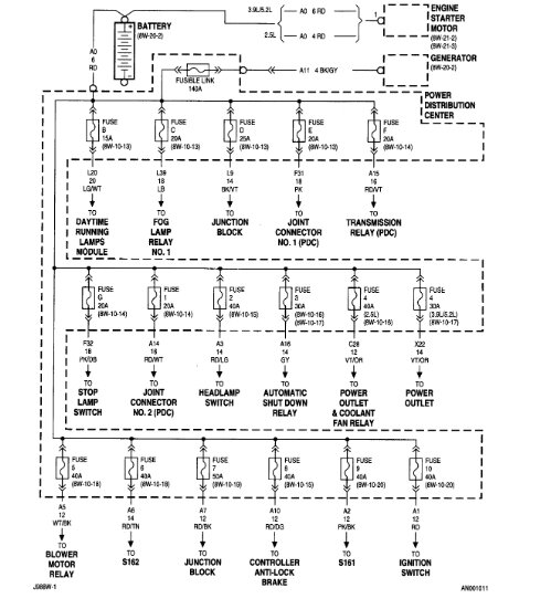

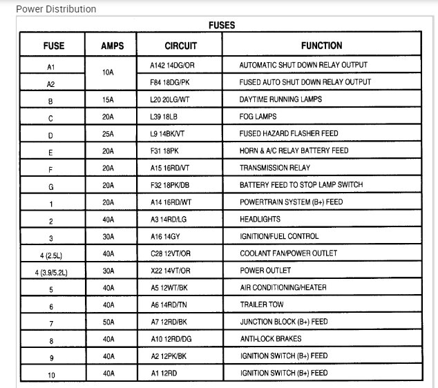

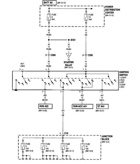

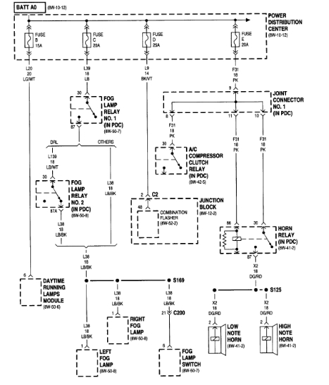

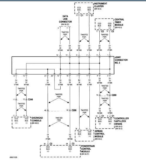

My power distribution center was cut out and I'm trying to wire a new one in and I don't know the wiring.
Jun 24, 2023 at 2:44 PM
  • 110,240 POSTS

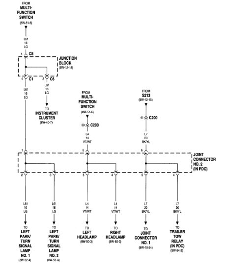

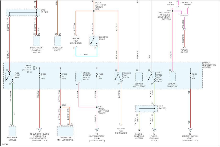

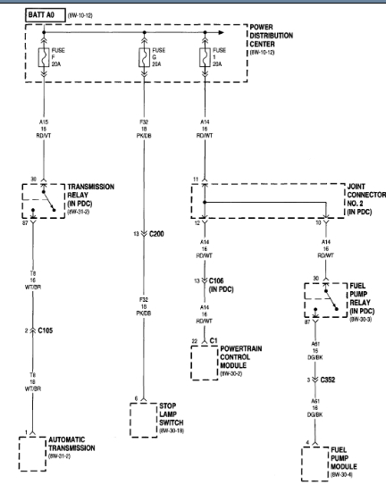

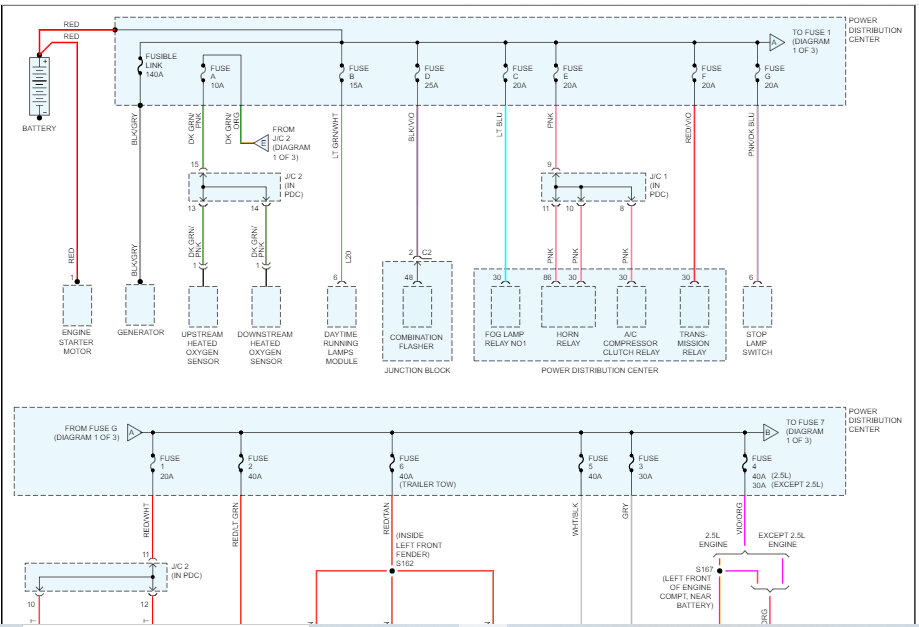

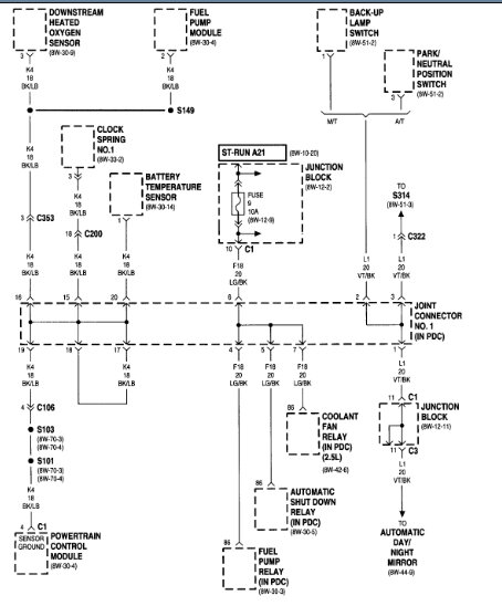

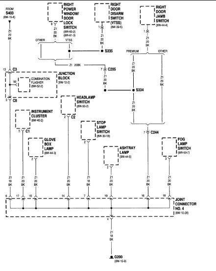

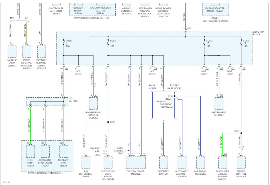

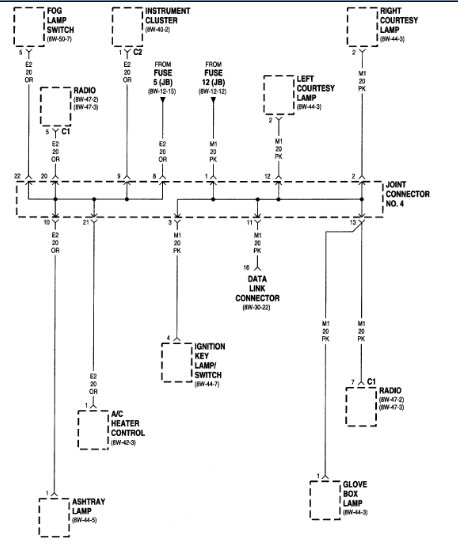

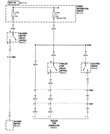

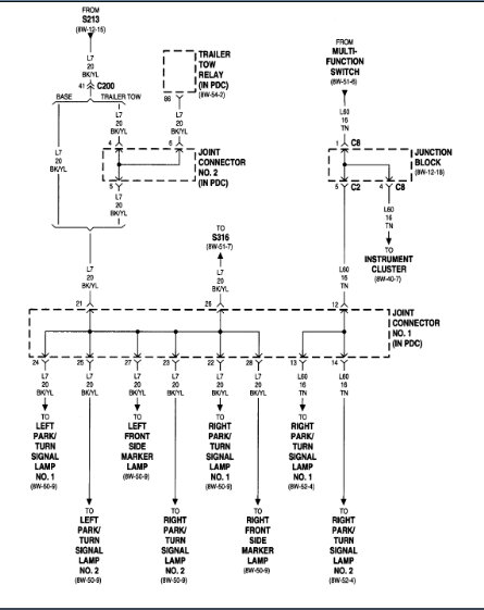

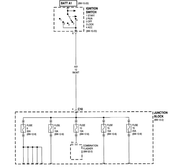

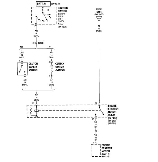

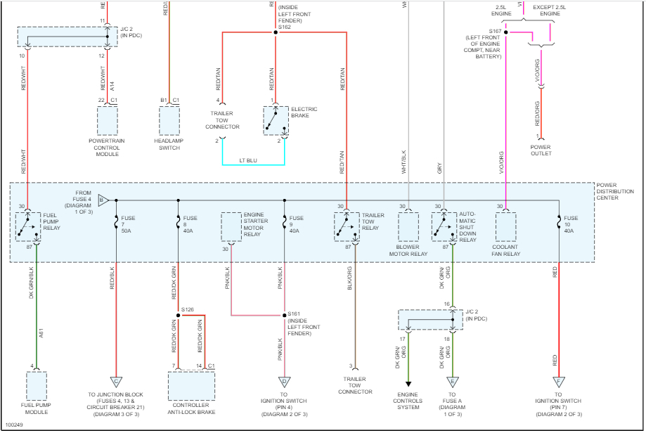

I'm not sure what would be more helpful. The power distribution schematics or something specific to the box itself. The only pics of the box wiring are from the factory and are difficult to follow. Plus, it is somewhat long.
Do me a favor. I attached the power distribution schematics below. These ones are in color, and I find them easier to follow. Take a look through them and let me know if they help or if you want the others.
Note that the schematics were three pages long. I had to cut each pin in half to make them readable. I did overlap them so you can follow from one to the next.
Let me know if this helps.
joe

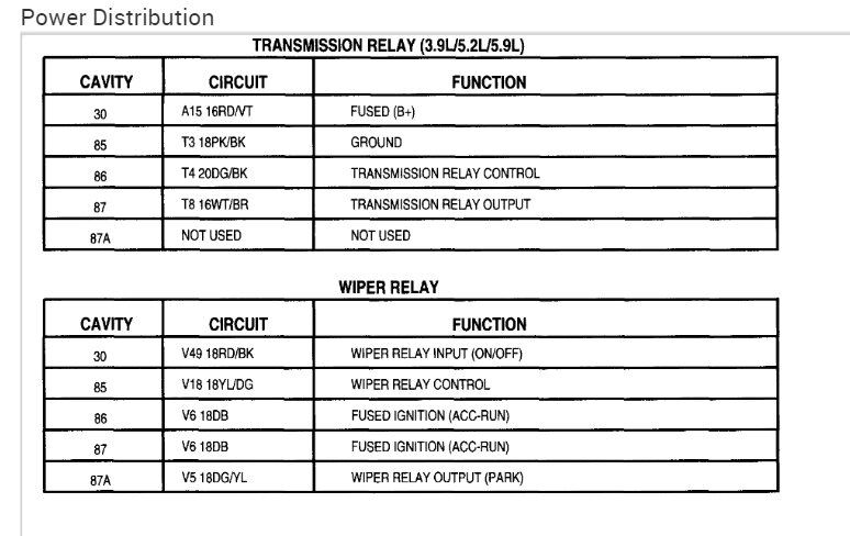

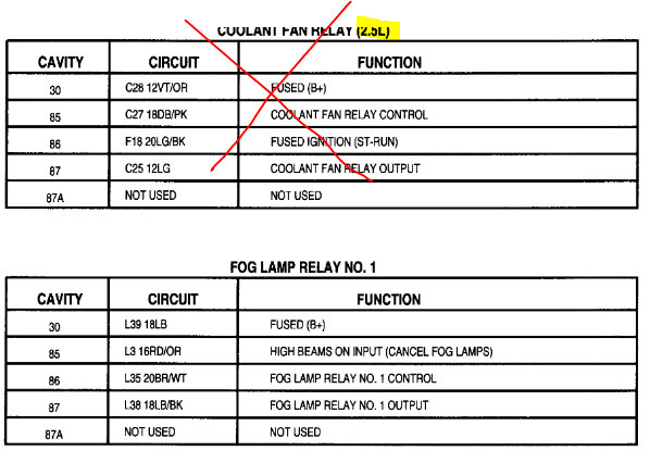

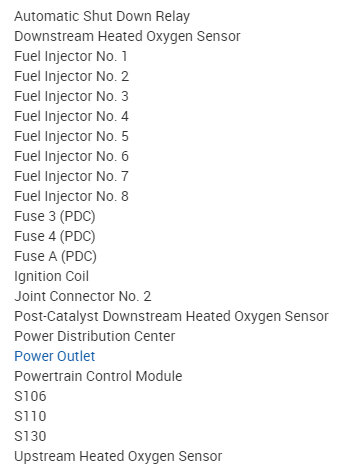

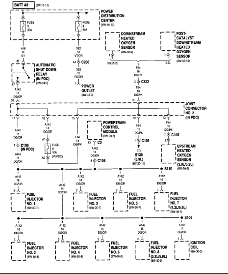

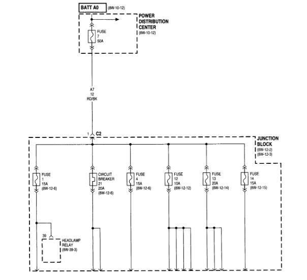

MARMAR0727

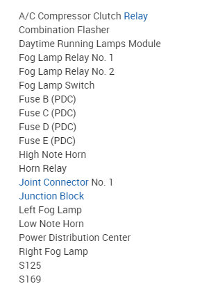

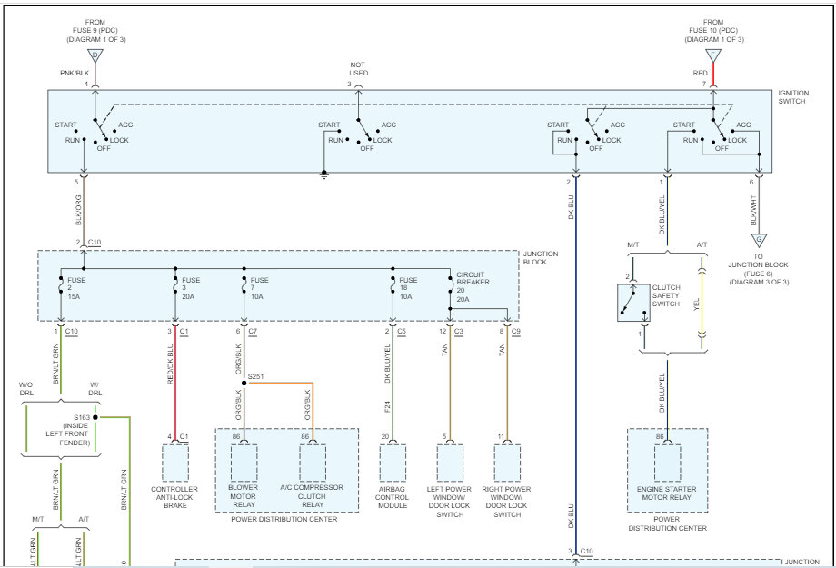

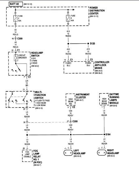

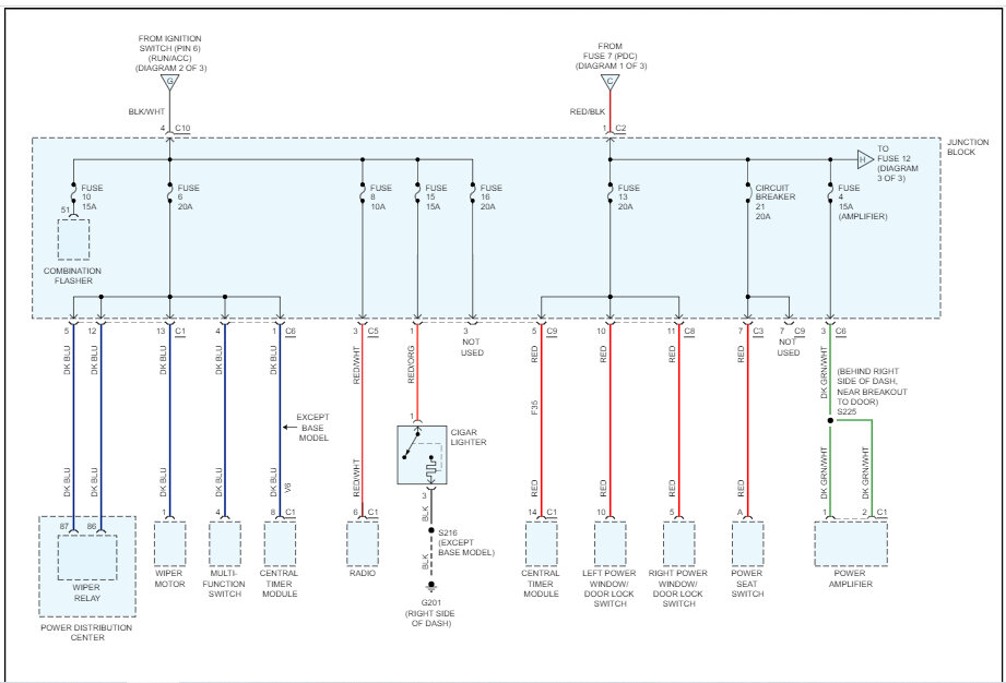

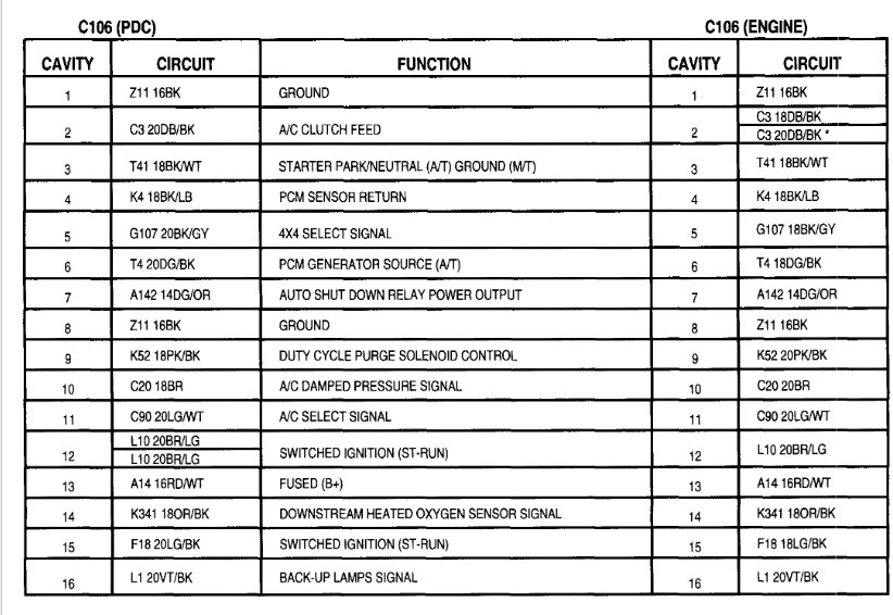

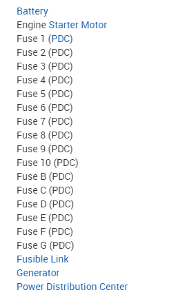

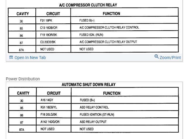

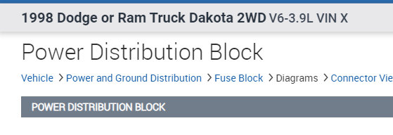

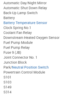

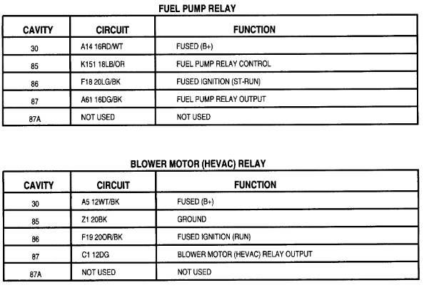

I've seen those. I'm need the wires that go in the power distribution center.
Jun 25, 2023 at 4:04 AM
  • 110,240 POSTS

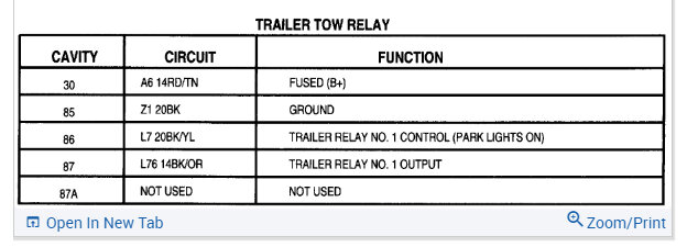

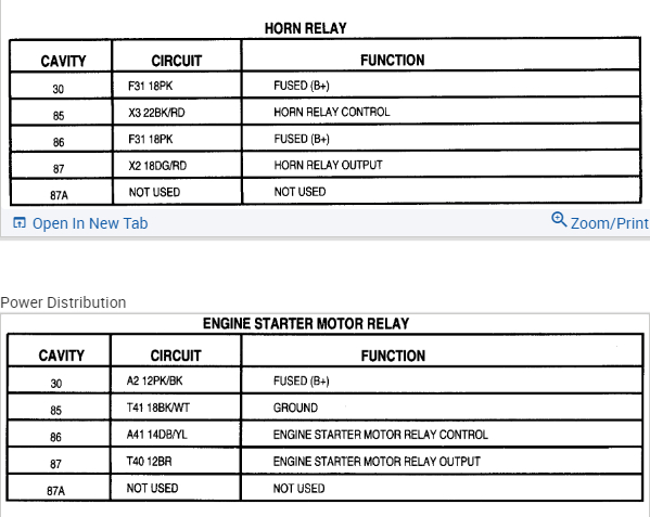

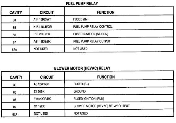

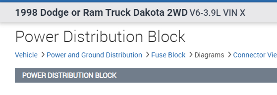

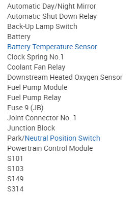

Okay, I attached everything OEM that I have for power distribution. I included the fuse box pin identification. Also, I included the schematics for the power distribution center.
I hope this helps. I don't know what else to offer at this point.
