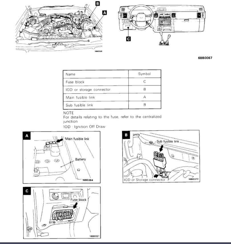

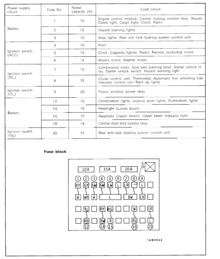

Need to locate the power boxes and what the name of the circuit it powers. Thank you
May 9, 2021 at 3:17 PM
  • 55,433 POSTS
There is a guide to help you find the fuse panel and the fuse identifications as well in the diagrams below.
