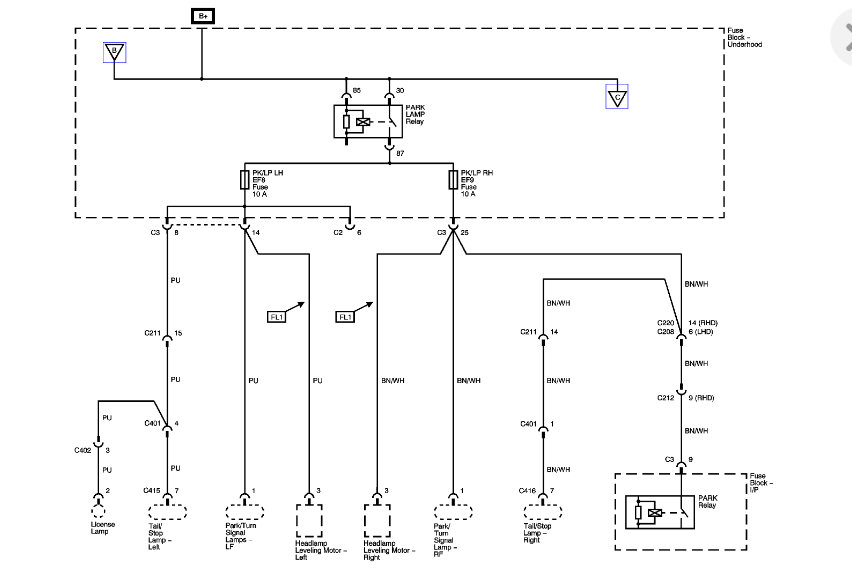

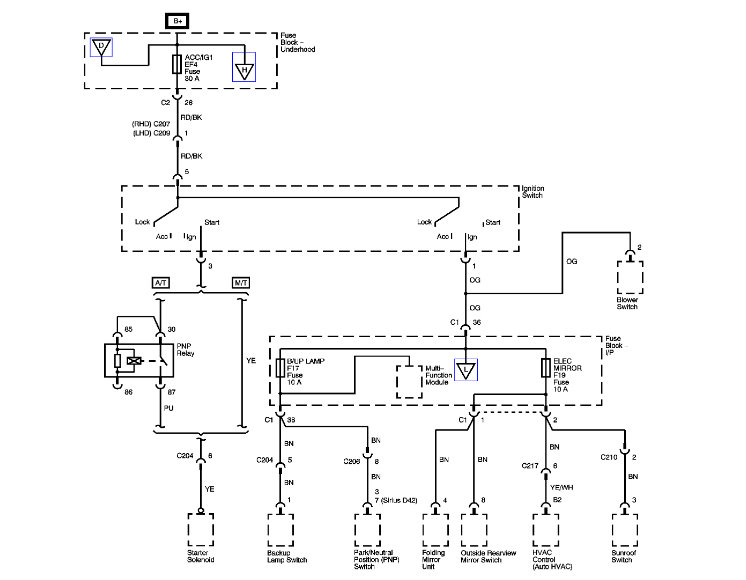

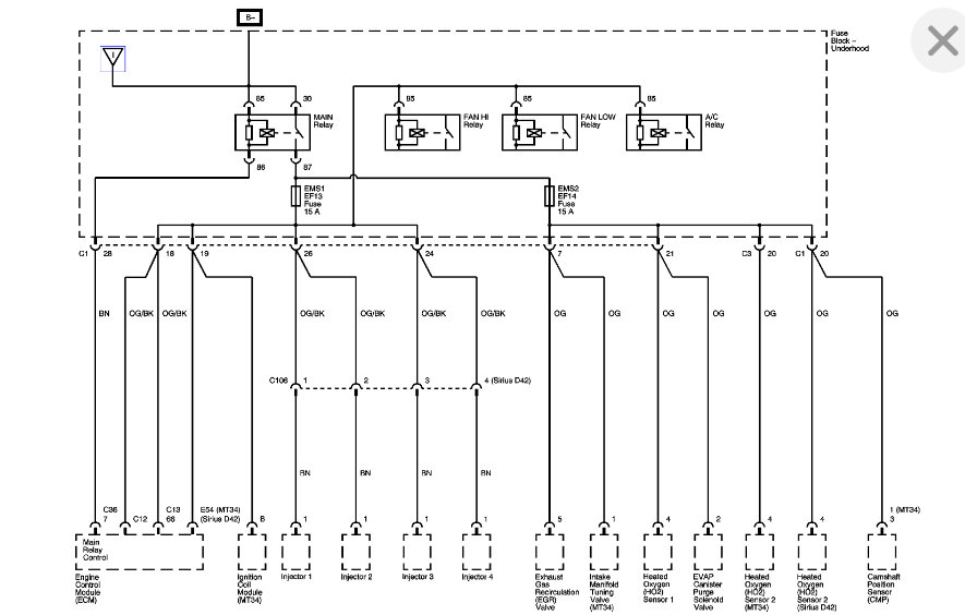

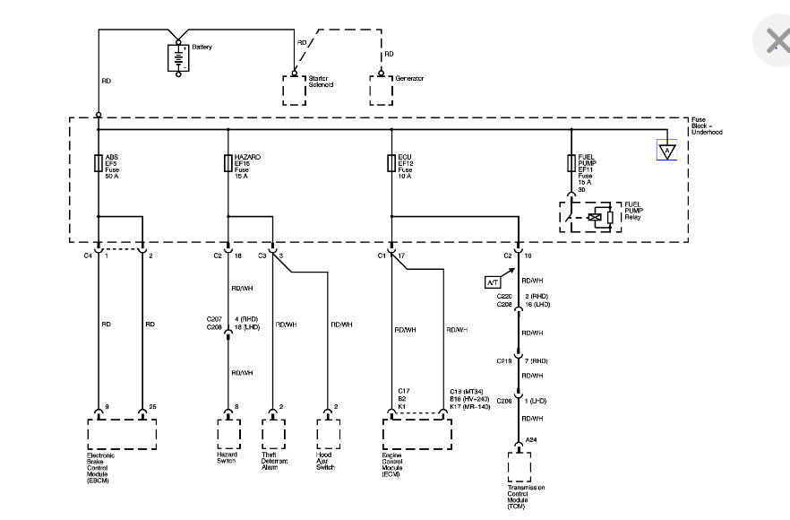

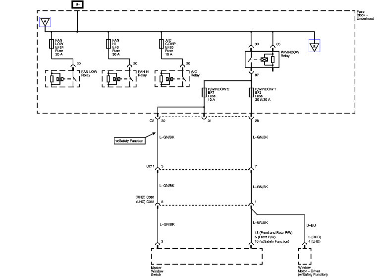

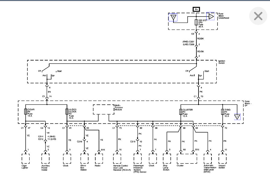

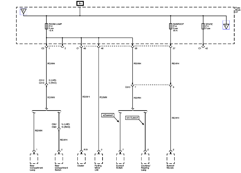

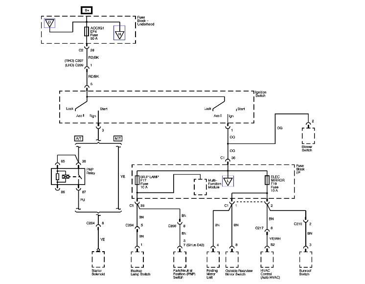

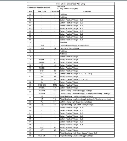

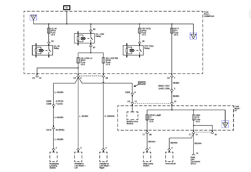

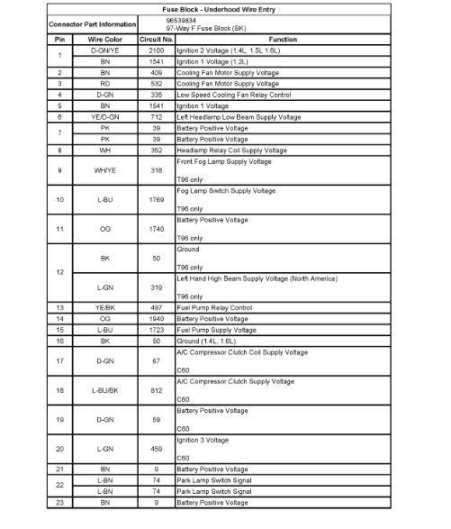

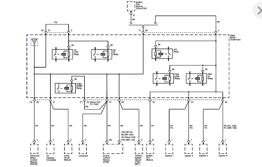

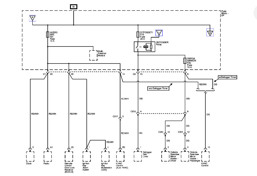

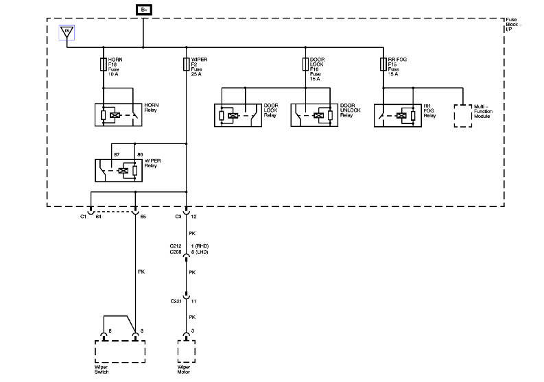

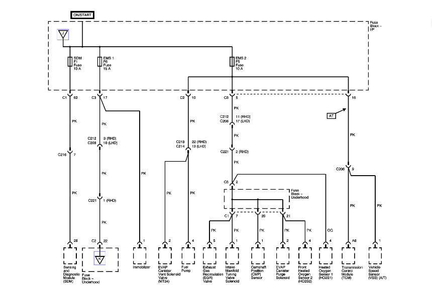

I need a wiring diagram, and the color of wires for my car specifically the wore connector box with puns and the pin diagram, so I know where and what is placed where in the connector itself. Please I have looked all over and cannot find one that matches mine.
Oct 20, 2018 at 3:00 AM
Good morning.
They do not give just a single diagram of just the fuse block. It comes in parts. I have attached them all at the bottom with connector numbers, pin numbers and colors.
Hope this helps.

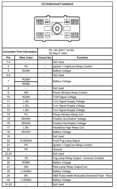

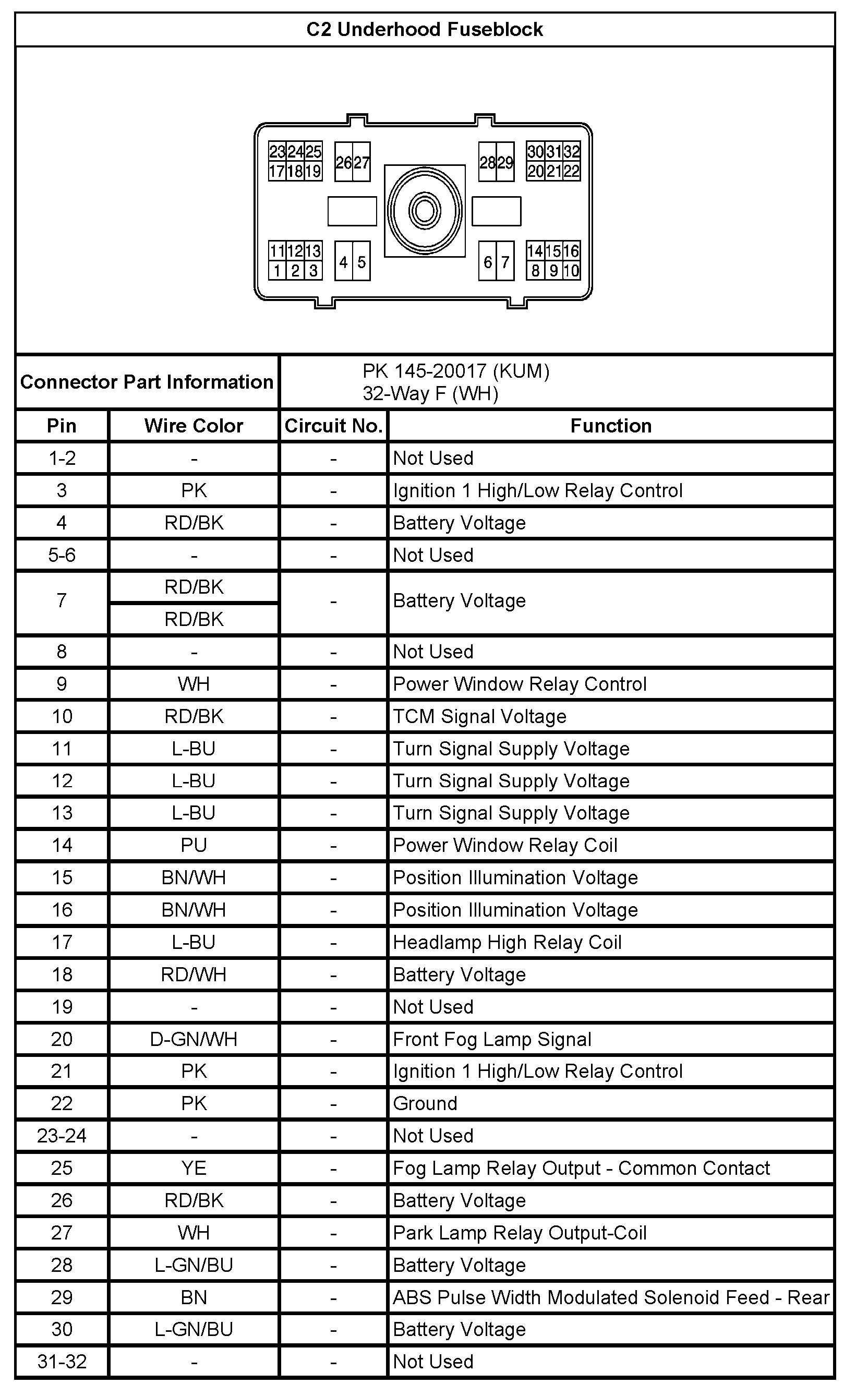

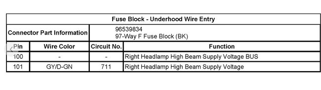

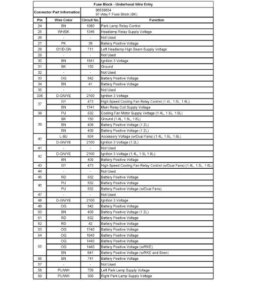

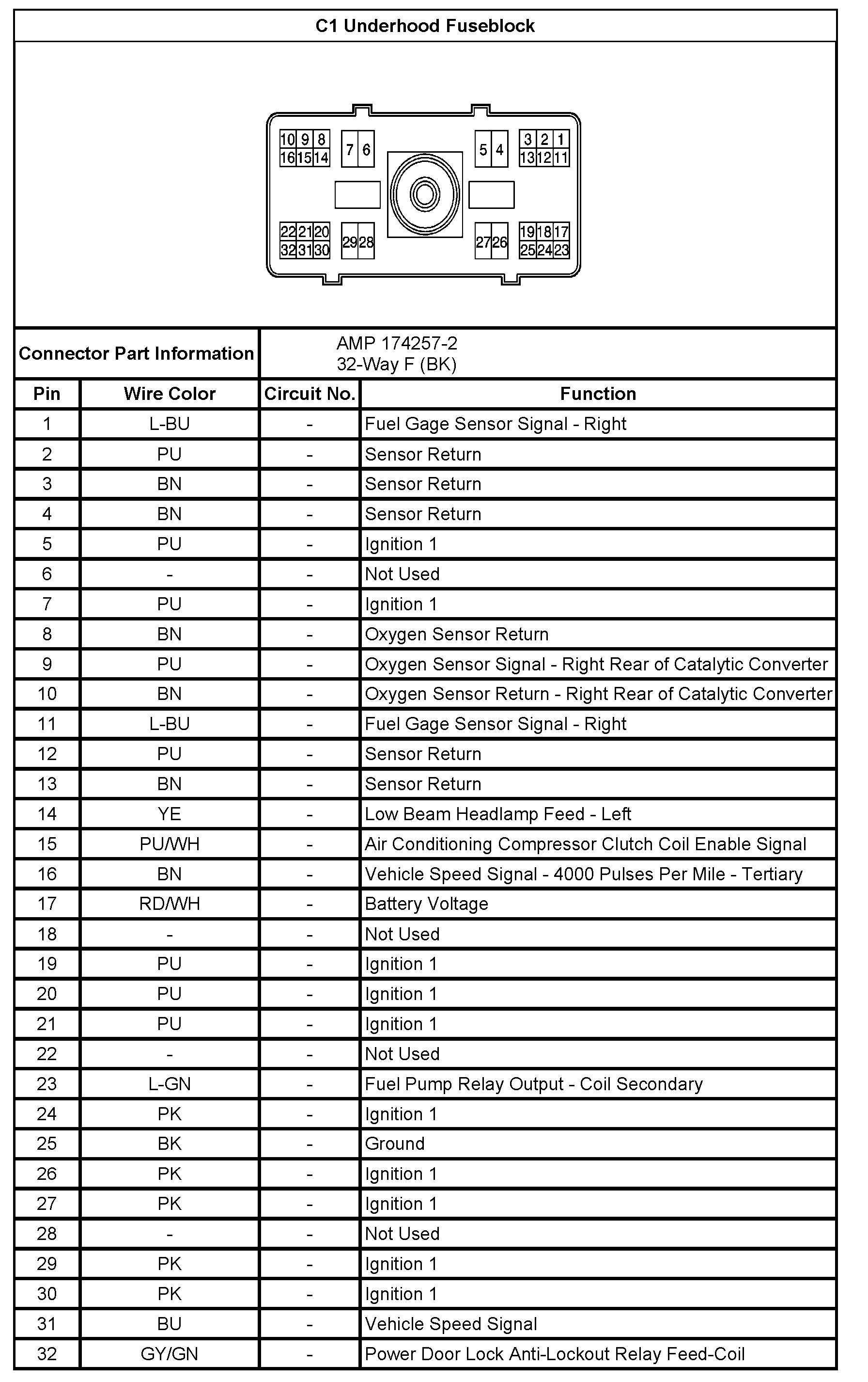

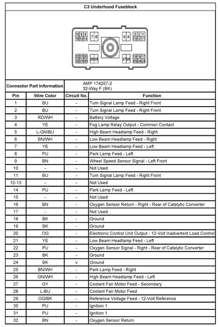

I need to see a picture of the back of a connector that goes in the back of the fuse panel under hood of 2007 Chevy Aveo how iti s wired like the pin placement in a certain connector. Please this would help so very much.
Oct 29, 2018 at 10:21 PM
Below are the connector diagrams you requested.
Oct 30, 2018 at 1:24 AM

I need a wiring diagram for the fuse box wire connector under-hood the 32 pin connector.
Oct 20, 2020 at 4:54 PM (Merged)
  • 110,194 POSTS
Hi and thanks for using 2CarPros.com
I have attached C1, C2, C3.
Let me know if this is what you are looking for.
