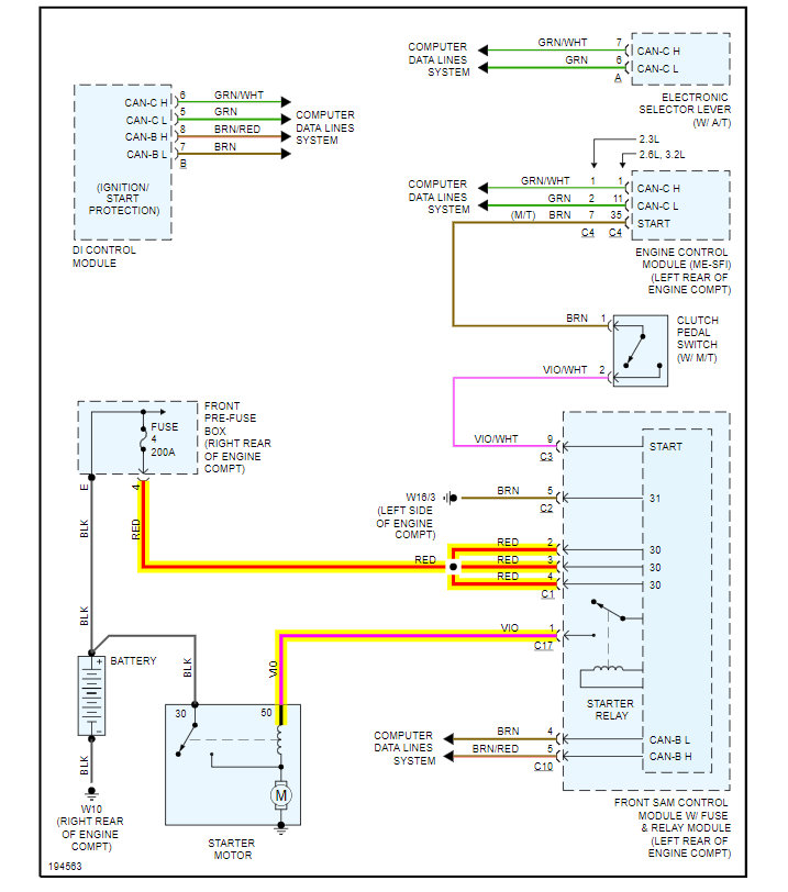

Tried to start the car it turned over slow, low battery charged the battery then tried to started it again. All the lights are good, the battery is good, check the starter relay it is good, but still nothing. not sure if it is a security thing. i do not think it is the starter because you don't even hear a click. how do i tell if the k40 is any good? that is the only other thing i can think of.
Aug 28, 2019 at 10:17 AM
Good afternoon,
I attached a wiring diagram for you for the starting system.
You need to test for voltage at the starter solenoid wire with the key in the start position.

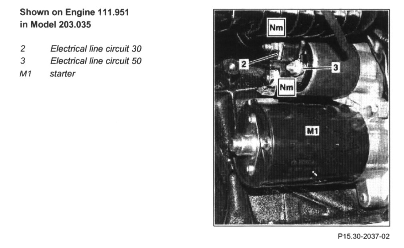

5 Disconnect electrical line circuit 30 (2)
Nut Of Connection Of Circuit 30 - 14 N.m
6 Disconnect electrical line circuit 50 (3)
Nut Of Connection Circuit 50 - 6 N.m

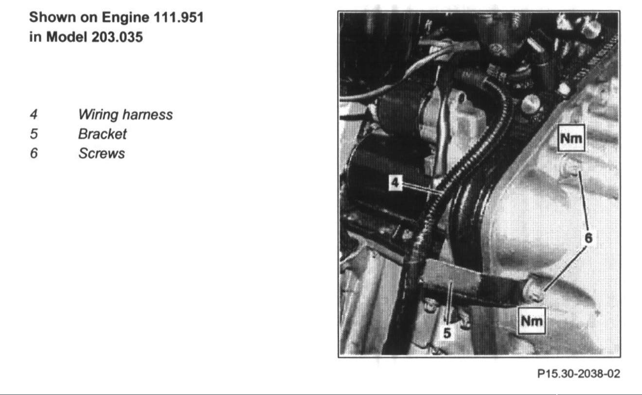

7 Unscrew screws (6)
Bolt Of Starter To Crankcase - 42 N.m
8 Place bracket (5) and wiring harness (4) to the side
9.1Take starter (M1) down and out
9.2Lead starter (M1) to front of vehicle and take out toward bottom
