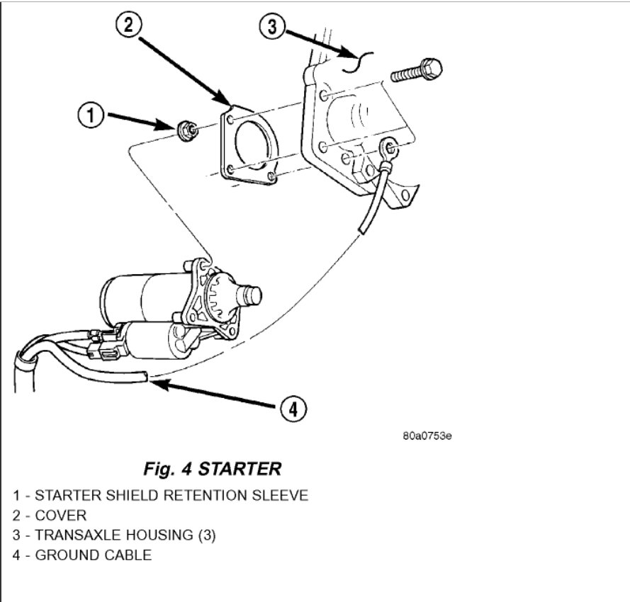

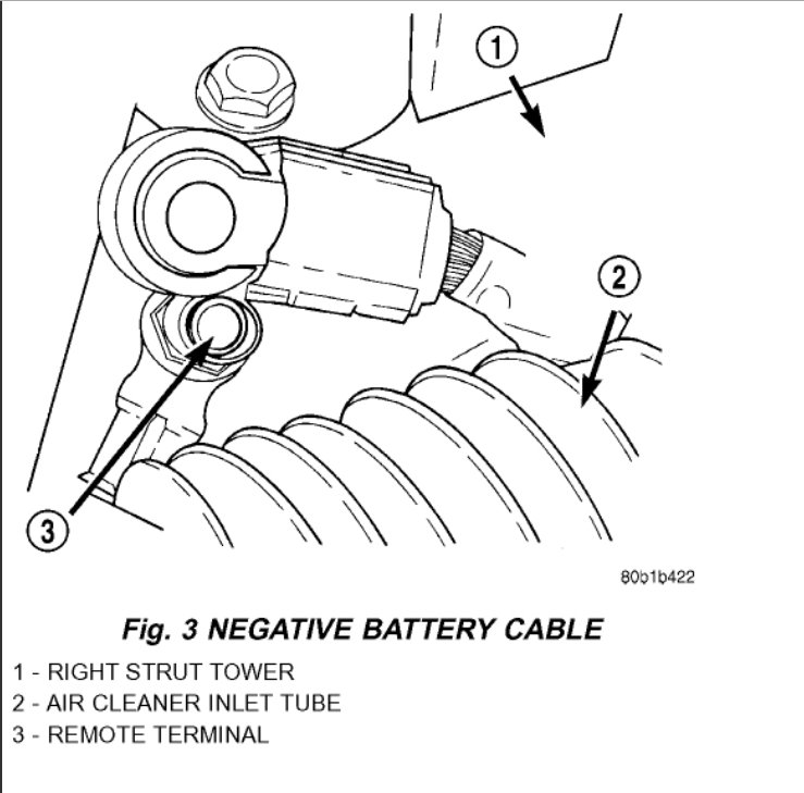

It sounds like you have a starter motor that is going out but to be sure we need to test the small trigger wire of the starter.
Here are some guides to help us see whats going on:
You might need to raise the car.
Here is a guide that shows how to do it toward the bottom of the guide:
If the starter trigger wire is getting power and the engine is not turning over the starter motor is bad and needs replacement.
Here is a guide that will give you an idea on what you are in for when doing the job:
Here are some diagrams (below) of what it will be like on your car.
Sep 28, 2017 at 3:44 AM
JESSICA M. RUMSEY
The entire issue was the starter wire had just vibrated out of position. Just pushed it back into place and have not had a problem since
