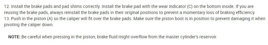

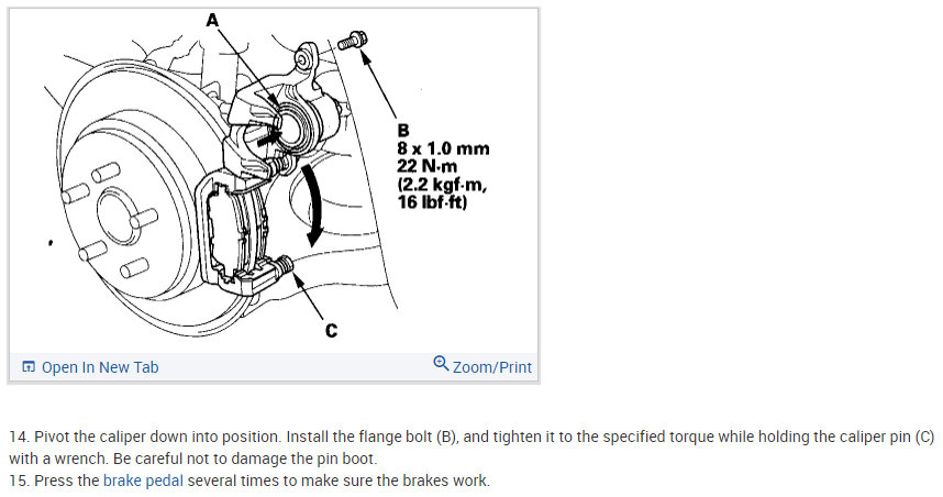

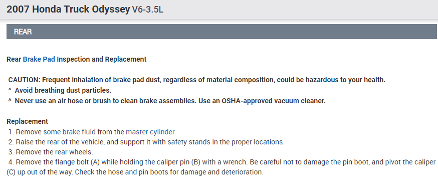

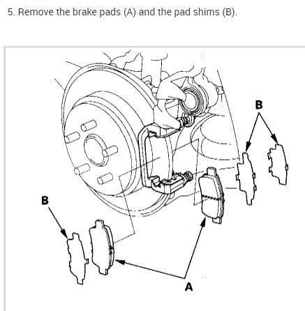

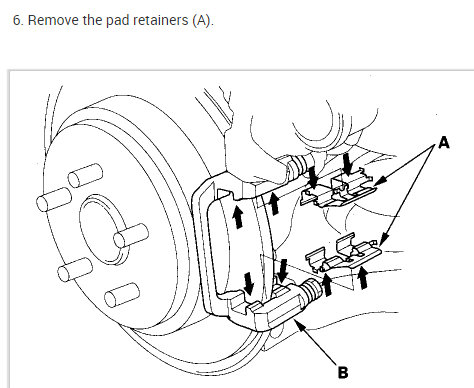

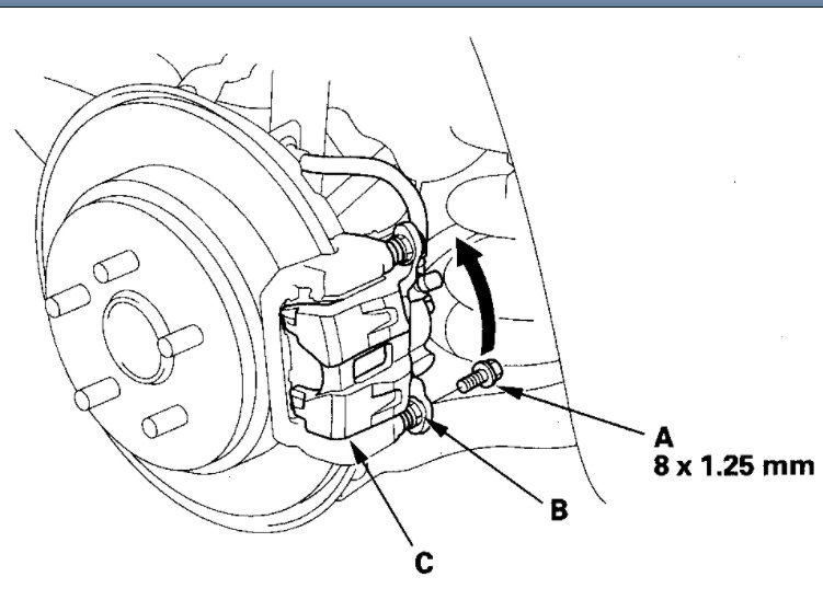

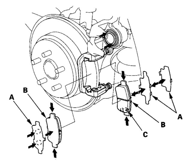

I got an estimate from a repair shop recommending replacement of master cylinder and brake booster but I just need rear brake can you help my please? I appreciate your help!
May 23, 2013 at 7:45 AM
DANNY L
  • 5,648 POSTS
Hello, I'm Danny.

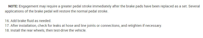

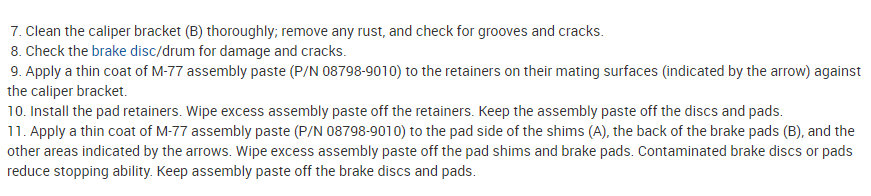

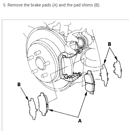

Here is a tutorial on how to remove and replace rear brake pads and rotors:
https://www.2carpros.com/articles/how-to-replace-rear-brake-pads-and-rotors
Here is a youtube video from our site on how to compress the rear caliper piston when performing a rear brake job:
https://youtu.be/j8YwfSKEzZo
I've attached picture steps below on how to replace the brake pads and rotors on your vehicle. Hope this helps and thanks for using 2CarPros.
