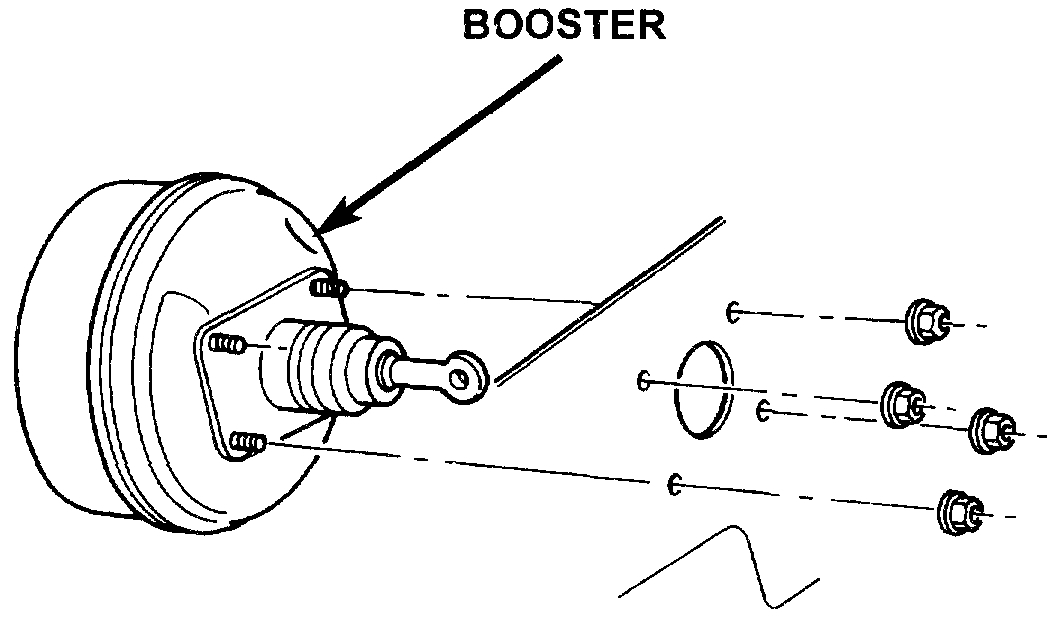

Any tips on how to get nut off of bolt behind brake pedal the one closest to the steering column? Other three came out fine, did not know if you had any ideas?
Oct 15, 2018 at 6:44 AM
  • 110,194 POSTS
First, here is a link that discusses in general how to replace one:
https://www.2carpros.com/articles/how-to-replace-a-brake-master-cylinder
Next, the nut that you are referring to is a pain due to access. The way I have done it in the past is using a 1/4" drive ratchet, an extension, and a swivel. Other than that, it will drive you crazy.

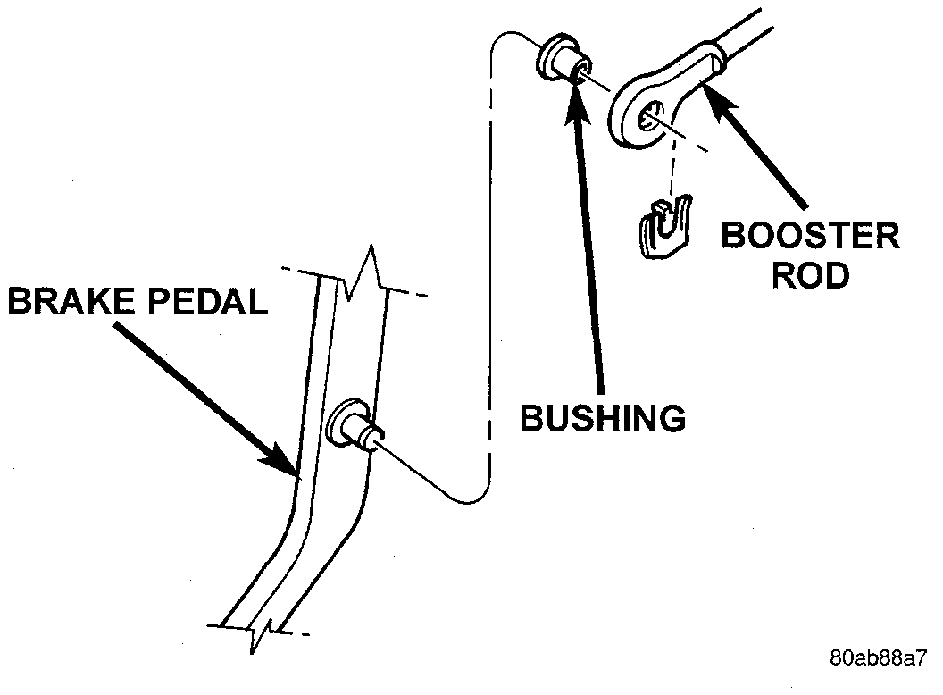

8. Remove retaining clip that secures booster push rod to brake pedal.
Booster Mounting
9. Remove nuts attaching booster to passenger compartment side of dash panel.
10. In engine compartment, slide booster studs out of dash panel, tilt booster upward, and remove booster from engine compartment.
11. Remove dash seal from booster.

1. Install dash seal on booster.
2. Align and position booster on dash panel.
3. In passenger compartment, install booster mounting nuts. Tighten nuts just enough to hold booster in place.
4. Slide booster push rod onto the brake pedal. Then secure push rod to pedal pin with retaining clip.
NOTE: Lubricate the pedal pin and bushing with Mopar multi-mileage grease before installation.
5. Tighten booster mounting nuts to 39 Nm (29 ft. lbs.).
