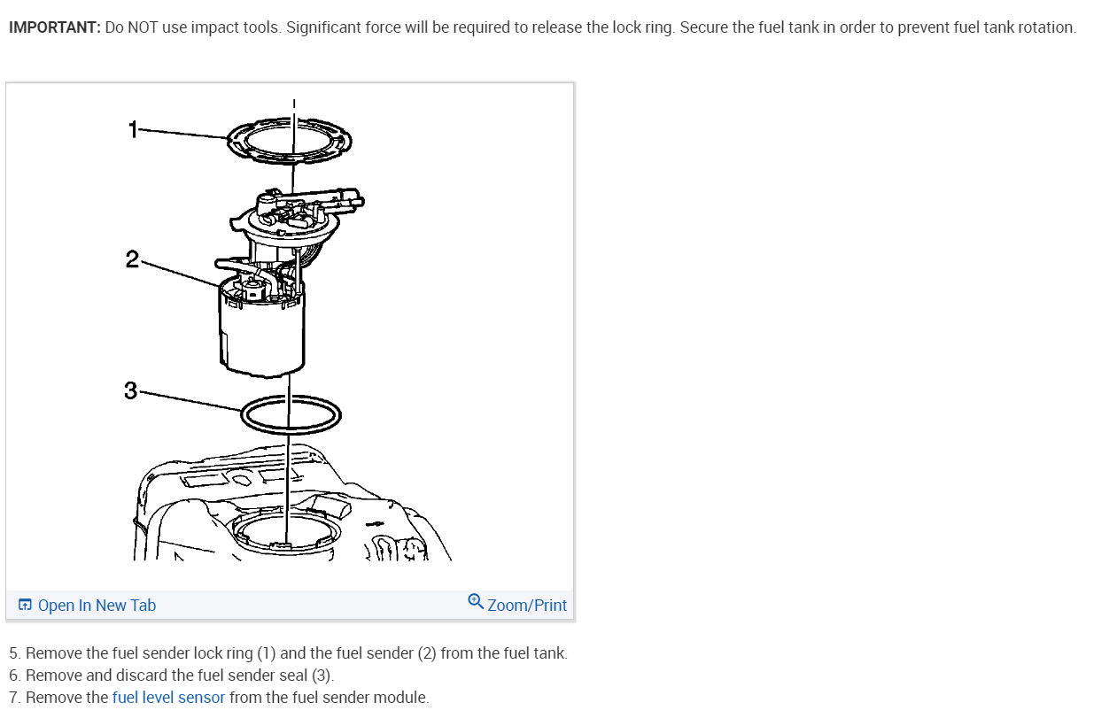

Loses power on hill and when I accelerate or when the transmission down shifts?
120,000 MILES • 3.4L • 6 CYL • AUTOMATIC
CINDYCLARK

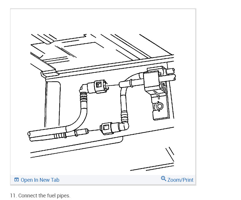

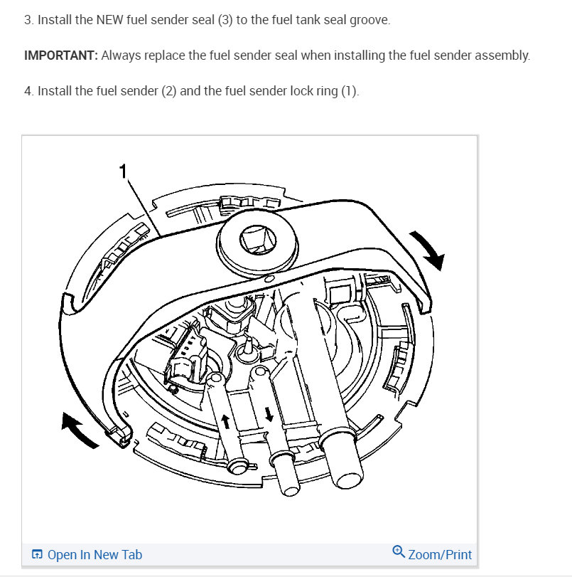

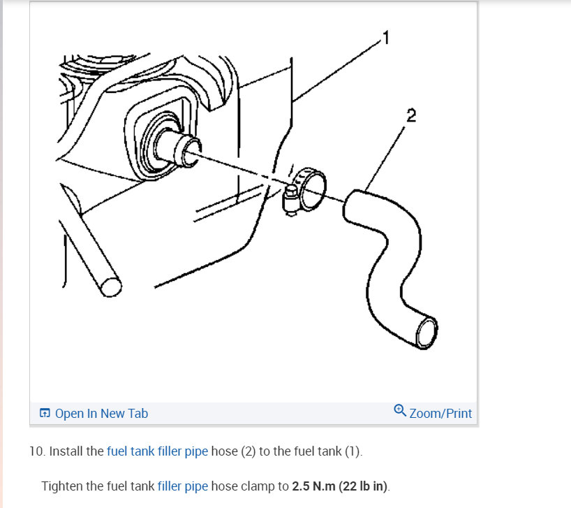

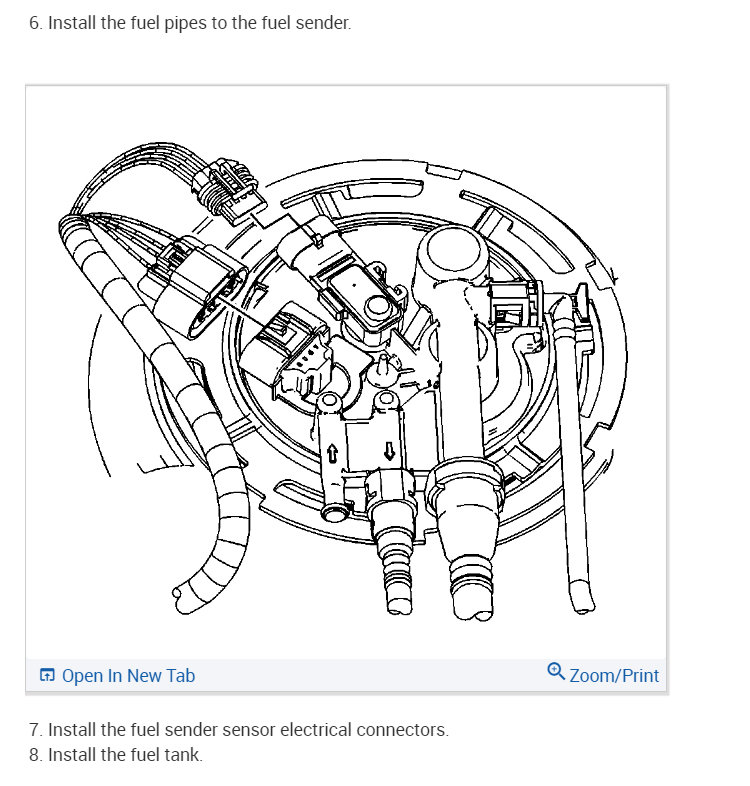

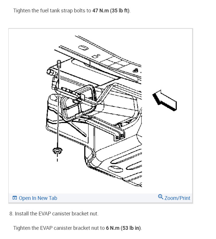

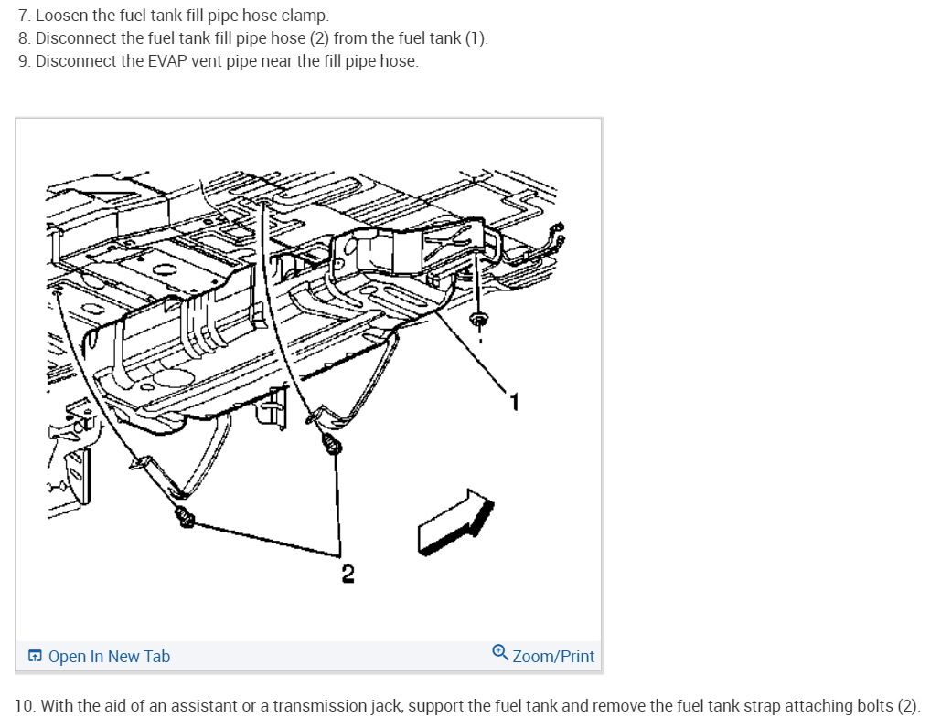

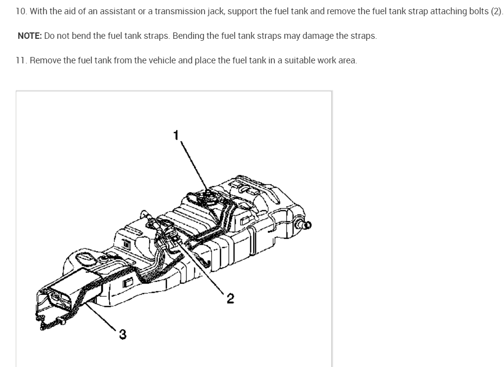

Loses power on hill and when i accelerate or its shifts down and the RPMs go past 2.5 have no power, and I can hear the engine bog.
Jul 13, 2022 at 8:53 PM
  • 55,627 POSTS

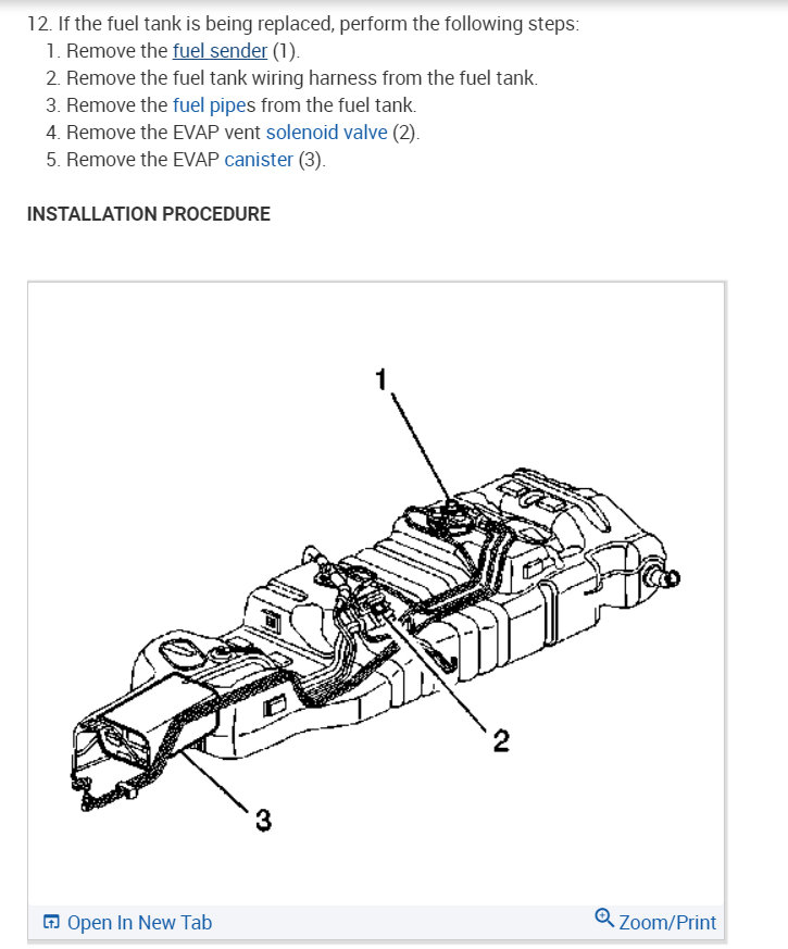

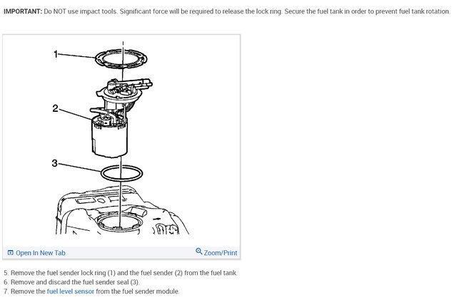

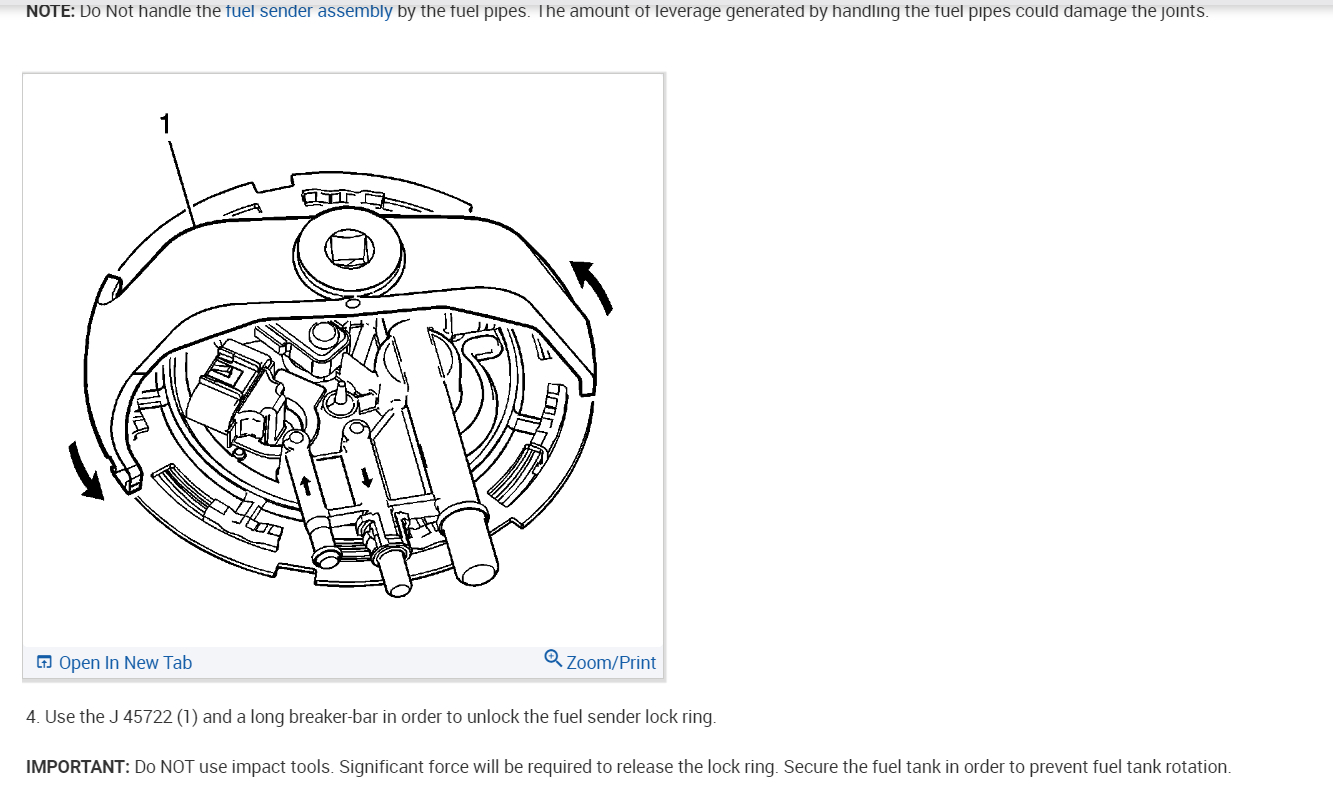

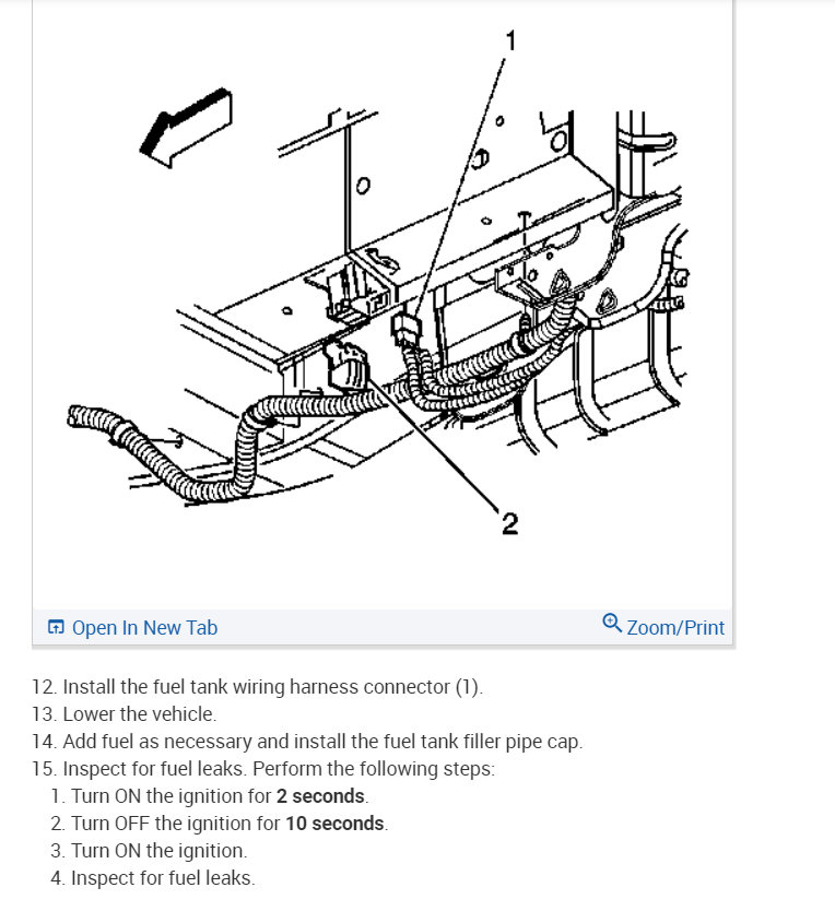

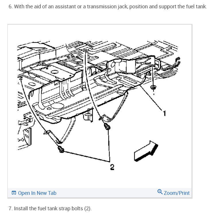

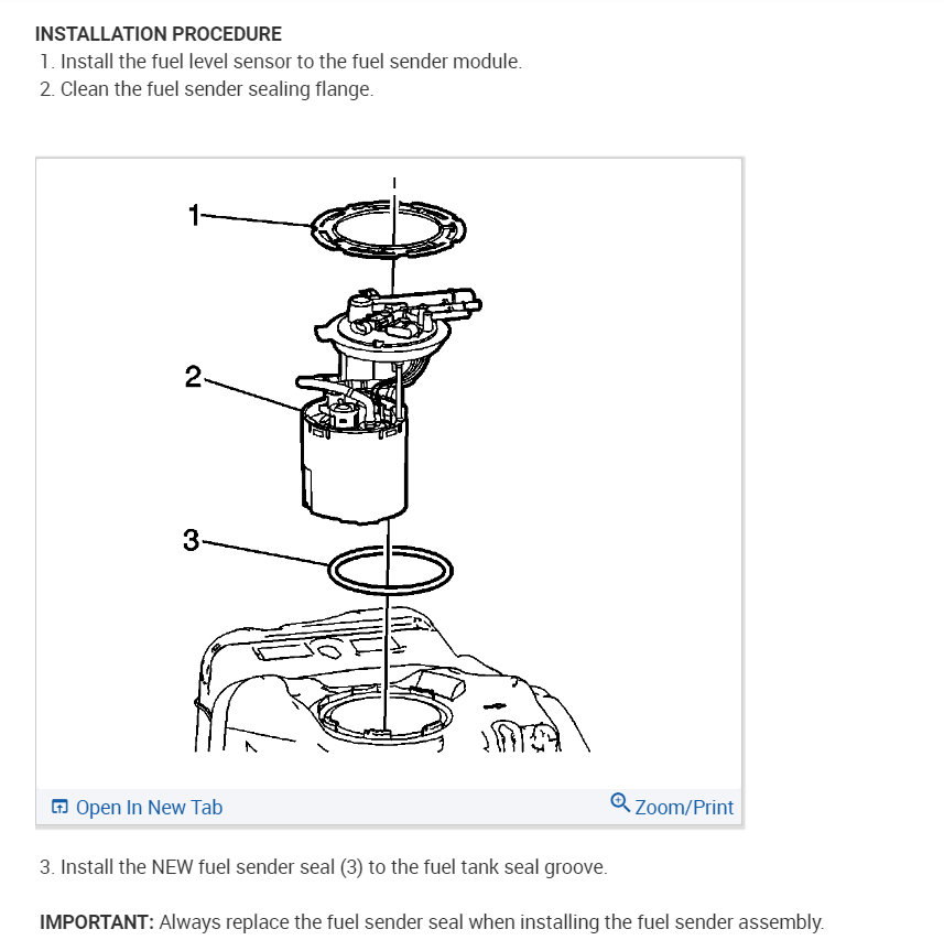

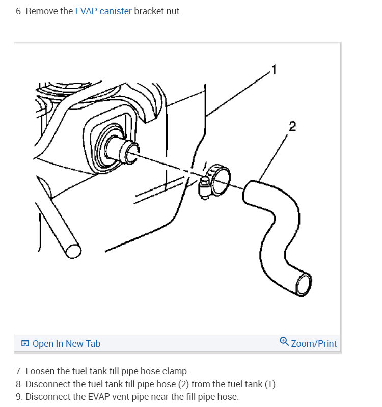

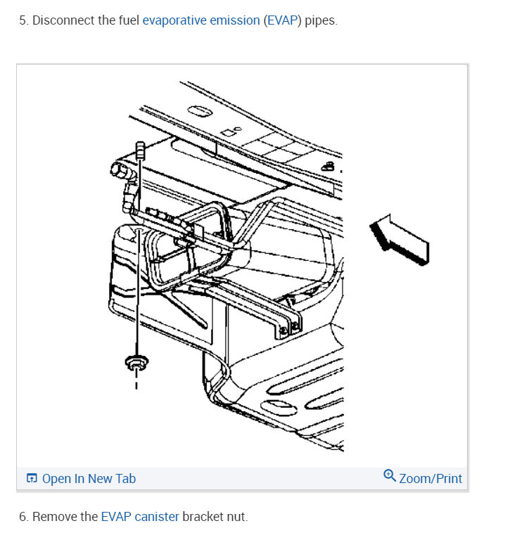

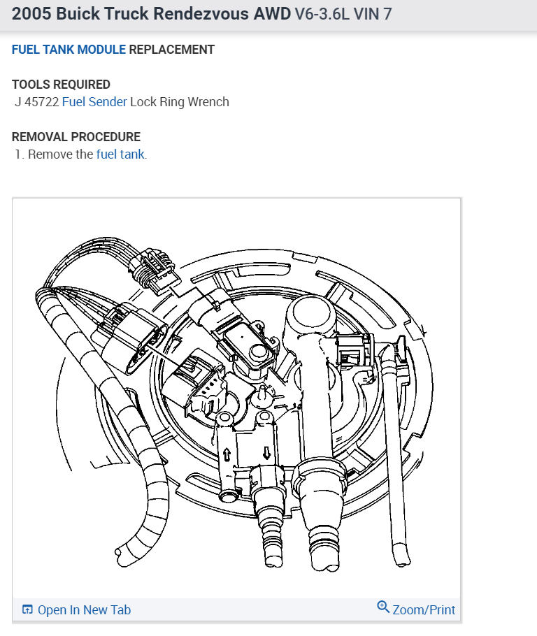

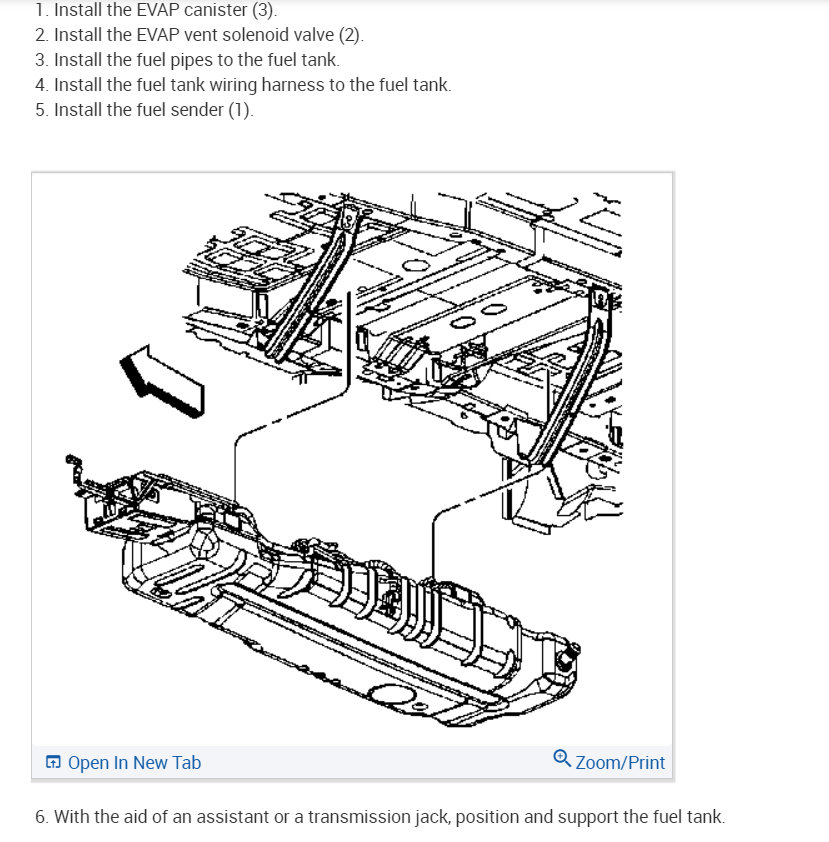

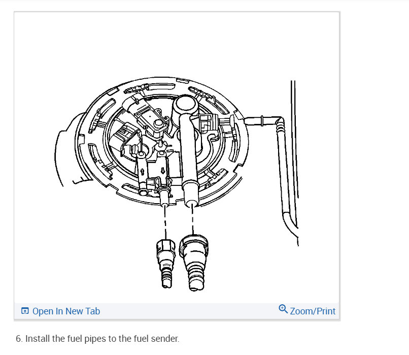

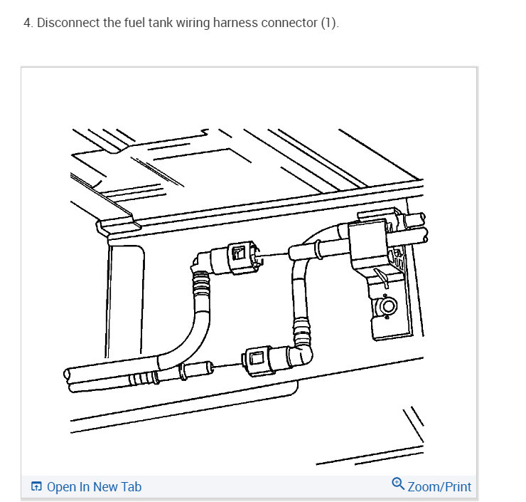

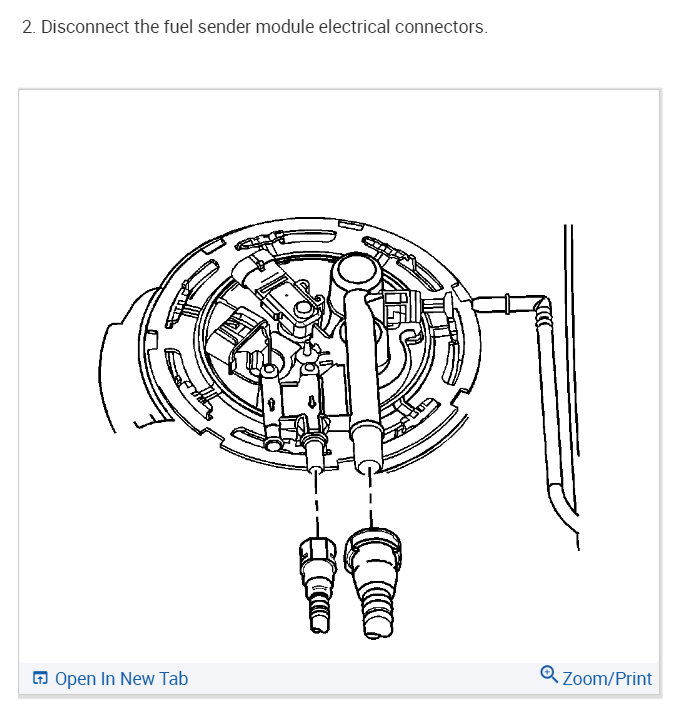

This can be one of two things, either the fuel pump is getting weak, or the catalytic converter is clogged, but we should run the codes to see what comes up this guide can help:
Here is a guide to help you check the fuel pressure and I have left instructions in the diagrams below on how to change out the fuel pump:
