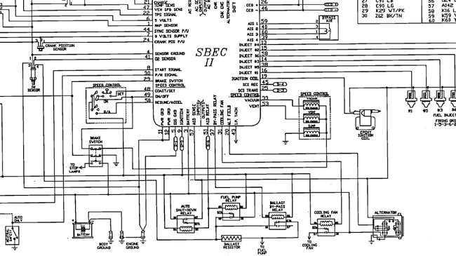

All the power is good, but is my ASD relay supposed to have two different volts to it?
+1
Saturday, July 21st, 2018 AT 3:22 PM
  • 52,797 POSTS
That is for the engine controls, yes. But that does not explain why you do not have dash or anything else. You stated it is completely out. The ASD relay does not control everything.

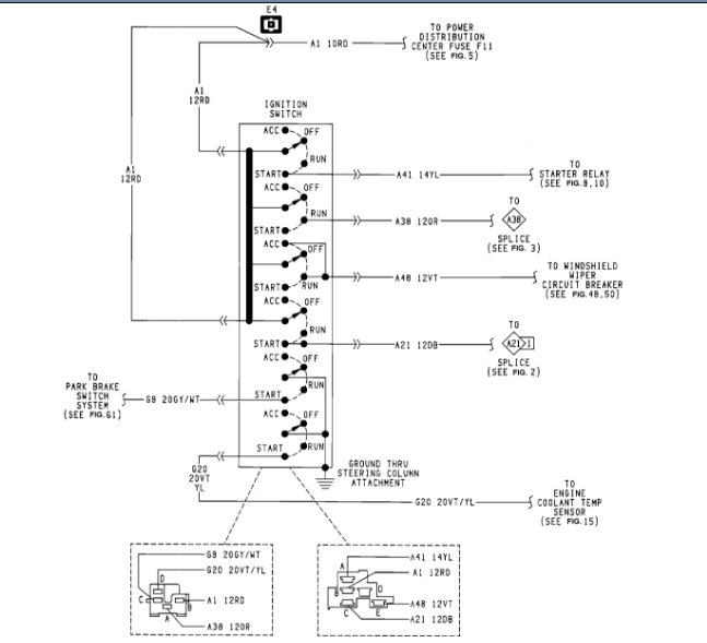

At this point, I would suspect an ignition switch. You need to check for power to the switch and see if there is any coming out of it.

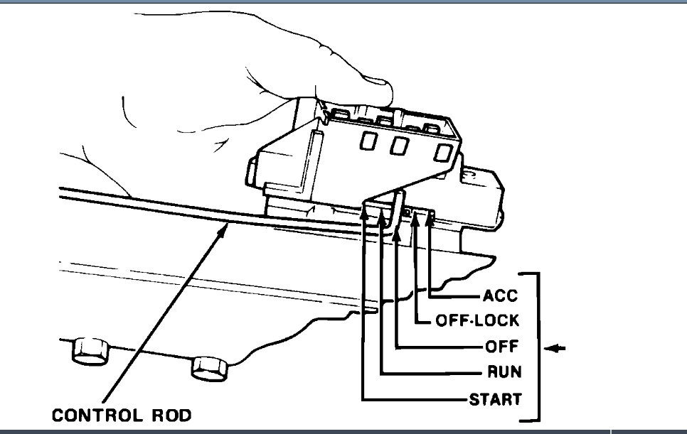

Is that the black box under the dash?
Saturday, July 21st, 2018 AT 3:42 PM
  • 52,797 POSTS
It is at the bottom of the column. Picture and pin out attached.
+2

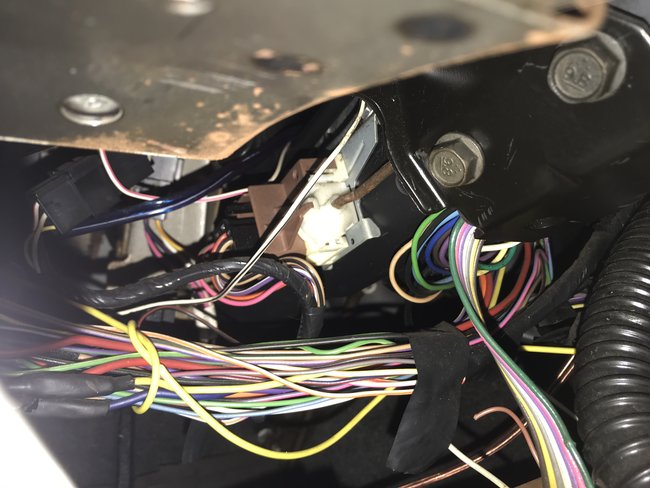

Would this be it?
Saturday, July 21st, 2018 AT 3:53 PM
  • 52,797 POSTS
That piece is the high beam switch. That is bolted to the ignition switch. If you remove the high beam switch you will see the ignition switch.

So I have one current to the plug the parking switch but nothing else.
Saturday, July 21st, 2018 AT 4:12 PM
  • 52,797 POSTS
Plug? What plug? Parking switch?
I thought we were talking about the ignition switch?

We are, the plug on the ignition switch according to the diagram is the parking switch that the only power is that.

That picture shows the high beam switch and the ignition switch.

Oh okay, so how do I measure for voltage on the ignition switch?
Saturday, July 21st, 2018 AT 5:08 PM
  • 52,797 POSTS
You use a voltmeter. I sent you the diagram for the pins and color of the wires. Verify powers to the switch and then check for voltage coming out of the switch with the key on.
Saturday, July 21st, 2018 AT 5:15 PM
TYLER CORRIHER
  • 11 POSTS
There was no power coming out. Thank you for your time.
