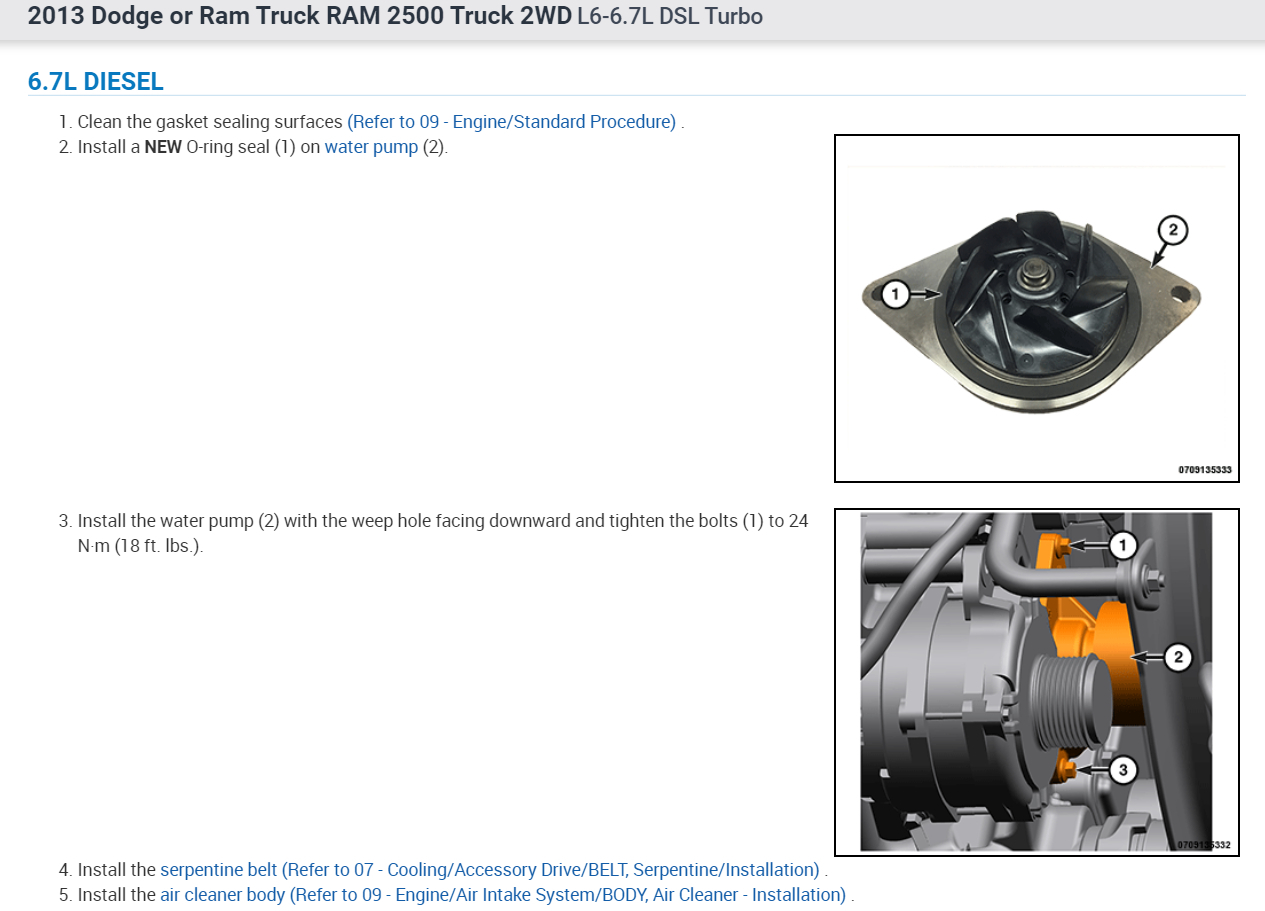

It started pouring coolant from drivers' side by the intercooler.
Jan 3, 2023 at 11:30 PM
  • 54,832 POSTS

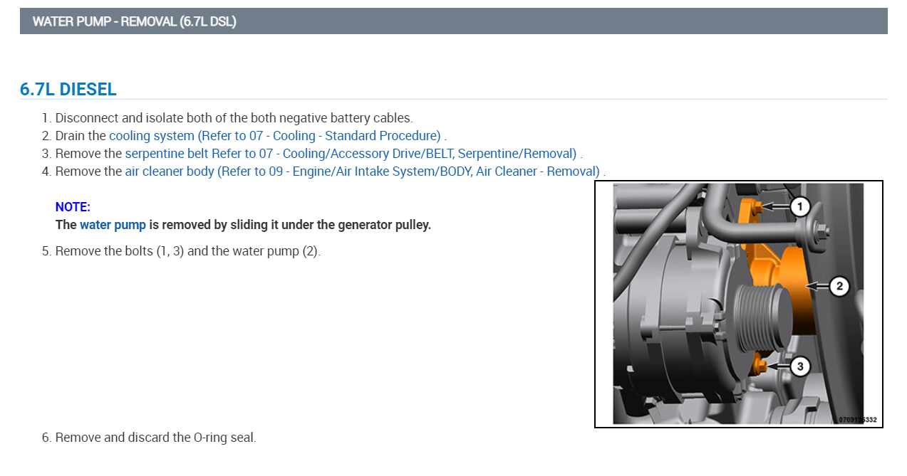

It sounds like it could be the water pump, but to be sure you need to get under the truck with a flashlight to confirm. this guide can help and I have left instructions on how to change the pump out in case you need it in the images below.
https://www.2carpros.com/articles/car-is-leaking-coolant
Check out the images (below). Let us know what happens and please upload pictures or videos of the problem.
