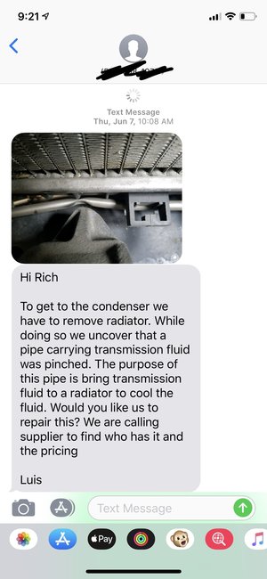

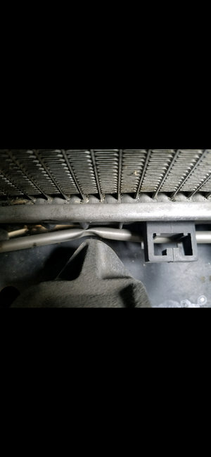

During AC work he said he “found” a pinched pipe that carries transmission fluid to be cooled and asked if I wanted to replace it
I told him to leave it be if it was working as before and I would take care of it later. When I picked it up I was told that they fixed it themselves! It was admittedly shady but it was hot and my AC was fixed and working. Despite sirens going off I did not pay it mind because quite frankly it was hot this summer.

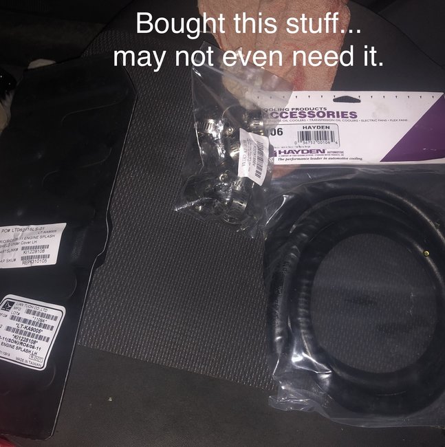

I ordered some stuff I thought I might need. Some transmission cooling hose, some splash shields (I do not think mine are there anymore) and some clamps. I was pretty sure I was in over my head but wanted to at least try. I might not even need any of the stuff.

From what I can deduce the transmission cooling line used to be metal, but is now rubber after whatever happened during the AC repair.

Yep, you are going to need it. Cut the line on either side of the crimp and double flare both ends before installing the hose. This must be done or it will hurt the transmission.
