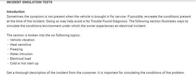

I had an issue of the car stalling and sometimes shutting off on me while driving
And also sometimes the Needle of the engine temperature is bouncing up and down giving unreal values.
I have an issue with three sensor, Ambient temperature sensor, Coolant temperature Sensor, crankshaft sensor.
I connected the star diagnostics tool and i had the stored faults read
1-crankshaft position sensor has a malfunction signal is not present.
2-Engine coolant temperature sensor has a sporadic value.
3-Ambient temperature sensor has a short to ground.
I replaced the sensors but the issue isn’t fixed. It seems like the sensors has an intermittent issue where they disconnect and connect again.
I am afraid it is the ground circuit of the ECM.
And i needed some advice on how to track this issue.
Note: I am an electromechanical engineer freshly graduated.
Jul 29, 2019 at 10:20 PM
SCGRANTURISMO
  • 4,897 POSTS

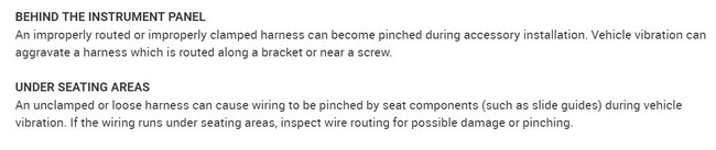

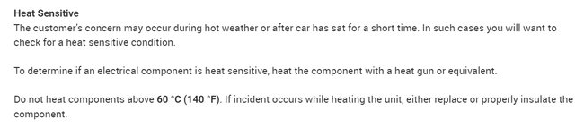

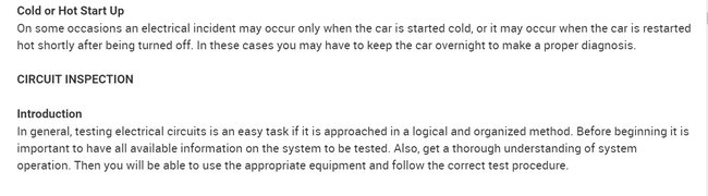

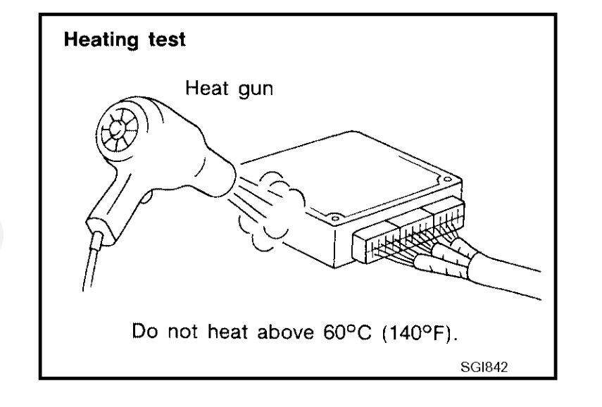

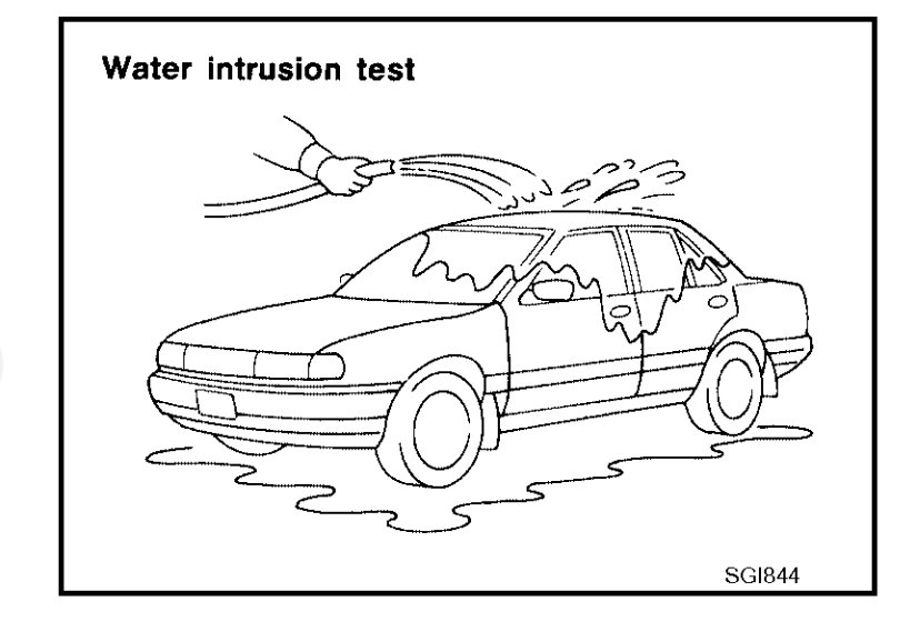

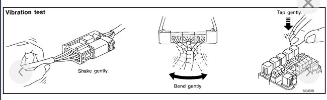

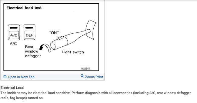

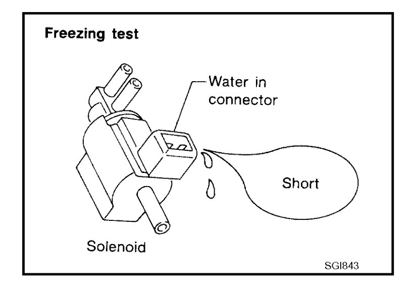

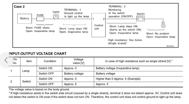

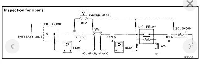

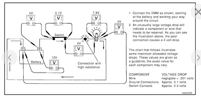

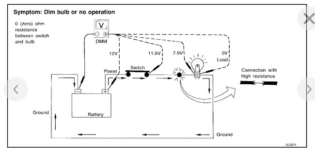

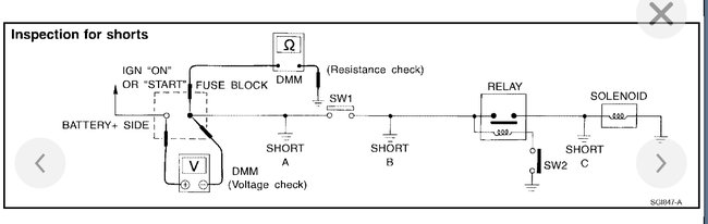

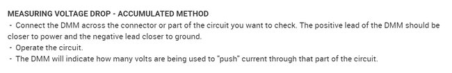

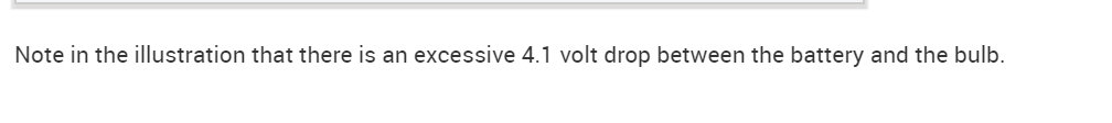

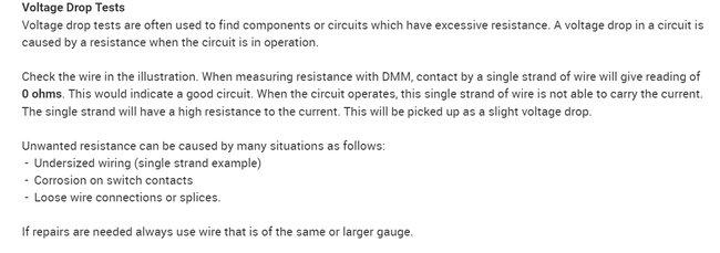

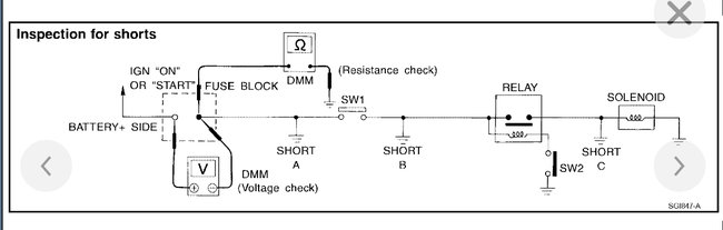

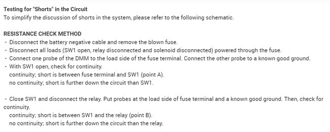

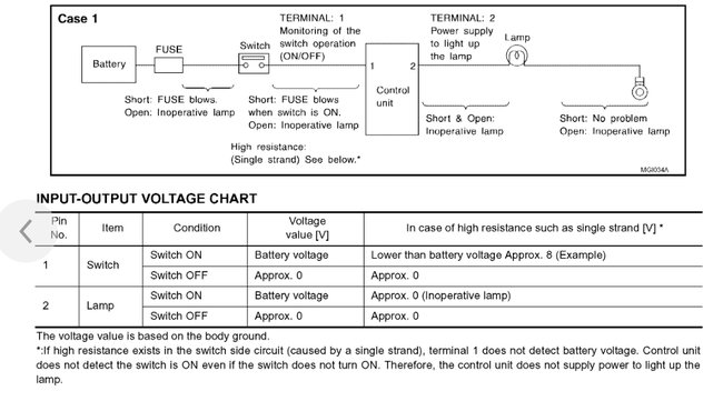

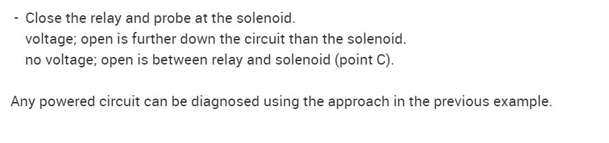

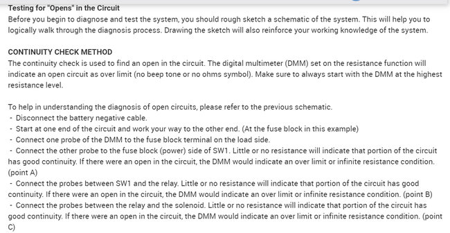

The information that you requested is in the diagrams down below. 1) check this circuit for an open 2) check this circuit for a loose wire or connector for pins that are bent, damaged, or have corrosion. Dielectric grease on connectors will also help. 3) Find the short to ground and replace fuse for this circuit. Unfortunately we do not have a listing for Mercedes Benz E200 in either one of our reference materials, so I will not be able to give you wiring diagrams for these circuits.Please go through the guides in the diagrams down below and get back to us with what you are able to find out.
Thanks,
Alex
